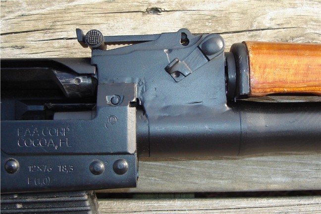

Mudsock 0 Posted March 27, 2006 Report Share Posted March 27, 2006 How is the RSB attached? Quote Link to post Share on other sites
dinzag 31 Posted March 27, 2006 Author Report Share Posted March 27, 2006 Thanks all! Glad you like! I have some more work to do, but at least it goes bang. Went to Craig's dad's yesterday to shoot some clay pigeons. I ended up using the 410 due to the lack of a FSB on the 12. That's in the works. I still blew up some milk jugs and put another 50 rounds through it. With the porting it will cycle the 3 dram stuff on #1 without the buffer. Mudsock - the RSB is mig welded to the trunnion and barrel. I will get better pics in the sunlight. The welds were ground flat & painted. I've done the same with all 3 shotguns. I suppose someone could machine up a barrel band to weld to the RSB and pin it on, but I don't ever plan on removing the barrel from the trunnion. The key thing to do for the RSB is measuring where the dust cover locks in to the top of the barrel, and duplicating that with the new RSB. The AKS-20 & ASK-410 RSB's sat in there good widthwise, only needing a shim under it for proper height, but the AKS-12 needed shims on each side of the AKM RSB as well. Once cut to fit properly, clamp it down very tight where the RSB meets the trunnion. Tack weld 4 corners quickly & lightly to avoid draw, then test for function. If good, fill in all welds, grind smooth & paint. It all seems like a lot of work, but with the proper tools it goes pretty quickly. I am not a master welder so my welds need some more clean-up time. I logged about 6 to 8 hours doing the HG conversion through painting. I haven't touched the furniture yet as my belt sander is down. Quote Link to post Share on other sites

LEO 4 Posted March 29, 2006 Report Share Posted March 29, 2006 (edited) Dinzag: Could you show some closeups of the forend retainer on the gun. Ours is bored slipped over the barrel with a bushing to hold it to the rear. I wanted to do it like yours but got lazy, now I have to . Very nice. Oh yea what size is the screw? LEO Edited March 29, 2006 by LEO Quote Link to post Share on other sites

dinzag 31 Posted March 30, 2006 Author Report Share Posted March 30, 2006 (edited) O.K. here's a pic of the FSB parts... LEO, here'a a couple pics of lower retainer... edited for drunken posting last night Edited March 30, 2006 by dinzag Quote Link to post Share on other sites

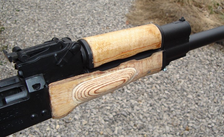

dinzag 31 Posted April 2, 2006 Author Report Share Posted April 2, 2006 Cobra, you are correct. I should have said - wish we could import them this way... Got wood? Yup!!! I removed the phallic VPG from the stock Romy lower HG, Split in two, and epoxied to the HG to add bulges. Coming along nicely. Will have stain on tomorrow. Also Mr. Pistonring8 will be bead-blasting all my Saiga carriers and Tony R. will be turning up a couple AK-74 brakes for my big dogs. Thanks to everyone for helping me fund those through quick sales of my parts! I have BRG3's PG on now - matches the new lower HG nicely!!! Quote Link to post Share on other sites

dinzag 31 Posted April 5, 2006 Author Report Share Posted April 5, 2006 (edited) Here's how the furniture turned out. That's BRG3's pistol grip on there. It's orange - the pics don't do it justice! The PG was really light colored so I stained it black, sanded down, then stained orange with the rest of the parts. Edited April 5, 2006 by dinzag Quote Link to post Share on other sites

dinzag 31 Posted April 6, 2006 Author Report Share Posted April 6, 2006 Thanks guys! I think refinishing the wood takes longer than anything else! After staining I rubbed in 4 coats of oil then started to poly. On this one I'm using Minwax Wipe-On Satin Poly. It has 6 coats on now. It's nice because you have no runs or brush marks to worry about and it dries in 2 hours. After the first couple coats I sand with 220, then 600 for the last few. I would say you are correct, I think the small amount of added weight does seem to reduce recoil or change the felt recoil. We noticed that with my S-20 -vs- Craig's; mine being wood & his was synthetic...all else equal. However, my wood S-20 had more recoil -vs- the S-12 (when synthetic). The S-20 was ported and the S-12 wasn't, both converted. The S-12 is heavier and the barrel is 4" longer, the ammo & mags are heavier, plus the S-12 had a buffer. Too many variables! Quote Link to post Share on other sites
