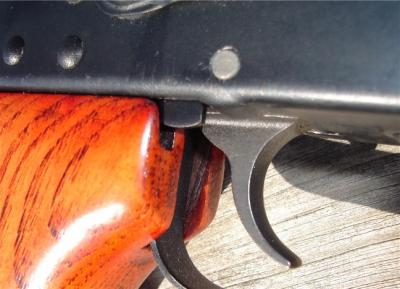

dinzag 31 Posted April 9, 2006 Author Report Share Posted April 9, 2006 (edited) Here's a couple more mods. Added a Jeric BHO "A" kit and Tactical Mag Release. Each install took about an hour or so including paint. I really like the feel of the release. BHO Install ; Tac Release Install Also added a flip-up sight off a Yugo kit I got from TheGunHustler. I am using the flip-up front sight from that as well. Edited April 10, 2006 by dinzag Quote Link to post Share on other sites
nycGUNguy 61 Posted April 9, 2006 Report Share Posted April 9, 2006 Wow! I know why I am a newbie and you are a "GOD". A thing of beauty . I can only hope to hone my skills to your level. Quote Link to post Share on other sites
Jeric 0 Posted April 10, 2006 Report Share Posted April 10, 2006 That tac releae looks awesome Dinzag! I think you will be really pleased with it. It really speeds things up with mag changes. Thanks for posting the pics! Jeric Quote Link to post Share on other sites

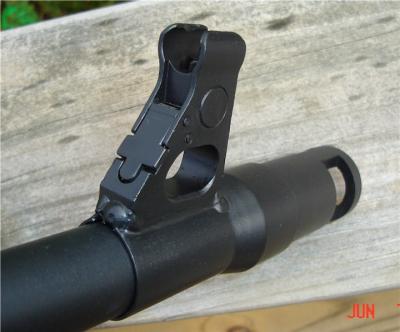

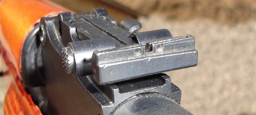

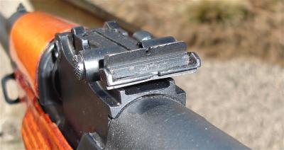

dinzag 31 Posted May 25, 2006 Author Report Share Posted May 25, 2006 Here's some updated pics of some more mods... I cut the barrel back to 19" from 22.88". I also finally attached the AK-74 brake Tony Rumore made for me. He did a great job on it!! I had him leave 1.5" on the back so I could weld the front sight tower to it. I couldn't use the factory clamp-on front sights due to the added height of the rear sight. This will be attached with green loctite once I get it back from getting Rem-Chokes installed. Right now it's as welded and needs paint. I got the Yugo flip-up front & rear sights from TheGunHustler. Thanks again! I need to paint in the dots with something radioactive so they glow in the dark. Lastly, pistonring8 bead-blasted my carrier - I love it!!! He does awesome work! Quote Link to post Share on other sites

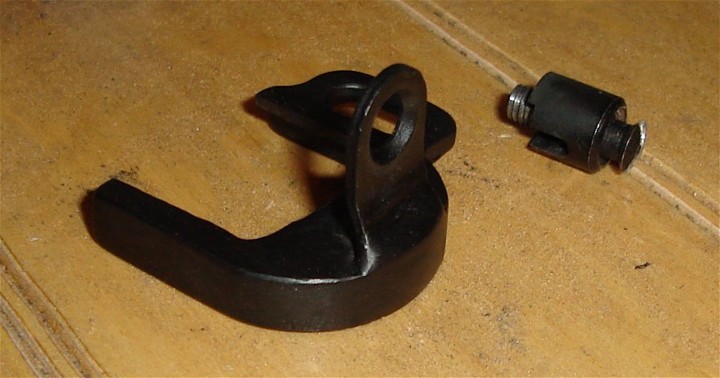

dinzag 31 Posted June 3, 2006 Author Report Share Posted June 3, 2006 (edited) Alexey, here is the drawing you requested...in PDF format. s12_hgr.pdf edited to add: Edited June 6, 2006 by dinzag Quote Link to post Share on other sites

Lekss 0 Posted June 4, 2006 Report Share Posted June 4, 2006 Alexey, here is the drawing you requested...in PDF format.s12_hgr.pdf Redbear, make me an offer I can't refuse! dinzag!!!!!!!!!!!!!!!!!!!!!!!!!!!!!!!!!!!!! BIG TO YOU THANKS!!!!!!!!!!!!!!!!!!!!!! Yours faithfully Alexey. Quote Link to post Share on other sites

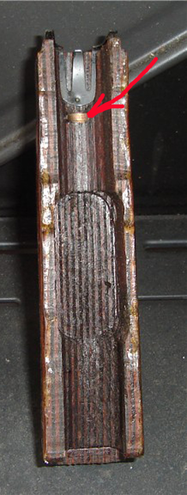

Lekss 0 Posted June 4, 2006 Report Share Posted June 4, 2006 Dinzag, Answer, please! At adjustment of the given detail, whether it is necessary to cut this pin? And if it is necessary to cut, whether that will affect it durability of a design? Yours faithfully Alexey. Quote Link to post Share on other sites
Lekss 0 Posted June 6, 2006 Report Share Posted June 6, 2006 Alexey, here is the drawing you requested...in PDF format. s12_hgr.pdf Friends!!! Answer, Please!!! How the given drawing was measured? In millimeters or inches? Yours faithfully Alexey. Quote Link to post Share on other sites
dinzag 31 Posted June 6, 2006 Author Report Share Posted June 6, 2006 (edited) Lekss - it's in inches. Also, the metal pin you show has to be ground down some - not too much. I don't think there is an effect on durability from that. Maybe from all the wood removed from the sides, but not what was removed from the pin. In this pic you can still see the recessed area in the front where the clip goes and the recessed area in the center of the HG. There's not much removed top to bottom, mainly the sides. The recessed areas are still visible. Also the spring clip still fits in there, just not around the barrel. Thanks! Edited June 6, 2006 by dinzag Quote Link to post Share on other sites

dinzag 31 Posted June 6, 2006 Author Report Share Posted June 6, 2006 6500rpm - thanks man! The barrel was 22.88" long and I cut it back to 19". I just laid it on the chop saw and went at it. That barrel is some hard a$$ stuff! I tried a pipe cutter and broke two cutter blades. Chop saw took all of 10 seconds. I then ran a file over the end of the barrel and removed all burrs & sharp edges inside and out. It was never threaded for factory chokes so the Rem's will be just fine. Also the brake Tony made me is just a slip-over that I set-screwed on. I seem to remember Tony saying it would be too thin to double thread as well. Quote Link to post Share on other sites
Lekss 0 Posted June 7, 2006 Report Share Posted June 7, 2006 Lekss - it's in inches. Also, the metal pin you show has to be ground down some - not too much. I don't think there is an effect on durability from that. Maybe from all the wood removed from the sides, but not what was removed from the pin. In this pic you can still see the recessed area in the front where the clip goes and the recessed area in the center of the HG. There's not much removed top to bottom, mainly the sides. The recessed areas are still visible. Also the spring clip still fits in there, just not around the barrel. Thanks! Thanks you for the HELP!!! Yours faithfully Alexey. Quote Link to post Share on other sites

Cobra 76 two 2,678 Posted June 7, 2006 Report Share Posted June 7, 2006 Yes we do indeed. Ron he made those palm swells on the left HG out of the Romy donkey dick thingy he cut off the bottom. Alexey it wont hurt anything to cut thru that pin. It's just there to reinforce the laminate that is glued and cured now anyway. Here's the one I put on my AKS-20 with the "modified" retainer ready to weld. If you weld it in place you can still have a cleaning rod. Only problem is you can't change to a different HG after that. Hey dinzag could you take a pic of that flip up front sight? I have one of those like the rear one but haven't seen the front ones to match. I assume that is what those two pins are for on the FSB? BTW I used some white out to fill the glo dots on the rear till I can find some glo paint. Works great in low light with my painted front sight pin. Quote Link to post Share on other sites

Lekss 0 Posted June 7, 2006 Report Share Posted June 7, 2006 (edited) The drawing Excellent(Different)! But, unfortunately not all the sizes long are submitted. Without these sizes, people cannot make this detail. Yours faithfully Alexey. [ Hey that looks really nice! THANKS!!! Yours faithfully Alexey. Edited June 7, 2006 by Lekss Quote Link to post Share on other sites
IndyArms 10,189 Posted June 7, 2006 Report Share Posted June 7, 2006 Alexy... I wouldnt worry about the "proper" radius for those cuts... Just round them off to your satisfaction. No one is going to come up with a micrometer and measure the diameter of the radius and tell you it is wrong!! ROFL!!! Make it YOUR WAY, make it nice... and it will be AWESOME!!!! Quote Link to post Share on other sites
dinzag 31 Posted June 8, 2006 Author Report Share Posted June 8, 2006 Alexey, bro, get your paws on an AKM/AK-74 lower handguard retainer. Then modify it to the dimensions supplied. The 3D model I created does have all the dimensions, I just didn't show them in the drawing. It's an AK for god's sakes - dremel fu! Cobra - here's some pics of the front flip-ups. Excuse the welds - gotta be ground down & cleaned up yet. I'm gonna dot the sights with fluorescent orange I think... I too began work.Yours faithfully Alexey. Lookin good! I can get you the dimensions if need be. I was just trying to demonstrate what I did to an AKM HG retainer. Quote Link to post Share on other sites
GunsmithCat 0 Posted June 8, 2006 Report Share Posted June 8, 2006 Does anyone know where there is a walkthrough on doing the rear sight block conversion on an S-12, after looking at Dinzag's conversion I really want to do this when I convert my S-12. I am really curious on what has to be done to the rear sight block and the backside of the gas tube to make it work. I understand the part about modifying the trunion and welding the rear sight block to the barrel/trunion but I want to know what would be needed to make an AK rear sight block work with the stock gas tube. I hope someone can help me out here, I really want to make my S-12 into a work of art like Dinzag's is. Quote Link to post Share on other sites
