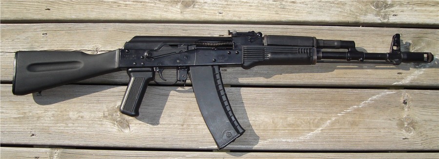

Here's my S-223 conversion. 2004 model, BHO, 16" barrel.
I have to weld the 2 rod holders on, clean-up & paint yet. Also waiting the return of my bolt carrier from Pistonring8.

Mods:
-Usual PG conversion with K-Var U.S. furniture. 6 compliance parts with FCG & Furniture. I can attach any import mag or brake.
-Added bullet guide & fitted AK-74 mags & followers.
-Notched safety lever for BHO capability.
-Pressed FSB off barrel & removed the shroud; drilled for indexing pin & spring & ground the bottom flat for cleaning rod holder. (need to weld)
-Pressed off gas block & attach bayo lug to bottom. (need to weld)
-Notched barrel for AK-47 lower HG retainer locking tab.
-Swapped factory gas tube for AKM tube with retainers.

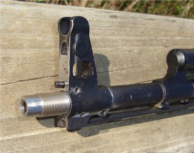

-Threaded barrel for 14x1LH threads.
Things learned:
I wanted the FSB in the factory position and with the AK-74 brake there wasn't a need to attach a bayonette lug or bayonette. Due to length of barrel in front of FSB, the forward threads had to be ground down to clear inside of the brake. If one wants a bayonette attached, you need to move the FSB forward or bayo lug back. Use cobalt bits for drilling the FSB & trunnion as there is a lot of carbon in the steel.

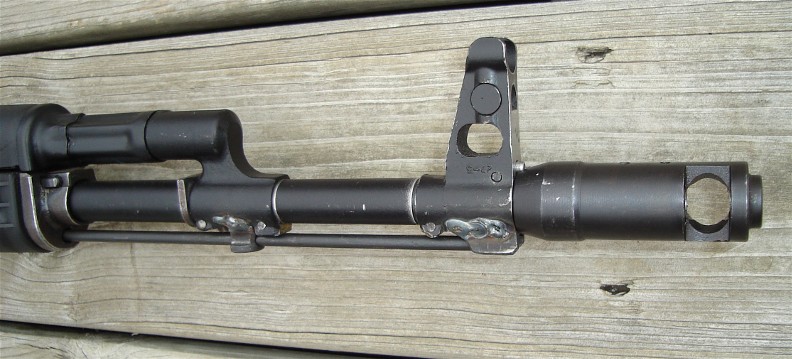

Here it is as welded. I need to grind a little & paint.
Since the AK-47 HG retainers don't have a sling loop, I put the AK-47 one on just behind the gas block - just barely enough room. The barrel diameter was a perfect fit and it was held on with the gas block.
The close-ups also show the dilemma with the factory FSB being set back for proper bayo lug placement. Normally they are on the front of the gas block bottom. To get the bayo to lock it needs to be set back 1/2" the same as the FSB.
