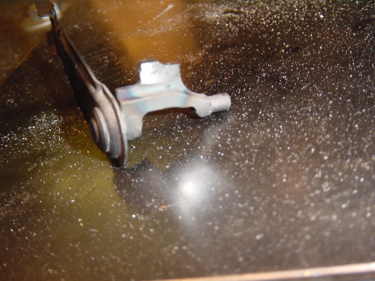

headshot 52 Posted July 5, 2006 Report Share Posted July 5, 2006 Given how serious this issue is, does anyone have a picture of a correctly modified safety that addresses the problem? THANKS! Quote Link to post Share on other sites

dinzag 31 Posted April 18, 2008 Report Share Posted April 18, 2008 Another option for the G2 FCG... Quote Link to post Share on other sites
Ogar Lumox 1 Posted November 27, 2008 Report Share Posted November 27, 2008 I'm doing my 308 right now. Three issues so far. 1st is the saftey. I don't have welding toys, so I ordered a Rom. F/A saftey to see if it will work. (g2 has no F/A tab on disconnector) If not, I'll hit the muffler shop where I used to work.Second is the disconnector spring. The original is larger O.D. than the g2 hole. I'm ordering a new spring, rather than boring the new part. Third, the g2 hammer has a knob on it that strikes the crossbar. The original is flat from the radius halfway up the hammer. I filed it down to fit. I will update with more, but it may take a while. I was going to say "Happy to see I'm not the only one having trouble with a TAPCO G2 FCG in a 308 Saiga" but this is not a laughing matter (gun Safety" that is). I am having the exact problems with this one. 1. The bump on the front of the hammer hits the cross brace and the hammer won't hit the firing pin. 2. The hole for the disconnecter spring is too small and the OEM spring won't fit. 3. the safety works sporadically and when it does work it releases the hammer when I move the safety into the fire position. So I found a replacement spring for the disconnecter, now guess I will need to grind down the bump on the front of the hammer to clear the cross brace, and weld a tit onto the safety bar for a more positive lock up of the trigger. So much for an easy drop in FCG mod. I'm a little ticked off about the whole thing. Not so much that the TAPCO parts are bad, they just don't fit properly in a Saiga 308 and the instructions don't cover the situation. Quote Link to post Share on other sites
ralphie 0 Posted December 15, 2008 Report Share Posted December 15, 2008 Another option for the G2 FCG... Dinzag, could you elaborate on your post? Is this a standard modification you do on the G2 FCGs you sell for 308s? Quote Link to post Share on other sites
cellsworth 21 Posted December 15, 2008 Report Share Posted December 15, 2008 Another option for the G2 FCG... Dinzag, could you elaborate on your post? Is this a standard modification you do on the G2 FCGs you sell for 308s? I'm not Dinzag, but I can tell you that Dinzag's .308 FCGs do include that modification. They address all of the issues peculiar to the .308 FCGs. Quote Link to post Share on other sites
