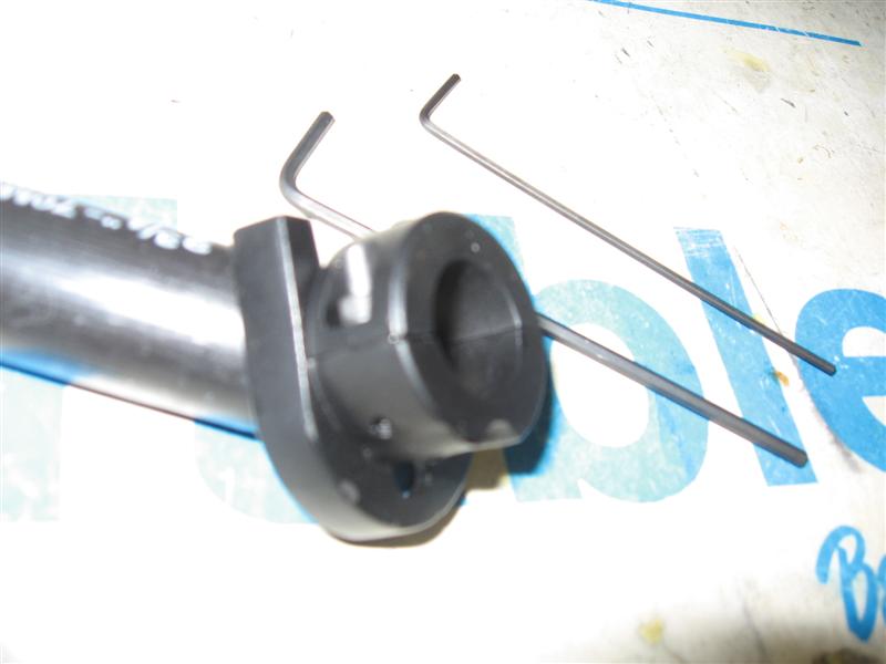

That is lower part of the retainer on the lower handguard, My lower's "spring" was quite stiff so it took some grip to get the retainer to stay put.
That is the Upper part of the retainer threaded (just barely) onto the lower part of the retainer, To get this without going a bit nutts I actually slid the whole retainer assembly forward off the handguard to start the screws, then I pushed it back on. The middle screw in the top of the upper handguard is loose at this time
Sorry about the fuzzy pics but I can't see to find (if there is one) a setting on the camera for close up shots. What is going on here is I was screwing down the two outside screws (the ones that were just threaded so I could slip the assembly back onto the lower handguard). Take it slow and try to line up the lower part of the retainer and the upper part of the retainer so the gap level. Once you have the gap leveled out make sure those screws are tight. Then take the smaller allen wrench and tighten down the middle screw once you have the retainer seated on the handguard (In my finished pictures you can see a gap still).
Ready for the upper handguard
and ta-da one mechanically non-inclined college bound monkey way's of making Dinzags lower retainer fit

Well after about another 10 mins with the retainer I got it on more soild than when I took the orginal pictures, there is no gap now between the retainer and the lower handguard. Let me rephrase there is the normal ammount of gap there is there with a standard retainer but not as much as a gap as my pictures show.
Totally awsome product :super: The handguard is soild on there.

The set screw on the top of the retainer holds the assembly in place, in addition to the clamping pressure of the retainer. Once it is on it's very solid.
Dinzag is updating the design a little, so that the set screw will be on the bottom in order to be more accessible to those with larger diameter barrels (ie .308).
