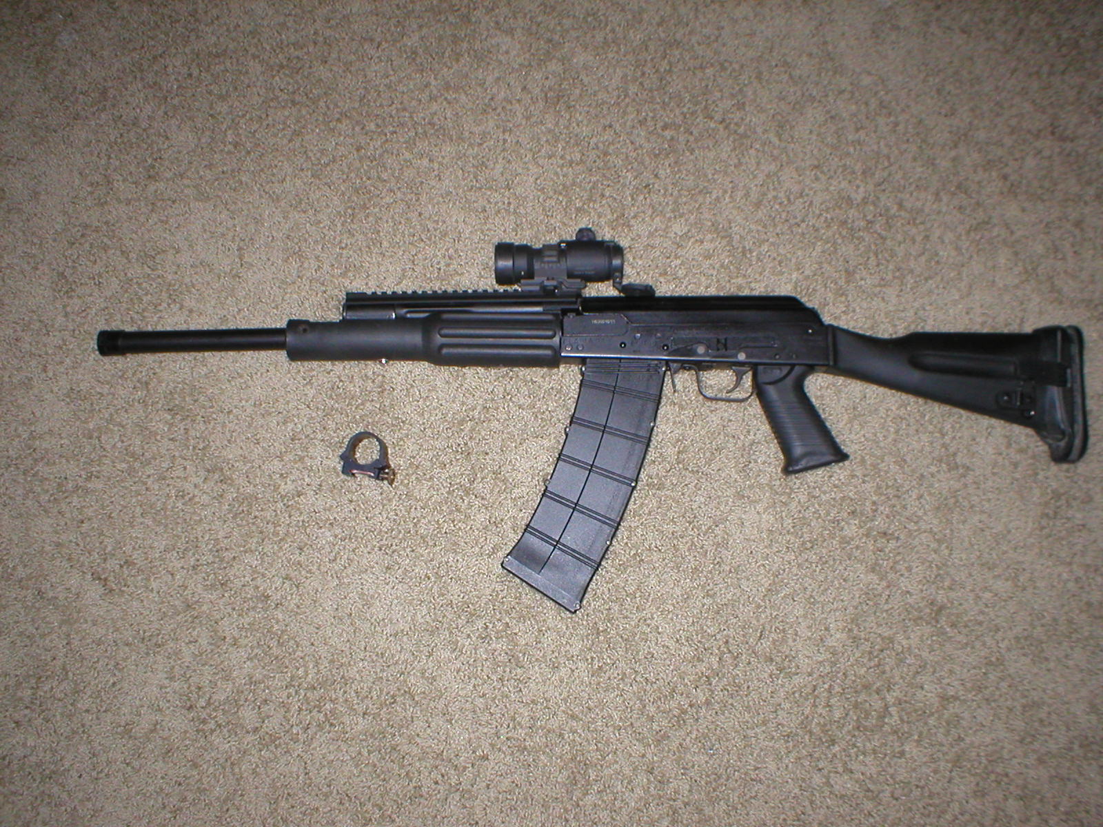

Just an FYI to all you folks out there. If you want to use one of the new Ultimak rails for your Saiga 12, the Larue throw lever won't work.
Larue's throw levers need clearance below the rail. The Ultimak rail juts out and blocks the Larue from fully closing. Even though I don't like ARMS mounts, they fit. So I'm using that instead. I tried a QRP and that also worked.
Also, this rail system is quite nice. It sits even lower than one of the low Kvar mounts. (About 1/2 inch lower.) Currently I've got an Aimpoint Comp M2 mounted in an the ARMS M68. I'm thinking that it might be even nicer to get lower using a unit like the Burris Fastfire (Jpoint type optic) or an Aimpoint Micro. (I'd LOVE to have an Aimpoint micro.)
I'm thinking I might just have to try mounting it using one of the really low Aimpoint manufactured rings.
