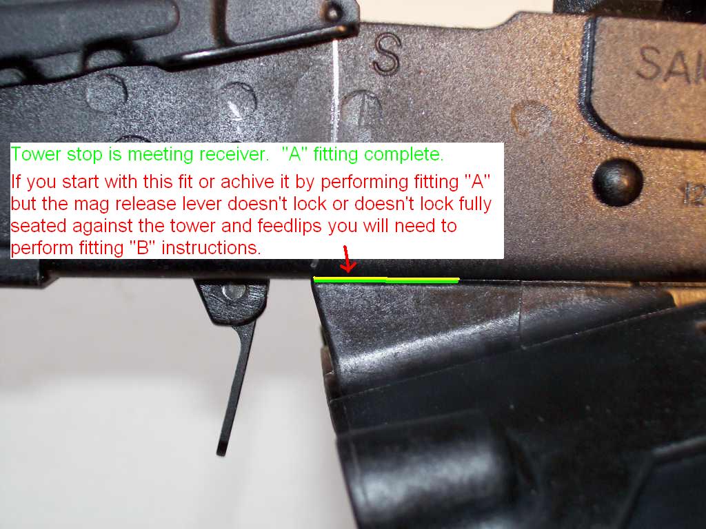

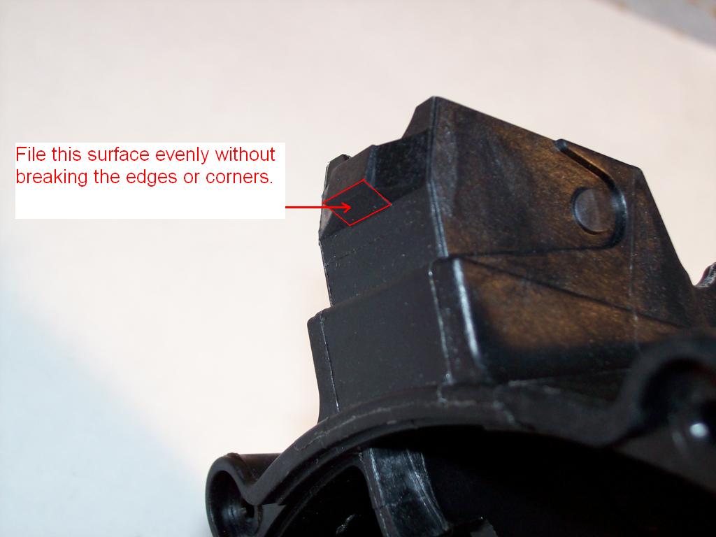

First please watch the fitting video through this link:
After viewing the video you can view more detailed pics below of how to identify which fitting you need to preform, the fitting locations, and how to preform the fittings. Remeber to click the pics to make them bigger!
It is important to identify the correct fitting. Before you perform the "B" fitting make damn certain you aren't skipping the "A" fitting.
"A" fitting , identification
"A" fitting , location and procedure
"B" fitting , identification also represents "A" fitting, completed
"B" fitting , location and procedure
"B" fitting, completed
Everything above was added 10-17-08. Everything below is the correct timeline state in the posts time and date stamp. Post # 27, 29, 30, 31, and 36 are from a seperate thread I merged into this one.
It seems about half will need to fit the drum. I wanted to let everyone know I am going to film a video (hopefully this weekend) on how to fit the drum magazine to your saiga-12. Only a very small amount of material should be removed. I am talking dust! If you have any questions or concerns please wait to do the mag fitting. It is very simple if you know what you are looking for and I will show you clearly what that is. 2 Fittings, in 2 locations, in the rear mag catch area. You may have to do one and possible both.

I tested mine on three different Saigas and it didn't lock into any of them. On two of them, it went in all the way, but just barely couldn't get over the top of the mag lock/release thingy. On one of them, it wouldn't go "up" all the way. I'd hate to modify it to fit one and then have it not fit in others. I'm not bitching or anything, and I am confident that it can be very easily modified to fit, but I want to be sure I do it right the first time.
Will this be fixed with the 2nd. run? or will the mod. have to be done to them too?

Mine almost fit out of the box but after following Mike's easy instructions i carefully filed the two points on the drum and it fits like a glove. :beer:

Correct, I originally only planned to have one fitting ,the "B" fitting instructions. This is the fitting that is includes as a Russian instruction included with "some :unsure: " of the extra factory 5 rd mags you purchase ( not the 5rd mag included with the gun, the russians mod those). I have a thread with a pic of these Russian instrucions as provided by the factory somewhere in my section here.
The other fitting I mention, "A", is something that is becoming more common from the factory. It used to be rare. If you have the last 4 digits of your serial number penciled on your factory 5rd mag it is very likely you will need to do fitting "A" on the drum. The russians are preforming this fitting in the factory and matching that mag to the gun they fit it to by the penciled serial numbers. If you look at the top of the rear mag catch of you factory mag I think you will find it isn't a nice clean sharp corner and has been trimmed, shaved, or filed by hand. It is likely as well if you have this done that a newly purchased Russian 5rder isn't going to lock into your gun either without doing the "A" fitting to it as well and (maybe) even the AGP and russian 8's.
I will be pointing all this out in the video including showing a pic of a penciled, modded fartoy 5 and a factory 5 with no pencil and no mods. I think after I make the video it will clear this up and show everyone why it is neseccary. I am also going to extensivly test what it will mean to the fit of the drum if I make the "A" fitting already worked into the drum from me. If I can clear it up without sacrificing the tightness of the drum in the reciever I will. If I can't, I won't. I feel it is important to stabilize and support the weight of the loaded drum as much as possible. I have fired looser fitting drums that match the rock and wobble of the factory 5 in the receiver and never had any problems or extra wear but it just isn't what I wanted for the drum. It want the drum to lock in as solid and firm as possible.

Mike's instructions inlcuded with the drum are very good. The filing needed (If at all) does seem to be to the guns with digits written on the original magazines as mine is a 2001 with S/N 0001 on the gun and mag. You need to only steal/borrow your female companion's fingernail file and follow the instructions. Be warned! The drum 'might' fit OK with no ammo in it but need tweaking because the ammo tends to force things rearward. In any case it's really easy. I suggest fitting with empty mag then load 'er up and repeat the procedure if needed. As I said, you need a needle type file if at all and put the Bastard file down.
I spent 10 minutes on before and after loading filing. And once easily fitted it ran perfectly.

The instructions are very precise. I read them about 5 times before filing anything, wanted to get it right the first time and I did. Dont get carried away filing, you will most likely only be removing thousandth of inchs, a little goes a long way.

Got my drums in last Friday and had to work the "B" on both. The first one came out real nice - I had to file about 1/2 of the notch off though. I got a little over aggressive on the second one and it now has a little up/down slop in it...about 1/8". I haven't fired it yet, but I'm wondering if this is going to be a problem. If so, what can I use to fill it back up a bit? Suggestions?

I filed mine on "A" side first and "B" side just like the directions said, a little ,..then test fit and do "A" first, and then "B"
it still is a little tight to lock in
I hand cycled some rounds through,.. the first copule of times it went kinda rough, they go smoother as I did it multiple times.
If you filed off too much, I would let Mike make a reccomendationa s to what to do to fix it, if its a plastick welder or JB weld, who knows,..

I found that with all three of my drums I had to file just a little off the front sides so it would go fully forward. When I did this no other filing was necessary. I tried the step one and two on the first one and after a little filing and noticing no better fit I started looking elsewhere. Once I filed the front no problem. Did the same to the other two and did not need to do anything else except shoot away. Really scares the people at the indoor range I shoot at.

Here are some pics of the mods I had to do to fit the mags to my Saiga. Once done they fit and work perfectly. Should be mentioned that it took a few tries to get it right, did not want to take off any more than necessary.
