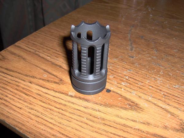

johnnymceldoo 0 Posted February 1, 2005 Report Share Posted February 1, 2005 IM curious to see how many saiga12 owners have the siaga with the polychoke and how many of you would have an interest in a flash hider that would screw onto the existing threads. This would be basically the same design as the set screw and 7/8-28 version I made only it would have the same thread size as the saiga polychoked shotgun. Here is what they look like if you hadnt seen them before. Quote Link to post Share on other sites

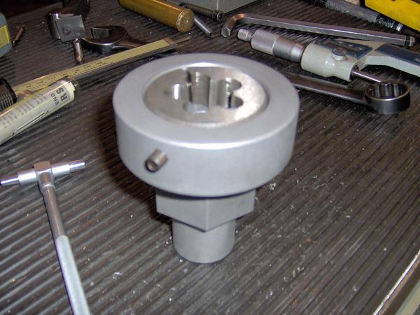

johnnymceldoo 0 Posted February 1, 2005 Author Report Share Posted February 1, 2005 Id like to add: If you would prefer to have a threaded version I have a die guide that you can rent allowing you to thread your own barrel instead of using the setscrew version. Some people here have used it and have had good succuss. Quote Link to post Share on other sites
johnnymceldoo 0 Posted February 1, 2005 Author Report Share Posted February 1, 2005 I am interested in a muzzle break that threads on the existing threads of the Saiga-12 shotgun. I never found a metric tap to do this, per our previous conversation. Maybe you found a tap to do this? Yes I found a tap...well I found a place that would make one for me. Unfortunetely the cost was too high and so Iam chasing internal threads instead. Someone sent me their thread protector so I could make a thread gauge to check my threads after I chased them. Tonight I succesfully chased the threads for the FH and timing nut and will be shipping it to him wednesday and should know by the beginning of next week if it fits his barrel. Id like to have a tap as it would be less time consuming more forgiving but I cannot justify the price tag. Quote Link to post Share on other sites

wintermute76 0 Posted February 2, 2005 Report Share Posted February 2, 2005 I'll pipe up here, I"m the guinea pig Can't wait to try it out. What I just don't understand is why gun manufacturer's can't use standard size threads for anything, just can't make it easy for those of us who like to make our own stuff, ya know. For example, when I priced a tap for the threads I got a quote of almost $200. Now even if Johnnymceldoo went that route, he'd have to sell 20 flashhiders at a $10 markup just absorb the cost of the tooling. I can understand why he (and myself) would be reluctant to have to stick all that out front. Chasing on a lathe works, just a little more dicking around if you don't have an actual gage to use. Isn't machining wonderful? Again my hat is off to Johnny for all the work he's put into this for me, and by doing so, anyone else who gets one Quote Link to post Share on other sites

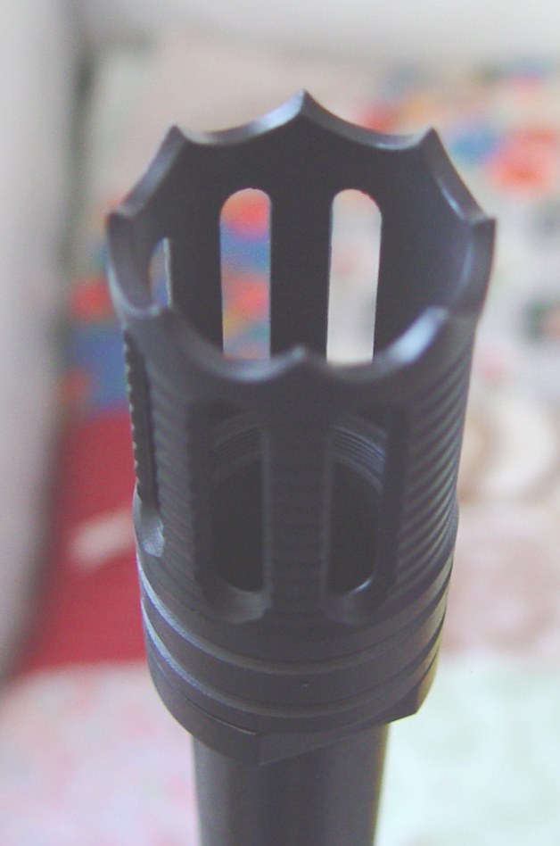

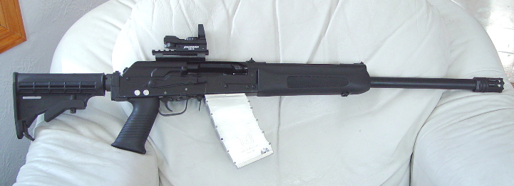

wintermute76 0 Posted February 4, 2005 Report Share Posted February 4, 2005 Got my Flash hider today, it fits sweetly and just looks BADA$$ Thanks Johnny ! I'll get some pics up Sunday night, I"m off for teh North country now. Quote Link to post Share on other sites
wintermute76 0 Posted February 7, 2005 Report Share Posted February 7, 2005 Sorry this is late, got caught up BS'ing with friends up north. here's the whole thing Quote Link to post Share on other sites
wintermute76 0 Posted February 7, 2005 Report Share Posted February 7, 2005 close up Quote Link to post Share on other sites
wintermute76 0 Posted February 7, 2005 Report Share Posted February 7, 2005 Idea of size Quote Link to post Share on other sites
johnnymceldoo 0 Posted February 7, 2005 Author Report Share Posted February 7, 2005 Awsome pics wintermute. Dodgeturbo, the pic that wintermute posted is a factory threaded version. E-mail if you want one. Johnnymceldoo@yahoo.com Quote Link to post Share on other sites
