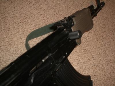

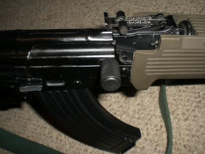

TonyRumore 1,329 Posted February 18, 2009 Report Share Posted February 18, 2009 I thought this up several years ago, but finally made one up. I'll get a run of them made in the next 30 days or so. It might sell...it might flop, I'm not really sure, but guys do like "bolt-on" parts. Tony Rumore Tromix Corp Quote Link to post Share on other sites

TonyRumore 1,329 Posted February 18, 2009 Author Report Share Posted February 18, 2009 They will be black. I just made that one from a piece of drop-off from an old stainless barrel blank. Tony Quote Link to post Share on other sites

DogMan 2,343 Posted February 18, 2009 Report Share Posted February 18, 2009 Oh, yeah. I like to charge my S12s with my left hand. Easy enough to do on my Tromix but not so much on the others with a standard handle. Looks like I could just rotate the gun a little and grab this thing real easy. I like it. Quote Link to post Share on other sites

corbin 621 Posted February 18, 2009 Report Share Posted February 18, 2009 (edited) I like it. I want one. When can I send in the money? I'm wondering though, do you think they'll stay on OK with the handle flying back and forth? I'd almost want to weld mine on. I had thought about an hourglass shaped piece similar to this, but couldn't figure out how to attach it. Corbin Edited February 18, 2009 by Corbin Quote Link to post Share on other sites
surfmaster 5 Posted February 18, 2009 Report Share Posted February 18, 2009 It looks good but will the set screw be solid enough to hold the bolt-on extension to the charging handle since it will be moving at a high velocity during firing? Do you need to supplement the set screw with an adhesive? How much will each cost? Thanks. Quote Link to post Share on other sites

TonyRumore 1,329 Posted February 18, 2009 Author Report Share Posted February 18, 2009 I don't think it will have a problem staying put as long as the set screw is installed with loctite. Without thread locker, I doubt it would stay on for very long. That set screw is pretty damn big. It's 5/16-24 and will be sitting in the "saddle" of the charging handle, so if it started to loosen, you would notice it before the thing went South on you. Regardless, I will test the prototype and make sure it works before selling any. Tony Quote Link to post Share on other sites

avnate 335 Posted February 18, 2009 Report Share Posted February 18, 2009 It looks good but will the set screw be solid enough to hold the bolt-on extension to the charging handle since it will be moving at a high velocity during firing? Do you need to supplement the set screw with an adhesive? How much will each cost? Thanks. I guess you could always drill a hair into the bolt like the Dinzag hand-guard retainer and still use loc-tite to set the screw. Quote Link to post Share on other sites
