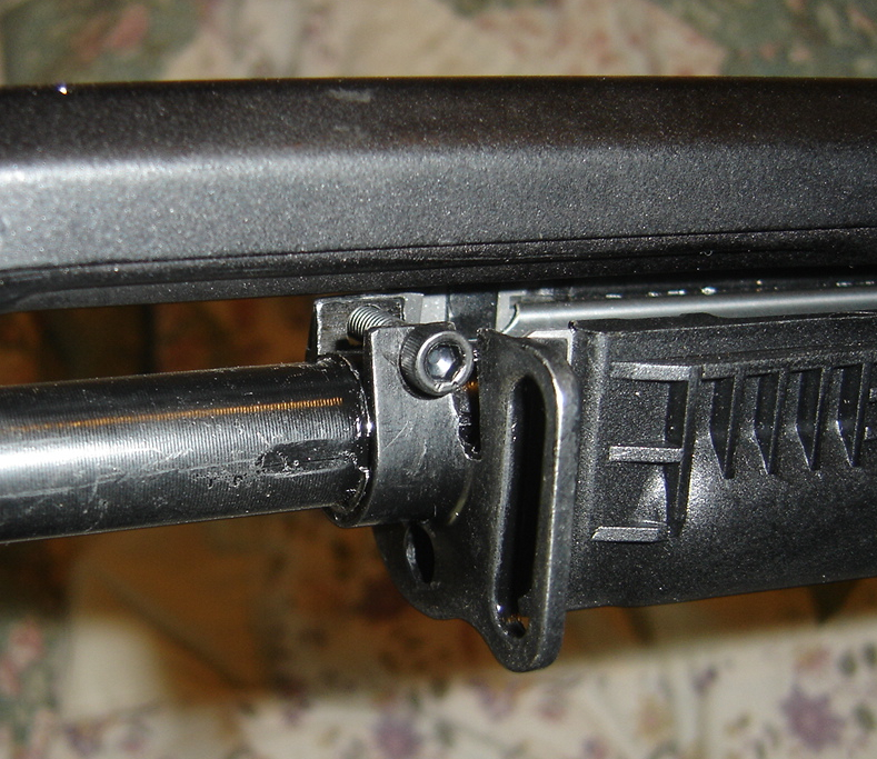

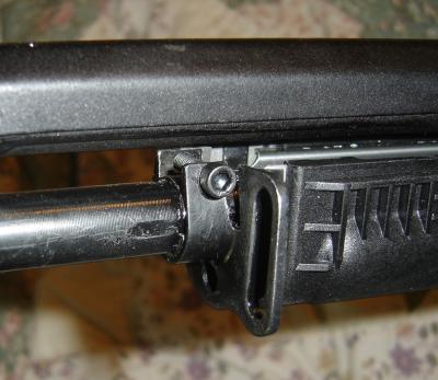

imarangemaster 315 Posted May 3, 2009 Author Report Share Posted May 3, 2009 Here's some pics of the progress. The retainer came out alright, though I think I may pick up another as I have a few ideas about cutting a little different. MD Willminton used a yugo retainer, and the hole for the lock lever is farther foward, and give more room for a cut. I used the East German because I like the larger sling loop. Quote Link to post Share on other sites

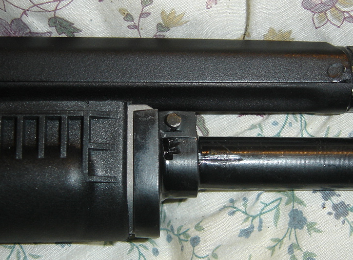

imarangemaster 315 Posted May 3, 2009 Author Report Share Posted May 3, 2009 (edited) Here's an update. Went to the hardware store and got a 8/32 cap screw (hex allen head, already black) and a flat speed nut (also already black). It is about 4mm diameter. The original rocking retainer pin was 5mm, but I did not want to notch the barrel that deep if I didn't need to. Put it on and cut the screw to length, dabbed the end with cold blue. I am going to to a total repaint once I get the Rommy gas tube. Notice the stock gas tub on it now. The 8/32 screw engages the shallow notch in the top of the barrel and would not let it budge forward at all, even when whacked with a prass hammer. I don't think recoil will be an issue! I plan on getting another retainer and cutting it a little different (read NEATER), but this will do for now. "A man going by on a horse would notice a thing, especially if he was blind in one eye, and couldn't see out of the other!" Edited May 3, 2009 by imarangemaster Quote Link to post Share on other sites

protected static 19 Posted May 12, 2009 Report Share Posted May 12, 2009 Here's some pics of the progress. [snip] The retainer came out alright, though I think I may pick up another as I have a few ideas about cutting a little different. You said that you grooved the top of the barrel for the screw that replaces the retaining lever - did you also have to groove the sides of the barrel for the little tabs that are on the inside of the retainer's barrel band? Quote Link to post Share on other sites
imarangemaster 315 Posted May 12, 2009 Author Report Share Posted May 12, 2009 (edited) Here's some pics of the progress. [snip] The retainer came out alright, though I think I may pick up another as I have a few ideas about cutting a little different. You said that you grooved the top of the barrel for the screw that replaces the retaining lever - did you also have to groove the sides of the barrel for the little tabs that are on the inside of the retainer's barrel band? Mine had the lateral grooves in it already. I got luck. Must be an AK103 barrel. My 223 Saiga did not have the grooves. Edited May 12, 2009 by imarangemaster Quote Link to post Share on other sites

protected static 19 Posted May 12, 2009 Report Share Posted May 12, 2009 Mine had the lateral grooves in it already. I got luck. Must be an AK103 barrel. My 223 Saiga did not have the grooves. Okay, that probably explains it... I didn't remember seeing them on my .223 (or in MD Wellington's pics), and when I saw them in your closeup, I was afraid I was having an attack of the stupids or something. Quote Link to post Share on other sites
