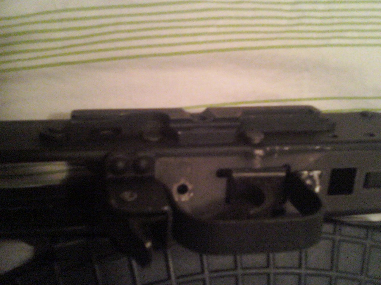

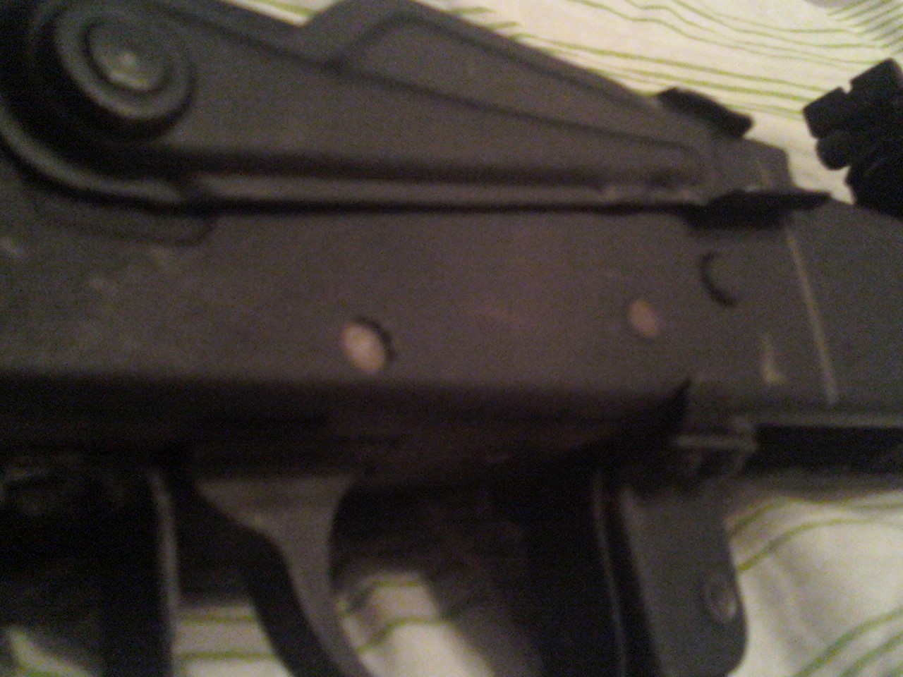

Kriegerwithin 0 Posted June 23, 2009 Author Report Share Posted June 23, 2009 I got that on finally but now the pin that holds my trigger won"t secure it keeps poppoin out Quote Link to post Share on other sites

oxyehho 8 Posted June 24, 2009 Report Share Posted June 24, 2009 (edited) I got that on finally but now the pin that holds my trigger won"t secure it keeps poppoin out post pics please - let's see what's going on Edited June 24, 2009 by oxyehho Quote Link to post Share on other sites

Kriegerwithin 0 Posted June 25, 2009 Author Report Share Posted June 25, 2009 I got that on finally but now the pin that holds my trigger won"t secure it keeps poppoin out post pics please - let's see what's going on The quality is horrible I know, I can only provide cell phone pictures with crappy lighting... This shows (if you can see it) how the trigger pin sticks out compared to the pin holding the hammer. This one shows the trigger pin stayin inside the receiver compared to the hammer pin. What pistol grip nut are you using? I used the Tapco nut and found that the nut was too long, had to cut aprox 1/4" off the bottom of the nut, then my CAA PG fit perfectly, and I used the screw it came with, fir the Tapco PG nut without any problems. It was a TAPCO bushing but when I looked at it closely, there was a thread that was slightly out of shape. Not very much but enough to prevent it from going in all the way. I ordered a new bushing so I'll see if this one works. Quote Link to post Share on other sites
kope007 14 Posted June 25, 2009 Report Share Posted June 25, 2009 (edited) Are you using the retaining plate or shepards crook? There is a little notch on each pin on the left side that the retaining device needs to be seated in to prevent pins from moving. It really can't be on right otherwise your pin could not stick out that far. Also make sure you hit the bottom of the reciever with some paint, if its worth doin its worth doin right. Edited June 25, 2009 by kope007 Quote Link to post Share on other sites
