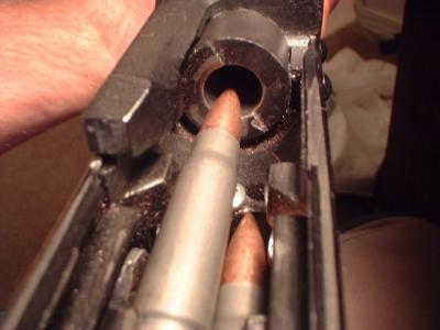

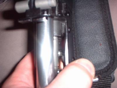

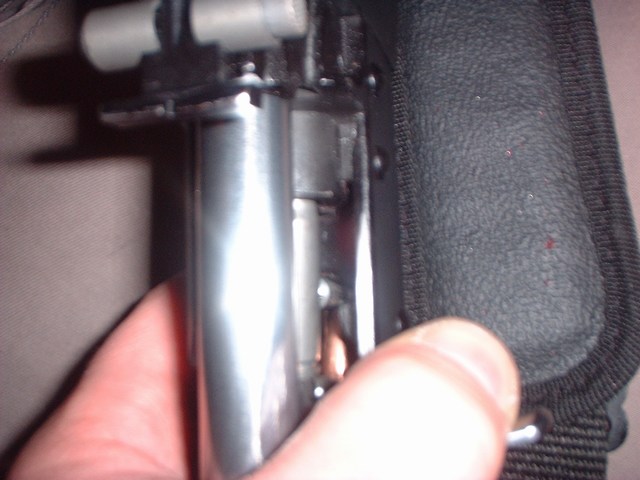

-RotorDemon- 0 Posted April 16, 2005 Report Share Posted April 16, 2005 Do modified magazines count as US parts when modified in the US?? What about modified magazines with US made followers and floor plates? <{POST_SNAPBACK}> Hahaha.. Yeah I asked the same thing. On my AK mags since I didn't want to do any mods to the Saiga itself, was to file it accordingly and put a small domed head screw in the front of the mag for a ramp. Works awesome. I'll see if I can get a better picture when my stupid neighbor gives my digicam back. Quote Link to post Share on other sites

Cobra 76 two 2,677 Posted April 17, 2005 Report Share Posted April 17, 2005 Hey RotorDemon cool idea with the domed screw! I haven't seen that one before. Does that eliminate the need to install feed ramp in the gun? How much testing have you done? Quote Link to post Share on other sites
hoop762 0 Posted April 18, 2005 Report Share Posted April 18, 2005 Hey RotorDemon cool idea with the domed screw! I haven't seen that one before. Does that eliminate the need to install feed ramp in the gun? How much testing have you done? <{POST_SNAPBACK}> yeah man. thats a cool idea!! i never heard that one before. Cant wait to see some more pics. Let us know how those work out. Gotta love that american ingenuity!!! Quote Link to post Share on other sites
-RotorDemon- 0 Posted April 18, 2005 Report Share Posted April 18, 2005 Hey RotorDemon cool idea with the domed screw! I haven't seen that one before. Does that eliminate the need to install feed ramp in the gun? How much testing have you done? <{POST_SNAPBACK}> yeah man. thats a cool idea!! i never heard that one before. Cant wait to see some more pics. Let us know how those work out. Gotta love that american ingenuity!!! <{POST_SNAPBACK}> Thanks Yes it does eliminate the need for a feed ramp, and for testing I have put 1300 rounds through the gun the majority was through the mag pictured above, plus I modded another 30 round mag and have no problems with that one. I have had two rounds in the beginning that did not feed directly into the barrel that the bullet sat on the rim of the barrel, fixed that by turning the screw out 1 turn or so. Originally it was going to be a temporary mod until I could figure out how to weld up a bridge on the AK mag. but it works so well, I said screw it. I posted a bump fire video here and used the mag that is in the picture above. http://forum.saiga-12.com/index.php?showtopic=5115 The reason why I did not want to install a feed ramp is because I don't want to modify any of the internal parts, add or drill to the reciever. Still no word on my digicam, I'll pound on his door tomorrow. Quote Link to post Share on other sites

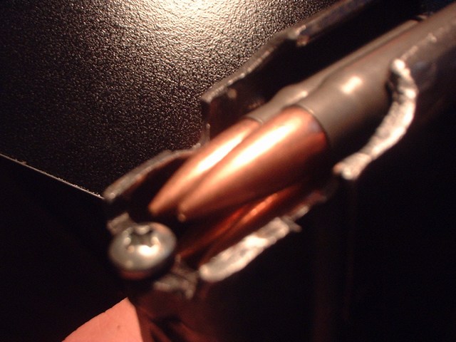

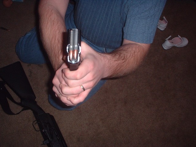

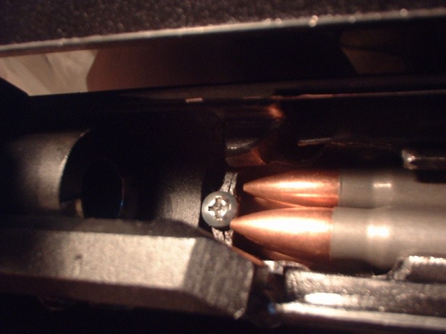

-RotorDemon- 0 Posted April 23, 2005 Report Share Posted April 23, 2005 Scuse the mess, she needs to be cleaned. Quote Link to post Share on other sites

IndyArms 10,184 Posted April 23, 2005 Report Share Posted April 23, 2005 I have just two questions on that... Did you have to drill a small pilot hole first? or just thread that sucker in between the steel folds? On my mags theres hardly ANY room for a screw to thread in.. ALso.... Did you have to remove a small amount of metal on the front of the follower at all? thanks!! Quote Link to post Share on other sites
Cobra 76 two 2,677 Posted April 24, 2005 Report Share Posted April 24, 2005 Great pics and awesome idea!! Quote Link to post Share on other sites
-RotorDemon- 0 Posted April 24, 2005 Report Share Posted April 24, 2005 (edited) I have just two questions on that... Did you have to drill a small pilot hole first? or just thread that sucker in between the steel folds? On my mags theres hardly ANY room for a screw to thread in.. ALso.... Did you have to remove a small amount of metal on the front of the follower at all? thanks!! <{POST_SNAPBACK}> Yes I did drill a small pilot hole first, I don't remember the size offhand but it was smaller than the screw itself, put the screw in and let it thread itself in, backed it out and cut a bit off the screw so it wouldn't protrude out of the bottom, on both mags a bit of the metal got forced inwards so after you are done with the mod, take a pair of pliers and just squeeze it back into place. One thing I haven't done and would encourage others (if they were going to do this) is to use some thread locker on it. because it could walk, either up or down. This should be done at your risk only, I'm not to be held liable for any damage or injury. Follower as in where the screw is sitting on? If so, I did not. (Still a greenhorn) Edited May 7, 2005 by -RotorDemon- Quote Link to post Share on other sites

-RotorDemon- 0 Posted April 25, 2005 Report Share Posted April 25, 2005 Just put 2000 rounds through it now. GEEZ that wolf ammo is dirty. Quote Link to post Share on other sites
Phila PD 0 Posted April 25, 2005 Report Share Posted April 25, 2005 Can you do us a favor and see if you can find what sized drill bit you used to drill the magazine and maybe shown us on a unmod'ed mag where exactly you did drill. Thanks! Quote Link to post Share on other sites
