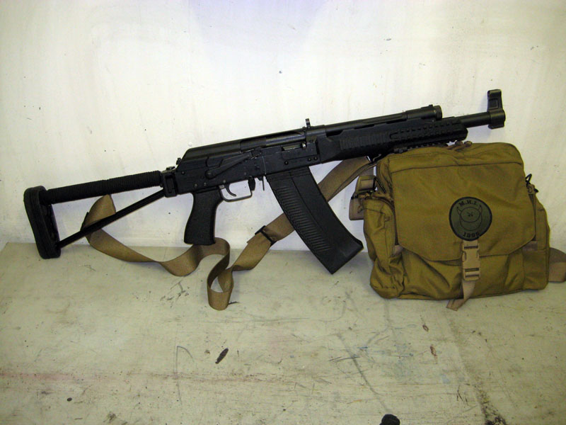

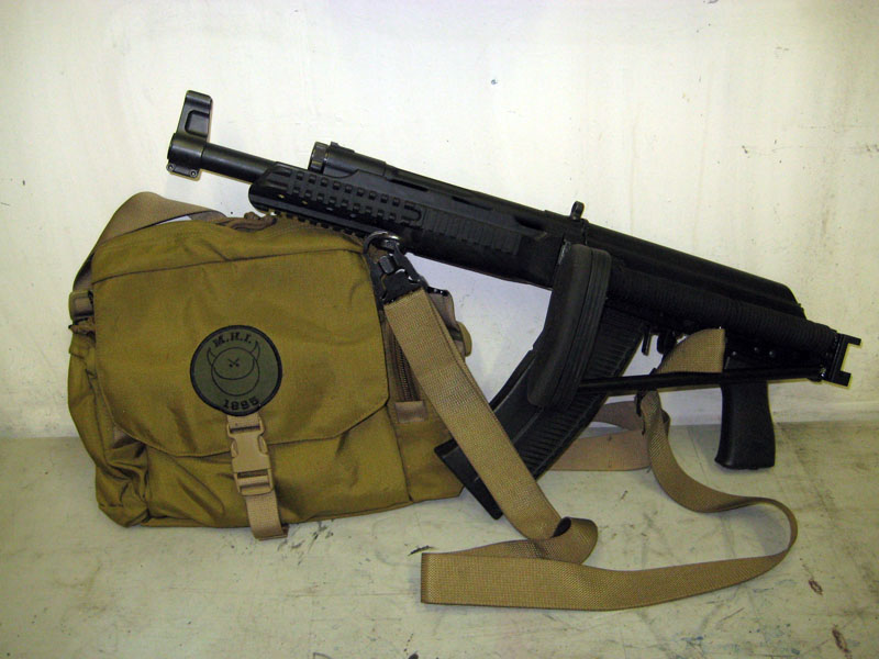

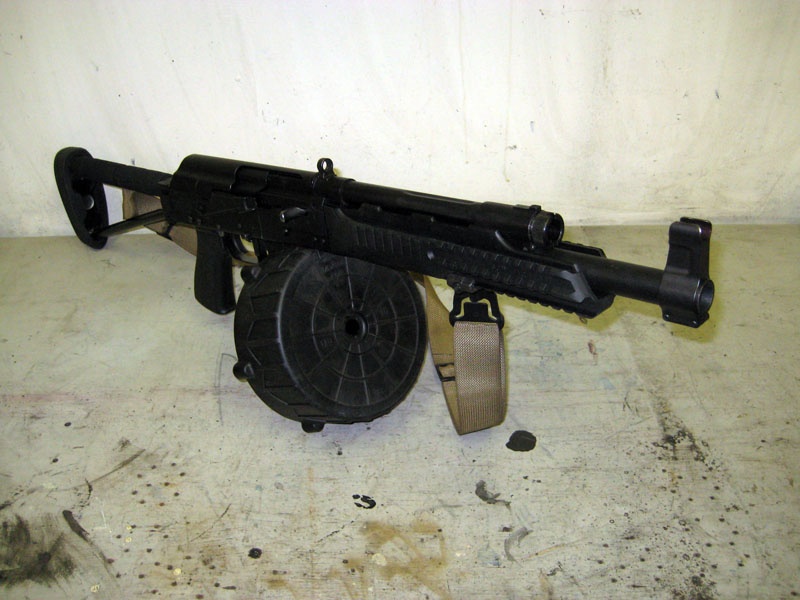

netpackrat 566 Posted August 23, 2015 Report Share Posted August 23, 2015 14" barrel, stock length gas system. It originally had 3 holes at about 5/64" each; I drilled a 4th hole and enlarged them all with a #41 drill. Actually gained a little bit of improved function over stock.... The light trap loads it was iffy with before, are now reliable, even out of the drum. 2 Quote Link to post Share on other sites

gunfun 3,931 Posted April 25, 2016 Report Share Posted April 25, 2016 14" barrel, stock length gas system. It originally had 3 holes at about 5/64" each; I drilled a 4th hole and enlarged them all with a #41 drill. Actually gained a little bit of improved function over stock.... The light trap loads it was iffy with before, are now reliable, even out of the drum. I like the MHI patch too. Quote Link to post Share on other sites

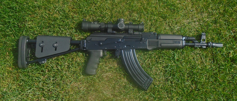

netpackrat 566 Posted August 3, 2016 Report Share Posted August 3, 2016 AMD-65 based SBR, in "AK Black" KG gunkote. Not sure why the finish is ending up glossy; my brother had a couple of AKs finished in the same color years ago, and they are much flatter. I'll have to work on that, although it will be a while before I do any others. Too many other things to do for now. The basic rundown is this was originally built as a pistol with a matching numbers AMD-65 kit on a serial matched NDS receiver when they were still offering that service. I later blind pinned an extended brake on it and made a 16" rifle out of it. Last year when I SBRed it, I rebarreled it with a US 4150 "nitride" barrel from akbuilder.com, which I had shortened to AMD length and lathe threaded with suppresor-true 1/2-28 threads. Internally it has an RSA adjustable FCG set to about 4 pounds, and the usual pin retaining plate. Rear trunnion is one of AK builder's modular units that comes drilled and tapped for the Ace hinge, and the stock with adjustable kydex cheek piece is of my own design and construction. Since it takes a standard AR recoil pad, I put the fat Limbsaver on there to gain LOP more than anything since I have orangutan length arms. The flash hider is a 51T unit that accepts my SDN-6 can, and the optic is a CMR 1-4x with the AK reticle, on a Gen3 TWS rail. The rifle has a few building scars on it, but overall I am pretty happy with it. Eventually I want to build a 16" version set up the same way for traveling out of state without paperwork. Quote Link to post Share on other sites

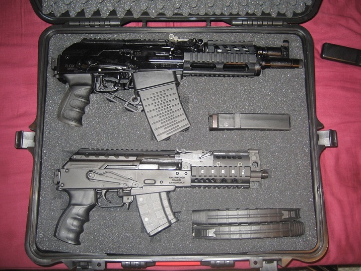

Spacehog 2,219 Posted August 28, 2018 Report Share Posted August 28, 2018 Finally got around to finishing up my last two stamps. At some point in time, I will swap out the rear trunnion on the PAP for a proper triangle setup but am ready to enjoy them now for the time being Quote Link to post Share on other sites

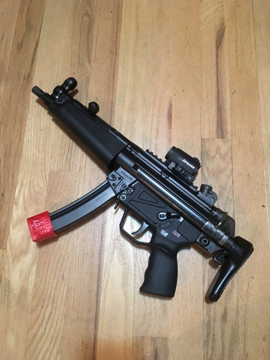

Doug Hartley 526 Posted June 2, 2019 Report Share Posted June 2, 2019 Decided I needed an MP5A3. Picked up a PTR 9ct, US made MP5 clone and SBRed it. Took only 16 business days with Form 1 E File. Added an all steel used German A3 stock from 1980. Roller locks are sweet to shoot! Doug 1 Quote Link to post Share on other sites
