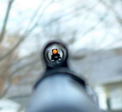

Eric Pate 478 Posted August 11, 2014 Report Share Posted August 11, 2014 Anyone know what the diameter of the EAA import Saiga 12 should be? I tried and stripped the threads on the Krebs Custom combat front sight. And am trying to work it out with Mr. Krebs at present. My best measurements .886 to .889. Mr. Krebs said their sight won't fit. And has offered to replace. But if it's not going to fit, WTF? You're talking about this thing right? Are you asking for the barrel diameter? Mine measures 0.885" just behind where its mounted. There should be more than enough play to allow for a 0.004" size difference, I can't imagine why yours did not fit. What screws did you strip, the ones on the bottom? Are they not long enough to engage or something? Did Krebs tell you why it would not fit? Confused. Quote Link to post Share on other sites

john1969 0 Posted August 11, 2014 Report Share Posted August 11, 2014 Anyone know what the diameter of the EAA import Saiga 12 should be? I tried and stripped the threads on the Krebs Custom combat front sight. And am trying to work it out with Mr. Krebs at present. My best measurements .886 to .889. Mr. Krebs said their sight won't fit. And has offered to replace. But if it's not going to fit, WTF? You're talking about this thing right? Are you asking for the barrel diameter? Mine measures 0.885" just behind where its mounted. There should be more than enough play to allow for a 0.004" size difference, I can't imagine why yours did not fit. What screws did you strip, the ones on the bottom? Are they not long enough to engage or something? Did Krebs tell you why it would not fit? Confused. Yes, that's the one. When I tried to tighten, F/S would still move. After talking to Mr. Krebs I tried to tighten some more, and stripped the female end of threads. You might not be interested in a different FSB by now, but I'm running a Krebs rear with the Dinzag front and I love/recommend it. It slips over the bbl and uses set screws. Also don't have to worry about drifting the rear sight if you get to the range and find it's off by a bit, you can just use a standard AK adjustment tool. I'm thinking about a Big Dot for the sight post. As for your problem at hand, sorry, no I don't have much advice for ya. Good luck though. I've been emailing them too. Quote Link to post Share on other sites
Eric Pate 478 Posted August 12, 2014 Report Share Posted August 12, 2014 Well, that is odd. So your barrel is slightly undersized? Not sure how to fix something that small, off the top of my head you could maybe: 1) remove material from the split portion of the FSB so it could tighten further? 2) use something like metal tape as a shim? 3) knurl the barrel to slightly increase diameter? 4) have your FSB welded in place? (I had Leland at Sierra Ordnace Company do this to mine.) These are just ideas I'm spitballing, I don't know how to correct your issue. Maybe Krebs could even make you an FSB with a slightly smaller diameter. Either way, good luck. Let us know how it turns out. Quote Link to post Share on other sites
