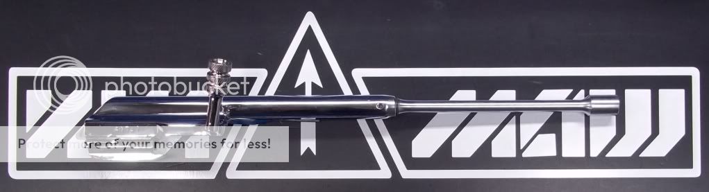

This can be done by anyone with a Dremel and the proper attachments you can buy at any Home Depot. Initially I was gonna ship mine off to one of these guys who polish the bolt and carrier and FCG but decided to do it myself. The gun ran fine prior to my polishing anything so quite honestly I'm a little skeptical at the opinions of those selling these services about how totally necessary these processes are.
Just to clarify if you speak about me, I posted my personal 1st procedure long before I went into business. It was for informational purposes to, educate and assist people do their own modifications.
At the time, there were no pictures or methods of process to be found on the net & it was referred to as "grinding the bolt".
I understood the concept so I took pics of how to do a decent mod with some easily attained tools, which resulted in... Meh... A bit of improvement. It was noticeable. Then the post, being something the forum lacked, became a "sticky".
I doubt some could fathom how much stress & annoyance the fateful act of answering the O.P. of this thread has resulted in over the years.
As a vendor on the forum, I have the ability delete/edit any post I have made since this account started, but I chose to leave the procedure up there, because I truly do detest the whole practice & attitude of "You're incapable of doing it yourself, pay me", as I feel that attitude promotes mediocrity in the people. I feel we all really should be able to do stuff on our own, especially maintaining some of the most important tools we own.
That being said, I edited my original how-to post to add an advertizment since I have now greatly refined my processes. GlassBolt has come to age with the input of 5 mechanical engineers, a 40 year gunsmith, myself & leading industry consultants. Currently, it's precision milled & finished with the highest grade consumables available on the industrial market resulting in the most consistent results coupled to the highest level of refinement out there.
My hammers are matched to their carriers according to the shop formula, carriers are properly ramped for a more gradual reset, the bolts are brought to the point of the easiest mag insertion possible on a closed bolt while more importantly, greatly reducing resistance as the body of the bolt rotates with shells pressing against it, then extracts, because it's not like rolling a hexagon & dragging a huge sharp hump over the shells, but rather, every transition is smooth thanks to the best profile possible for optimal resistance reduction while maintaining structural integrity.
But still, as some attempt to discredit my surface conditioning, they neglect to acknowledge my profile is as gradual & transition-free as a bolt can be without weakening it unnecessarily... Posted Image
I really don't get that?
There's pics all over the world wide web of my work. I don't exactly hide it & try to claim pics of my work are trade secrets, They're everywhere.
Proper varied surface conditioning brings GlassBolt to the pinnacle of performance as far as resistance reduction goes. One really does not want a perfect mirror polish on metal to metal work surfaces, as this greatly increases friction as well as greatly diminishes the surface's ability to retain lubrication due to a lack of proper surface conditioning conducive to the capillary action needed fort the retention of lighter weight lubricants..
A high polish on steel to plastic shotgun hull working areas is desirable though, because that combination actually does reduce resistance.Especially since hulls have ribs running down their length.

"Bob-A", you said your weapon was running fine before your mod & you didn't notice much improvment...
Please, let's see everything... Shoot the pics with a good camera so we can see it up close. There's likely reasons you didn't see much improvement.
To say you doubt improvement is to be had, when you most certainly didn't come anywhere near GlassBolt System is disingenuous at the least.
I shoot pics of every piece that's been worked on previously that I re-work into GlassBolt, just in case someone wishes to try to knock GlassBolt out of spite, greed, etc.... Unfortunately, that happens far too often, which in part is why I'm rarely around the forums any longer.
I know very well where Glassbolt stands. It takes a lot of work & time, even with the best industrial processes & consumables out there. Time that nobody wants to take. But my name's on it, so I do.

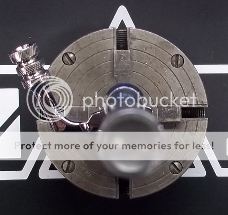

If one is talented & replicated GlassBolt System with a dremel, it would be close to 12 hours & that's if they had by an act of the Lord almighty, just happened upon the perfect process in the right order & instinctively knew the custom precision measuring equipment needed to maintain consistancy being as these bolts/carriers differ greatly in their proportions from unit to unit. That's why a CNC program will not deliver consistent wall thickness to guarantee bolt strength on every unit, because at times, even the cavity in the bolt's body differs in size slightly unit to unit
That being said, I would be especially interested in seeing anybody come close to IceRack's perfection with a dremel.
I have only seen one instance of anybody, (a hobbyist with fabrication experience), come close, and he did not use a dremil.
People who try to IceRack with a dremel usually make a really big mess for me, then send it, at which point I end up cursing their name while wishing they'd just had me do it in the first place, because it's so wavy & pitted that it's twice the work for me than if they'd never touched it to begin with. (yet i still charge the same)
Some out there Jewel to cover up imperfections, tool marks & pitting. This is an old trick to save time & has been used forever. I actually back-peddle & mess-up my perfect finish when I jewel the side.
But seriously, anybody... This is an open call & I encourage all to participate If they think they can do better or match. Please, step in the ring & back it up with evidence, engineering & sound rationale behind the method rather than just talking.
Please use a decent camera up close & don't use blurry photos to hide tool marks & pits..

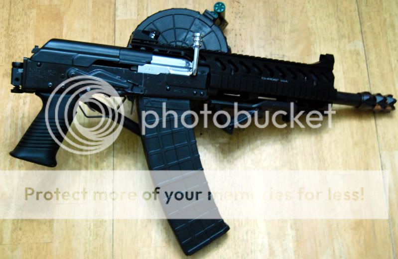

The rifle is going to look quite similar to this when done;
Now, I could have made one on my mill, but to spend a couple hundred & have it delivered as I spent the rare days I take off, drinking Belvedere's fine Polish Vodka on a 26' Monterey on the Columbia river was more appealing to me.
I guess it's just a matter of preference.

I'll agree with the above, don't get wild with metal removal!!!  Those parts were built that way for a reason!  Take too much off and you could get a weapon that will either break, or break you.
With my carrier and hammer face, I only stoned them down to remove the original machining marks/finish, and the scratch along the bottom.  I may have done it the hard way using my 3/8 x 3/8 Arkansas stick and flat stone.  In the pics, I could do a little more yet, as I haven't fully gone to the true bottom of the machine marks.  But the action with this little amount of material removal was noticeably smoother.  The hammer streak is actually more polished than the rest.
Hammer face (area by spring was not polished)
http://i1336.photobu...zpsd011adb9.jpg
Carrier (actual finish is a hazy mirror with some machine marks still present at the rear)
http://i1336.photobu...zps65697ef6.jpg
Arkansas stones will polish as they cut/sharpen.  I think it's a much safer way to do it as you really don't need to take that much off with the stones to get a polished finish.  If you can, try to locate all the stones in a military armorer's tool box.  Well worth the investment!
