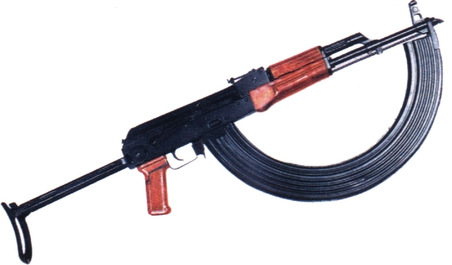

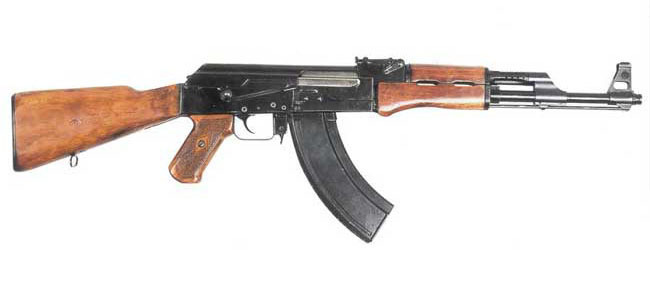

One last question. Is it hard to convert the magwell to accept Hi cap Standard AK mags?
Which one do you want?
"Hi cap"
or
"Standard"

lol,
Those pics are great. Ok so hopefully within the next month I will be converting the saiga myself. Thanks again for all the info!
