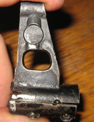

Allot of AKs have canted sights, even some factory Saigas. How bad is it exactly? If it's only a little off you should be able to adjust the front sight post with an adjustment tool to get the sights on target. My 7.62 was canted ever-so-slightly and all I had to do was push the front sight post over about 1mm and it's good to go now.
If it's real bad, and I don't know how it could be, you could try the set-screw method set into a dimple drilled into the barrel under the sight block and stake it on when fully in/flush with the block.
You can also tack weld it. If you ever wanted it off again a little tack-weld shouldn't be easy to grind/drill out.
i would probably have to adjust the front post 3 or 4 mm to the right. Iam going to try to straighten the front sight block out with either a big hammer or wrench later today.
sight block is straight now verified using string from sight leaf to post. Iput the gas block and barrel in the vise and twisted on the front sight post with a wrench and it budged with not too much effort.

Your barrel should measure .571" just behind the FSB. If so, Bulgarian '74 FSB will work fine. I'm not aware of any non-spec 7.62x39 barrels in Saigas, so they should all have this OD.

I used a hand drill, make sure you have a good bit, I went through 3 bits getting those 2 holes drilled.
I never used my vice, just hold the rifle and hammer away in both the removing the original FSB, I sed a wood block and a rubber mallet to attach the bulgarian FSB as to not damage the FSB or the crown.

The "dimples" used to attach the FSB...as delivered.....go into pre-made "holes" in the barrel. See the first couple of pics of this thread. By chance.....did anyone here measure how "deep" these holes are??? I am doing something similar, but related to pinning-on a new Brake without threads...so I'd like to know the safe depth that the factory used in the first place.

When I was doing my swap, I found that Harbor Freight sells metric bits for around $2-something a pack (two of each size from 0.5 to 3mm in steps of 0.5mm). I ended up using these since metric bits were nowhere to be found anywhere else. For cheap bits they did the job reasonably well (went through 3 bits to drill both holes, so about $5). After drilling out the block, the original 3mm pins were too tight, as they weren't going in with the amount of force that I was willing to pound them with. So, I cut the sharpened portion off of the bits that I used, and pounded those (solid sections) in. Even that required a heck of a beating, but at least these went in. After that I just trimmed them to remove the excess. Here's the result:
