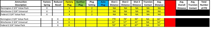

Bridis 319 Posted October 5, 2010 Author Report Share Posted October 5, 2010 (edited) Sumsky and I were talking about doing a more in depth plug test that would include a V plug. Check out these variables... Bone stock S-12, converted S12 with only bolt work and a converted S-12 with gas and bolt work. But the fun wouldn't stop there. Oh no... Then bring in the Factory Plug, GunFixer, T.A.R.G.E.T. and the V Plug to be tested with all three guns. It will be the Super Bowel of plugs. Before the Super Bowel. What do ya think? Edited October 5, 2010 by Bridis Quote Link to post Share on other sites
454496 71 Posted October 5, 2010 Report Share Posted October 5, 2010 Brad, Do me a favor, adjust the spring 1/2 turn at a time until you get it to cycle winchester or fed.. then back of 1/4 turn until you get a FTE then forward 1/8th until then you should have the sweet spot for your gun. Let me know Thanks. Oh if you could use the factory front spring and a stick mag.. That is how I adjusted my plug and it worked perfectly. But all the plugs have worked on my S12. Quote Link to post Share on other sites
kmoore 3 Posted October 5, 2010 Report Share Posted October 5, 2010 Today Sumsky and I did some more testing with my Saiga 12 to determine whether or not the gun was under/over gassed. I think that you will be able to tell form this video that my gun is not under gassed. http://www.youtube.com/watch?v=VP0-9Q3S_-Y Hey, I've followed this thread, and was surprised to see these work, as I thought they didn't in your original test report. Maybe I've missed something? I hacked out all but the relevant parts of your original data to focus my question. Also, I'm an data analyst, so the numbers always stick with me more than the vids, barely watched most ... would rather read the numbers Anyways, it looks like the cheap ammo didn't cycle with the factory spring, only with the reduced spring? Quote Link to post Share on other sites
Bridis 319 Posted October 5, 2010 Author Report Share Posted October 5, 2010 (edited) Since we couldn't get the Auto Plug to reliably cycle low brass with the factory front spring we didn't do much testing, nor did we document any testing in that report. N/A = Not Applicable. I'm not sure what your question is, because you really didn't ask one. You put a ? at the end of a statement. But I encourage you to go over my report and pose your question . Because the testing in the video above is not represented on my test report, but does support the testing done with the reduced recoil spring. BTW, the videos were posted to support the other information being presented in this testing. Not watching the videos is like getting half the info. I'm sure, as "an data analyst" you can understand how overlooking half the information could possibly lead you to incorrect conclusions. Edited October 5, 2010 by Bridis Quote Link to post Share on other sites

Bridis 319 Posted November 6, 2010 Author Report Share Posted November 6, 2010 I don't have the Video yet to show it, but Auto Plug testing went really well today. I adjusted the tension screw as recommended by TAC 47 and was able to cycle everything really well. Even better than the Gunfixer. I was able to consistently cycle the Winchester Universal with the Auto Plug, which always gave me problems with the Gunfixer. However, there is still a big "but" here. BUT I didn't do any testing with high brass. My fear is that I may have had to adjust the tension screw to the point where high brass rounds will do more than normal damage to my gun. Though previous testing does show the Auto Plug does less damage with high brass. Either way I'm happy that it works. More testing to come... 1 Quote Link to post Share on other sites
