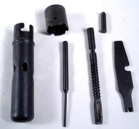

The Texas AK Triggers FCG is modeled after actual military FCGs (unlike the Tapco).
Do you have a cleaning kit like this?
If so, the little ¾" steel pin is there to hold the trigger and disconnecter together for reassembly while in the field.
It is pushed out when you insert the pivot pin.
(y'all know y'all was wonderin' what that that little pin was for)
I had a cleaning kit like that with the capture pin, but don't anymore. I fabricated one from one of the old Saiga rear pivot pins.
