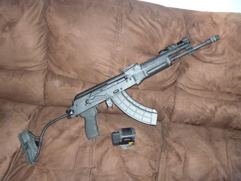

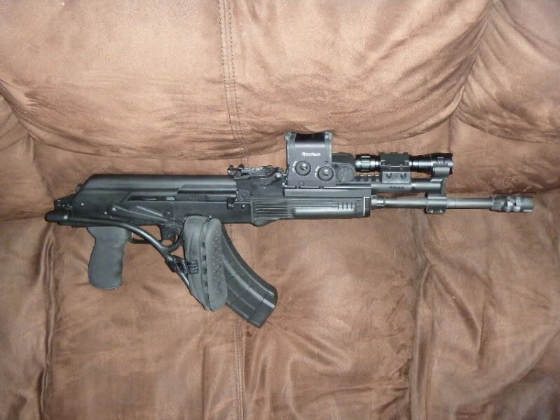

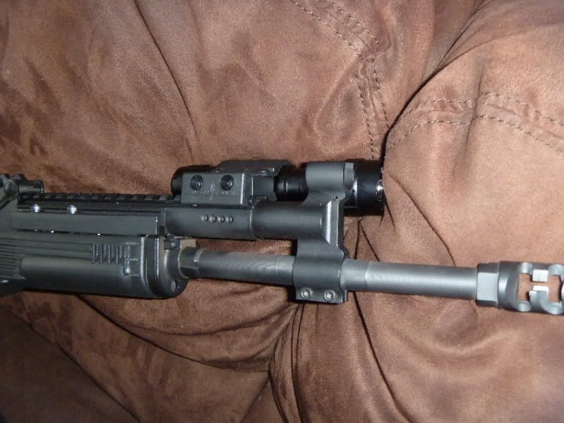

evi1joe 1 Posted December 15, 2010 Author Report Share Posted December 15, 2010 The v-tac light mount is too high (even though I can see the top 1/5th of the sight post), so it looks like I'll have to spend the $$ for a vltor offset. pics--> Quote Link to post Share on other sites
stnls1911 55 Posted December 15, 2010 Report Share Posted December 15, 2010 jflow, what buttstock are you using? BTW, that is a nice Arsenal you have Quote Link to post Share on other sites
evi1joe 1 Posted December 15, 2010 Author Report Share Posted December 15, 2010 (edited) It's just a bulgarian (romanian?) push-button...with the US Made grenade-launcher-copy recoil pad on it--though it isn't necessary; the FSC47 and the wire stock absorb all the recoil. I'm going to put tubing OR 550 paracord on the wire-folder soon....though I have the cheek-piece wire mount as well--not sure if I'm going to use it or sell it. I tried to site her in at 100yds yesterday, but using various ammo and other issues kept me at a 6-8" group. I'd like to get that down to a 3-4" group. Anyone know how low or high I'd be at 10, 25, and 50yrds with a 100yd zero? NOTE: I recognize that the Eotech looks giant and silly up there--but I love the reticle and prefer it to the standard T1...will be moving it back to just behind the rear-sight base when I get the new Gen II TWS dog-leg. Edited December 15, 2010 by jflow25@gmail.com Quote Link to post Share on other sites
stnls1911 55 Posted December 15, 2010 Report Share Posted December 15, 2010 Should be pretty close if you sight in following this link http://forum.saiga-12.com/index.php?showtopic=60165 Hope this helps. Quote Link to post Share on other sites
bohound 281 Posted December 16, 2010 Report Share Posted December 16, 2010 Stunning work. I'm sold... Can I buy the Bolten gas block/sight combo and have my gunsmith do the work? I'd have to cut down 2" and attach the flash hider permanently, but that is a nice setup. Quote Link to post Share on other sites
evi1joe 1 Posted December 16, 2010 Author Report Share Posted December 16, 2010 (edited) Yeah, I've seen the bolton gas-block or similar ones sold online. Fuller cut it down and did the perm-attached muzzle-brake as well. It really lightened up the front end (and as soon as I move the Eotech XPS back a bit, it'll be even lighter and faster). My only complaint is the lack of a cheek-weld, BUT I've heard tubing or paracord wrapping helps...and I do have a wire-cheek-piece that would help. It was evidently a bit gassy, so he put the holes in the ultimak...either way, it now shoots as soft or softer than my AR (which definitely had more muzzle-blast from what I could tell from sitting next to both of them with the spotting scope while my friend shot). Edited December 16, 2010 by jflow25@gmail.com Quote Link to post Share on other sites

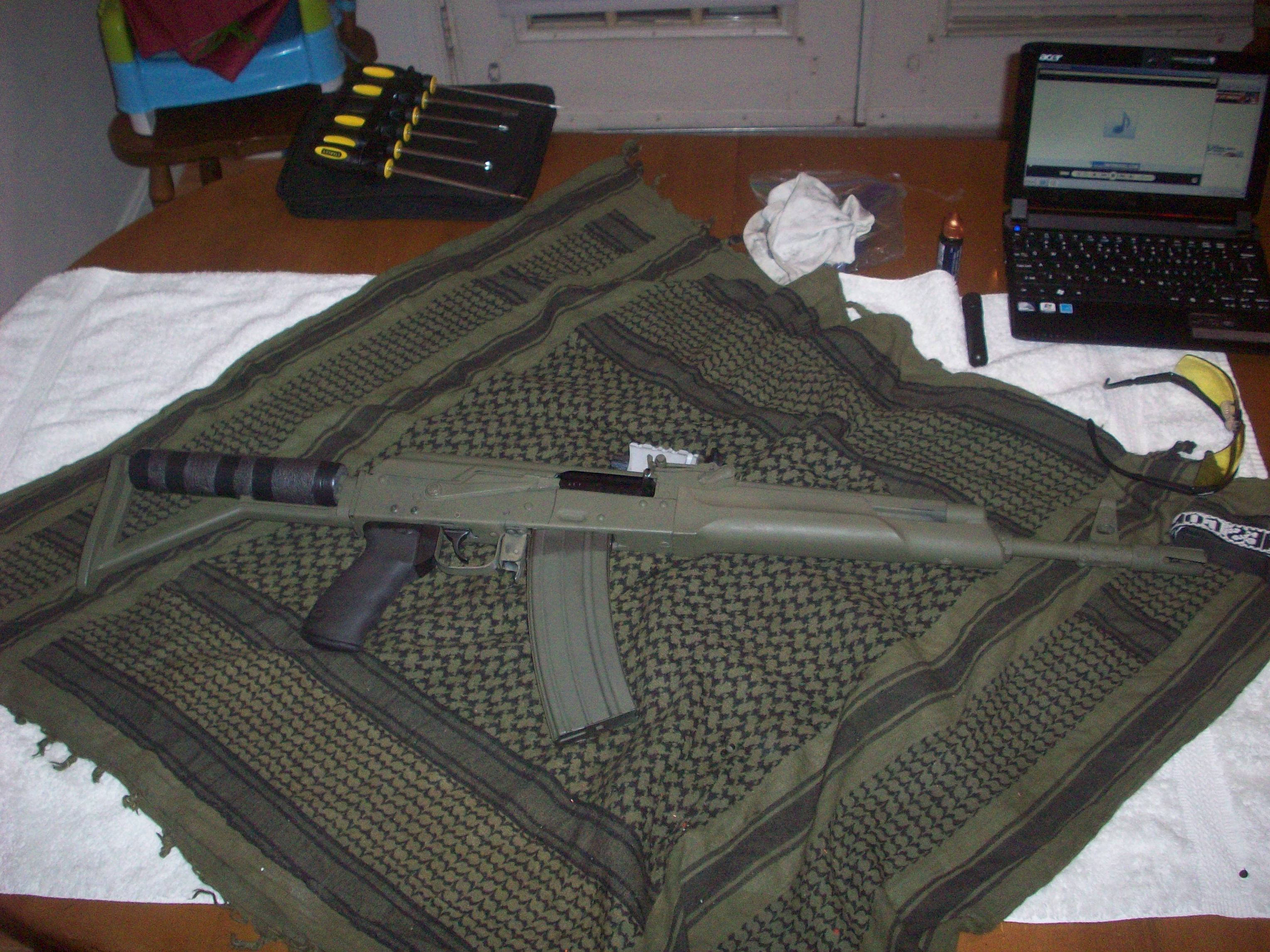

stnls1911 55 Posted December 16, 2010 Report Share Posted December 16, 2010 bohound, did you duracoat your Saiga?? It looks good That's a good idea with the pipe insulation!! Quote Link to post Share on other sites
bohound 281 Posted December 16, 2010 Report Share Posted December 16, 2010 bohound, did you duracoat your Saiga?? It looks good That's a good idea with the pipe insulation!! Thanks. Not yet, I'm waiting to do this gunsmith work, (why I'm trying to find this sight/gas block) then blast the whole thing, and then duracoat. This is OD Krylon Camoflage paint, $4.44, also from Wally world. I wanted to see what a solid color looked like vs. a pattern. Quote Link to post Share on other sites
