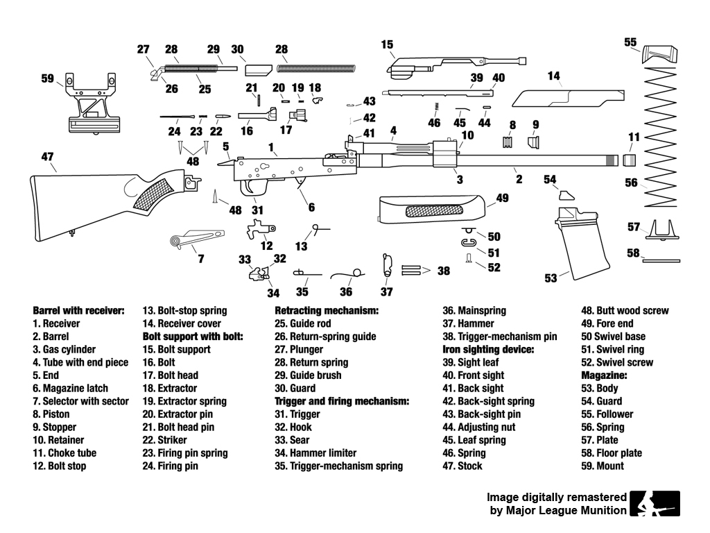

mr300zhb 0 Posted February 11, 2011 Report Share Posted February 11, 2011 Hey Guys, I bought my Saiga 12 a few months ago, first time shooting at my ranch the spring on the bolt stop came unseated and was keeping the bolt open, no matter what I did. I ended up getting the dust cover off but I couldn't get the spring seated, so I cut the bolt stop out with a dremel because I REALLY wanted to shoot the gun. NOW I regret it because I have no way to keep the bolt open. I've thought about buying the enhanced safety lever to replace the function of the bolt stop but figured I'd post here first. Does anyone have a parts gun that they would be willing to sell me the bolt stop out of? Or does anyone know if anyone sells a replacement? The part is # 12 on this schematic: Quote Link to post Share on other sites

fauxknight 30 Posted February 11, 2011 Report Share Posted February 11, 2011 Take your dremel and notch where the spring lies on the tab sticking out of hte BHO so that the spring doesn't pop off. Quote Link to post Share on other sites
mr300zhb 0 Posted February 11, 2011 Author Report Share Posted February 11, 2011 Thanks! I think I had seen this previously but they are always out of stock. I guess I will order it and hope for the best. I ended up buying a Krebs custom safety lever. Quote Link to post Share on other sites
