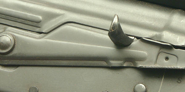

Bean.223 365 Posted April 29, 2011 Report Share Posted April 29, 2011 Are you loading it with the bolt open or closed?^ I'm loading it with the bolt closed. Like I do all my other magazines. Is it suppose to be open? OH YEA!! King is right, on the right side of the trigger you should see a small metal tab, thats the bolt hold open tab. Pull that muther back hold down the tab and while holding the tab let the bolt slide forward. There are peeps on here that mod their bolts so that they can be loaded closed. Quote Link to post Share on other sites

Bean.223 365 Posted May 1, 2011 Report Share Posted May 1, 2011 Here is the tab to which I refer, if your missing this than you dont have a bolt hold open at all, I'd do what the above post suggested. Quote Link to post Share on other sites
schultze13 354 Posted May 1, 2011 Report Share Posted May 1, 2011 (edited) Did you convert you gun yourself or is it stock. Some early S-12's didn't have the BHO if your gun is stock than this may be the reason and if you bought your gun already converted some guys who convert them and don't know what they are doing cant get the BHO back in with the new FCG cause the FCG need to be modified so they don't put it back in so if you have a slot in your reciever and no tab this could be what happened and why you don't have one. Also to help load on a closed bolt I recommend getting your BCG polished and getting the bolt modified to help load on a closed bolt, Cobra or Pauly on here can do it for you at a good price. I would also like to add that if I insert the front of my drum in the magwell and rock it back slowly it sometimes doesn't lock up with out a little extra help but if when rocking it back I slam it home it load perfectly everytime. Edited May 1, 2011 by SCHULTZE Quote Link to post Share on other sites
