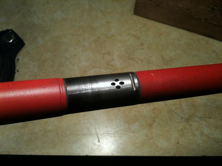

utstrat03 0 Posted November 5, 2011 Report Share Posted November 5, 2011 I just received my first Saiga 12. I purchased it from Century Arms. The quality stamp is dated May 2011. I was looking at the gas port so I only noticed 2 holes. I figured maybe they were hiding under the gas block. So I removed the gas block and there is definitely two holes. Does this sound like it needs additional gas ports to run the low brass ammo? Quote Link to post Share on other sites

haugpatr 972 Posted November 5, 2011 Report Share Posted November 5, 2011 You need to determine the diameter of the two ports that are there, did you test fire the gun? Quote Link to post Share on other sites
saiga 12 power 31 Posted November 5, 2011 Report Share Posted November 5, 2011 Somebody feel asleep at the barrel porting station Quote Link to post Share on other sites
utstrat03 0 Posted November 5, 2011 Author Report Share Posted November 5, 2011 Haven't had a chance to test fire the gun yet. Well with low brass ammo. What is an acceptable size for the hole I do not have a pair of calipers but I could use punches or drill bits to determine rough estimate of hole diameter. Quote Link to post Share on other sites

jdtravers 637 Posted November 5, 2011 Report Share Posted November 5, 2011 Yeah, looks like they machined the ports for a 24" barrel on a 19". Quote Link to post Share on other sites
utstrat03 0 Posted November 5, 2011 Author Report Share Posted November 5, 2011 I would probably say the holes are ..09 of an inch. A 5/64 bit still has some play. A 3/32 bit seems like almost go in the hole.but won't. Quote Link to post Share on other sites
ChileRelleno 7,074 Posted November 5, 2011 Report Share Posted November 5, 2011 IIRC, three (3) port gun's ports are usually 3/32"... So those would be too small for a 19" barrel. Quote Link to post Share on other sites

Paulyski 2,227 Posted November 6, 2011 Report Share Posted November 6, 2011 I would probably say the holes are ..09 of an inch. A 5/64 bit still has some play. A 3/32 bit seems like almost go in the hole.but won't. Sounds like they're about the right size, just missing 1. Quote Link to post Share on other sites
evlblkwpnz 3,419 Posted November 6, 2011 Report Share Posted November 6, 2011 (edited) I wouldn't even bother trying to test fire with low power loads with just two ports on a 19". Neither of my 24" guns would run Federal with 2 ports, so at 19" you will likely just be wasting gas, money, and time. I would add 2 more at that same size and give it a thorough reprofile and polish in all of the right spots. Just my opinion.... Yeah, it looks like someone may have gotten shitfaced and went home halfway through porting the barrel. here are 4 ports at .080". Your ports look smaller. More like .070", but I could certainly be wrong. Edited November 6, 2011 by evlblkwpnz Quote Link to post Share on other sites

SICARIO 26 Posted November 7, 2011 Report Share Posted November 7, 2011 A friend of mine brought me his saiga with only two ports. He was stove piping almost every other shot. I tore the gas block off, enlarged the existing holes to 3/32, and added one more. Fixed the problem. That's what I'd do. 1 Quote Link to post Share on other sites

utstrat03 0 Posted November 7, 2011 Author Report Share Posted November 7, 2011 Ok so I got a chance to fire with low brass ammo. I mentioned in a previous post that I did not fire previously to that point with low brass ammo. However I had ran about 50 rds of buck shot through it at that particular point. The gas ports are definitely bigger than .078 of an inch. I ran anotther 30 rds of buckshot and slugs through it before firing any low brass. Playing kick the can with a 5 gallon bucket and buckshot is alot of fun I might add. I tired a stock setup with puck and plug no cycling of low brass. I purchased a low brass reliability kit from CSS and with the puck and the md V plug it would cycle the low brass ammo once I backed the plug 10 clicks from bottom out postion.. At 5 clicks no cycling. It ran 80 rounds of 1 1/8 oz federal 7 1/2 shot through like a champ no fte at 10 out. My only concern is that this may damage the theards on the gas block over time. I inspected the threads on the plug and block and everything looks fine so far. When you guys are adding a 3rd gas port hole are you drilling at an angle or drilling straight down. Quote Link to post Share on other sites

Sergii 142 Posted November 7, 2011 Report Share Posted November 7, 2011 (edited) Worker fell asleep during the operation There is another option to improve the work automation. You can set a short gas piston. I use a 7mm piston. This is easier than increasing the gas ports. Edited November 7, 2011 by Sergii Quote Link to post Share on other sites
