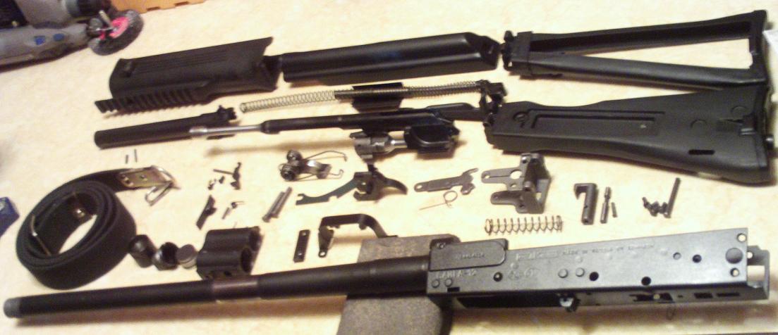

You TORE the gun apart before firing it?
You DO know you porked your warranty, killed any baseline information and......well, most folks wouldn't have done that.
I mean, WTF?
This is what happens to brand new Saiga 12s around here....
Warranty schmarranty..... I have never owned one that ran good out of the box (out of 6) and I have never sent one back for warranty work, but they do end up running great. I've never had any good luck sending things out and have learned that I am better off on my own. Shit ends up looking nicer anyways. YMMV

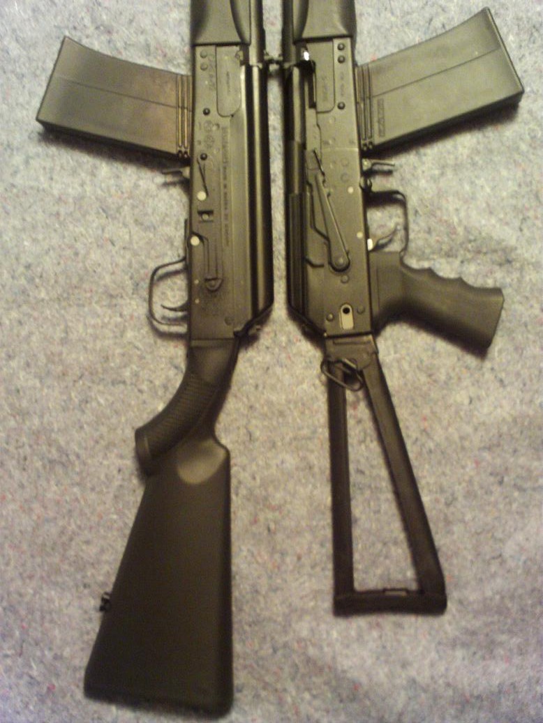

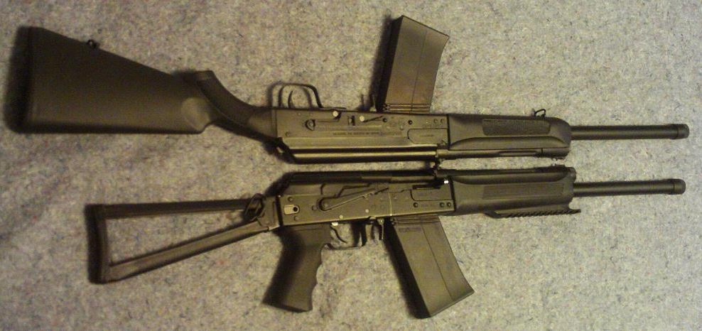

What type of paint is that on the receiver? I was thinking about making my light gray as well when I do the conversion.
Rustoleum Professional Series High Performance enamel (Semi-gloss black). Apply a few light coats while holding the nozzle about 20-24" away and do them 45 minutes apart. It looks really close to factory when done, but looks slightly shinier. I haven't tried the flat black yet. I have a feeling that it will be too flat. this is good paint and it is pretty tough if the receiver is properly prepped and cleaned.
Here is a good pic of that same weapon beside a bone-stock brand new S12. It is all in the technique.... keep the can far away and do multiple thin coats.
