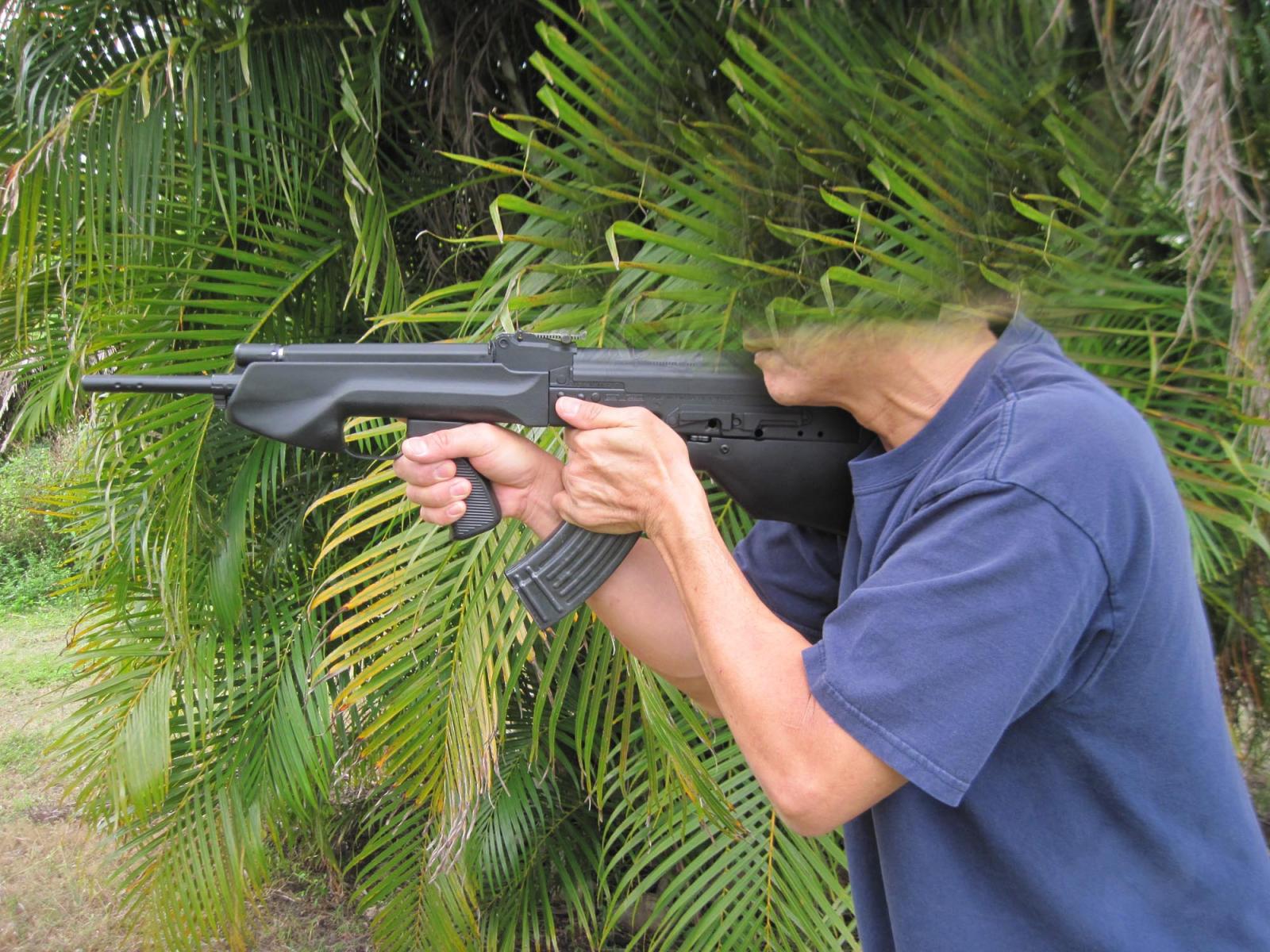

Sumsky 115 Posted January 7, 2012 Report Share Posted January 7, 2012 (edited) I built a drop in Trigger using the old Trigger, Trigger Pin and stock Spring when I did the conversion. I decided to use the cable system to activate the Trigger mechanism, Grip is from a Yugoslavian M70. I still need to test fire, which I will do once I press this stubborn Gas Block back on. Everything test fit together fine, Trigger works fine, and pull is very smoothe, and surprisingly very light. At first the Gun felt very heavy, even without the magazine inserted, so I weighed it with a empty 30 round Mag and it weighed in at a exactly 7 1/2 lbs, It felt way heavier. Trigger length of pull is 15 1/2. I love the feel of this pup, it feels perfectly balanced as far as weight distribution , maybe because everything is so close to my body Edited January 14, 2012 by Sumsky 7 Quote Link to post Share on other sites

Sumsky 115 Posted January 7, 2012 Author Report Share Posted January 7, 2012 Pics of how the rifle sits in the ready position. I am 5' 7" tall. Love the feel, its perfect. 1 Quote Link to post Share on other sites
Nailbomb 10,221 Posted January 7, 2012 Report Share Posted January 7, 2012 (edited) Very nicely executed thus far. I'm honestly impressed. I love what you did with the front handguard. Keep us updated, I'm interested in what you do for sights. That is a modified stock handguard correct? Are you worried about the heat at all? they are notorious for melting during rapid fire. Edited January 7, 2012 by Nailbomb spelling Quote Link to post Share on other sites
Sumsky 115 Posted January 7, 2012 Author Report Share Posted January 7, 2012 Very nicely executed thus far. I'm honestly impressed. I love what you did with the front handguard. Keep us updated, I'm interested in what you do for sights. That is a modified stock handguard correct? Are you worried about the heat at all? they are notorious for melting during rapid fire. Yes the Handguard is a modified Stock Handguard, if it starts to melt I will just put a Aluminum shield inside the Handguard, not a problem. Quote Link to post Share on other sites

BpS12 512 Posted January 8, 2012 Report Share Posted January 8, 2012 Very nice. I really like that forend and the trigger is a good idea. Question, how are you for 922r? Quote Link to post Share on other sites
Sumsky 115 Posted January 8, 2012 Author Report Share Posted January 8, 2012 (edited) Very nice. I really like that forend and the trigger is a good idea. Question, how are you for 922r? US FCG, and US Magazine brings me to the correct number of parts. I am going to cut a US Trigger and use it for my drop in once everything is final. I still have to do the Camo Paint job, so I dont want to install the Trigger mechanism as yet. Edited January 8, 2012 by Sumsky 1 Quote Link to post Share on other sites

Sumsky 115 Posted January 8, 2012 Author Report Share Posted January 8, 2012 (edited) Now this I like, it is very stylish... Look forward to seeing it complete with sights. Is that you buttstock too? What did you use to build up the forearm? Yes, I cut and modified a Buttstock also, I still have to notch a small opening for the Bolt Hold Open lever. The hand guard was contoured to the way my hand naturally fits on the front. I used Wood, Golf Club Epoxy and Bondo, secured by a Nut and Bolt, through the Trig Guard up into the Handguard. Why Golf Club Epoxy, because it stands up to direct torching to remove Golf Club Heads. 5'7" tall with or without your cranium?? LOL with the Cranium. Edited January 8, 2012 by Sumsky Quote Link to post Share on other sites

The Glorious Tachikoma 1 Posted January 8, 2012 Report Share Posted January 8, 2012 It looks much cleaner than the KVar/Century bullpup kit, and isn't a mall-ninja POS like the CBRPS chassis'. I have a couple suggestions though: -Rails: As the forearm is decidedly proprietary you need to modify it to have some mounting points for rail segments, especially to mount a VFG seeing as how your grip involves touching the barrel. -Sights: Arguably this is one of the few places where a scoutscope mount would *not* suck in terms of cheekweld, and Ultimaks cook EOtechs and Aimpoint clones. Additionally, people my like having BUIS. I think that perhaps an Ultimak with a long rail that cantilevers back over the rear sight and extends forward, maybe anchoring to the original front sight post. -Reinforced dust cover: Peeps are worried about bullpups and kabooms next to their melons. The AUG uses a thick layer of plastic. The RFB has 2mm of steel. You need a way of protecting the user from potential out of battery detonations. Perhaps a dust cover with a few layers of kevlar weave epoxied on top, or something similar. Quote Link to post Share on other sites
