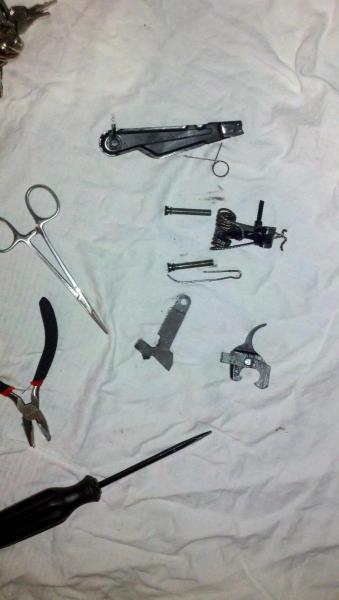

Robocarullo 0 Posted February 4, 2012 Report Share Posted February 4, 2012 (edited) My trip to the range was cut short yesterday. After making it through 1 25rd box of Rem reduced recoil 00 buck I locked the bolt back and it got stuck. The bho did not dissapear inside the reciever the button just stayed half pushed up and the bolt would not release. When I got home I managed to get the Titan/dust cover removed. I then got the bho back down by pulling it with a pair of small rubber tipped pliers. Using some force I can manually move the bho lever up and down but clearly the spring is not engaged but there is a lot of friction. Is there normally a lot of friction here? I assume no but it can't hurt to ask. Next steps are gonna be a full takedown and notch for the bho spring. I guess I'll see if there is anything else is wrong in there. I did some searches and it looks like most people have a different bho problem than this if anyone has any advice for this specific problem I would love to hear it. Edited February 4, 2012 by Robocarullo Quote Link to post Share on other sites

Robocarullo 0 Posted February 4, 2012 Author Report Share Posted February 4, 2012 (edited) Does it have a factory hammer? Can you post a few pics? I'll get pics up asap. The FCG is a Tromix g2 single hook. Edited February 4, 2012 by Robocarullo Quote Link to post Share on other sites
evlblkwpnz 3,419 Posted February 4, 2012 Report Share Posted February 4, 2012 Does it have a factory hammer? Can you post a few pics? I'll get pics up asap. The FCG is a Tromix g2 single hook. Take out the Tromix and measure it from side to side where the axis pin goes through it. Do the same with the factory hammer, if you still have it. Post the measurements. Quote Link to post Share on other sites
Robocarullo 0 Posted February 4, 2012 Author Report Share Posted February 4, 2012 Here are the pics. I won't have time to take it apart until tonight. Thanks for the replies guys. Quote Link to post Share on other sites

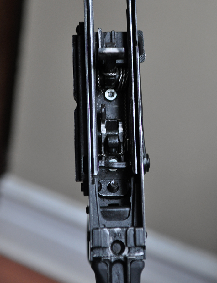

theKobudera 1 Posted February 6, 2012 Report Share Posted February 6, 2012 I can't tell from your photos, but if you have a MD Arms Molot-style pistol grip, check to make sure it's not getting hung up there. My BHO was getting stuck every now & then and the reason was that grip was just slightly too large & snagged the BHO. I dremeled out just a tiny section near the BHO & now it works flawlessly. Quote Link to post Share on other sites
Robocarullo 0 Posted February 6, 2012 Author Report Share Posted February 6, 2012 I do indeed have an MD Molot installed. I'll check it out after work thanks! Quote Link to post Share on other sites
theKobudera 1 Posted February 6, 2012 Report Share Posted February 6, 2012 It should be fairly obvious by looking at the BHO slot with the pistol grip installed & the internal parts removed. That was a HUGE headache for me until I realized the problem. Good luck. Hope that was it because it's a pretty easy fix. Quote Link to post Share on other sites
Robocarullo 0 Posted February 11, 2012 Author Report Share Posted February 11, 2012 Sure enough it was that damn grip! You can see where it was rubbing the grip in the picture below. A few minutes with some 320 wet dry did the job. She is working just fine now. Thanks for the tips everyone! Quote Link to post Share on other sites

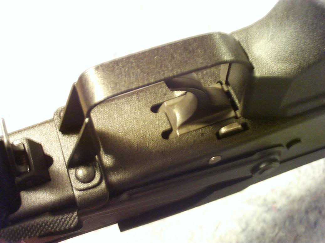

evlblkwpnz 3,419 Posted February 11, 2012 Report Share Posted February 11, 2012 I can't tell from your photos, but if you have a MD Arms Molot-style pistol grip, check to make sure it's not getting hung up there. My BHO was getting stuck every now & then and the reason was that grip was just slightly too large & snagged the BHO. I dremeled out just a tiny section near the BHO & now it works flawlessly. Here is a better mod for that and it allows easier access to the BHO with the side of the index finger. Done on a belt sander (benchtop type). Quote Link to post Share on other sites
Robocarullo 0 Posted February 12, 2012 Author Report Share Posted February 12, 2012 Nice. Mine is close to that but not quite that angled. I'll sre how she feels next time Im at the range and make adjustments accordingly. Thanks for the pics. Quote Link to post Share on other sites
evlblkwpnz 3,419 Posted February 12, 2012 Report Share Posted February 12, 2012 Sure enough it was that damn grip! You can see where it was rubbing the grip in the picture below. A few minutes with some 320 wet dry did the job. She is working just fine now. Thanks for the tips everyone! What type of trigger guard are you using? Quote Link to post Share on other sites
