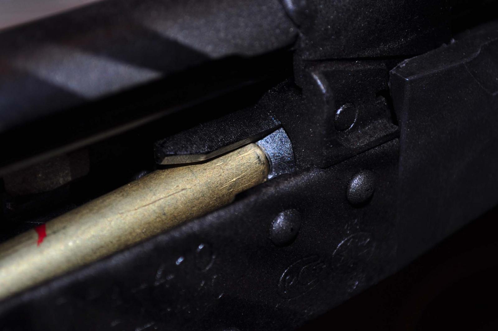

pics of jam
This is with the 4rd. stock mag
With a little more time last night, and a lot cooler head I was able to find out that the last 2rd's in the 4rd mag would cycle. To me that seems to indicate that I may need to shave down the follower, and try to get the angle just right. I also noted that where the round sits in the mag on the sgm's is much lower and the notch at the rear of the mag is nowhere near as deep as the Russian mags. Probably putting some wear on the spring in the mag wouldn't hurt either.
With all that said it's still a little bizzare to me that chambering a round in this gun is that far off from the factory, and that tolerences aren't a little tighter for guiding the round into the chamber.
Take a look and let me know if you have any ideas, but it looks like it's time to take the drummel to the mags, and see whats what.

Looks as if it hanging on the extractor ramp, file it on the inside of the barrel, just a little bit till the shell dont hang.

Be DAMN careful stoning the ejector ramp. If you look a the closed bolt you will see that there is already a LOT of unsupported shell there.

On the bolt there is a "hook" that will grab the rim of the shell to pull it out of the chamber it is called the "extractor".
The ramp is where that hook rides as the bolt goes into the barrel or to "battey" as it is called.
The edge of the ramp is very sharp on a new firearm of this type, my S12 had the same issue.
Give that area a close look and let us know.
If you find that is a issue, file it a "very little" at a time till it if fixed, mine took 2 times to get it to not cut or jamb.
DO NOT TOUCH THE HOOK (EXTRACTOR) leave it alone.

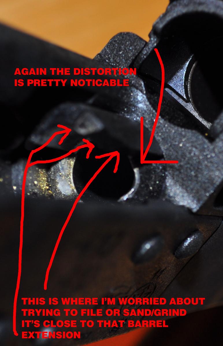

Right. I know the extractor on the bolt, and a question for later, how do you take the bolt apart... I remember my old M16A2... Now, there is an area on the breech, barrel end,.... where the shell seats... that is reduced back very slightly for that extractor to catch the edge of the shell. that is visible in the photos, and there is no damage to the shells in that area. Above that on the edge of the barrel... say 12 o'clock to 2 o'clock is where it is really crushing and dinging up these cartridges.

Yep, file the inside a little at a time where the arrow is pointing till it does not jam.
Your file will be in the chamber, dont nick the chamber.

The rat tail file I have is for auto work. Probably way to course for the task at hand. Don't really want to use the dremel because it tends to pull in the direction it's rotating, and can go to undesired places REAL quick. I think I'll take a look in the store and see if I can find a suitable tool. Any suggestions?
I want to be real clear here, I'm reducing the material where the round is striking, and hanging up, correct? Around 12-2 o'clock if I understand correctly. Is that about right?
Here are more pics because I want to get this right.
