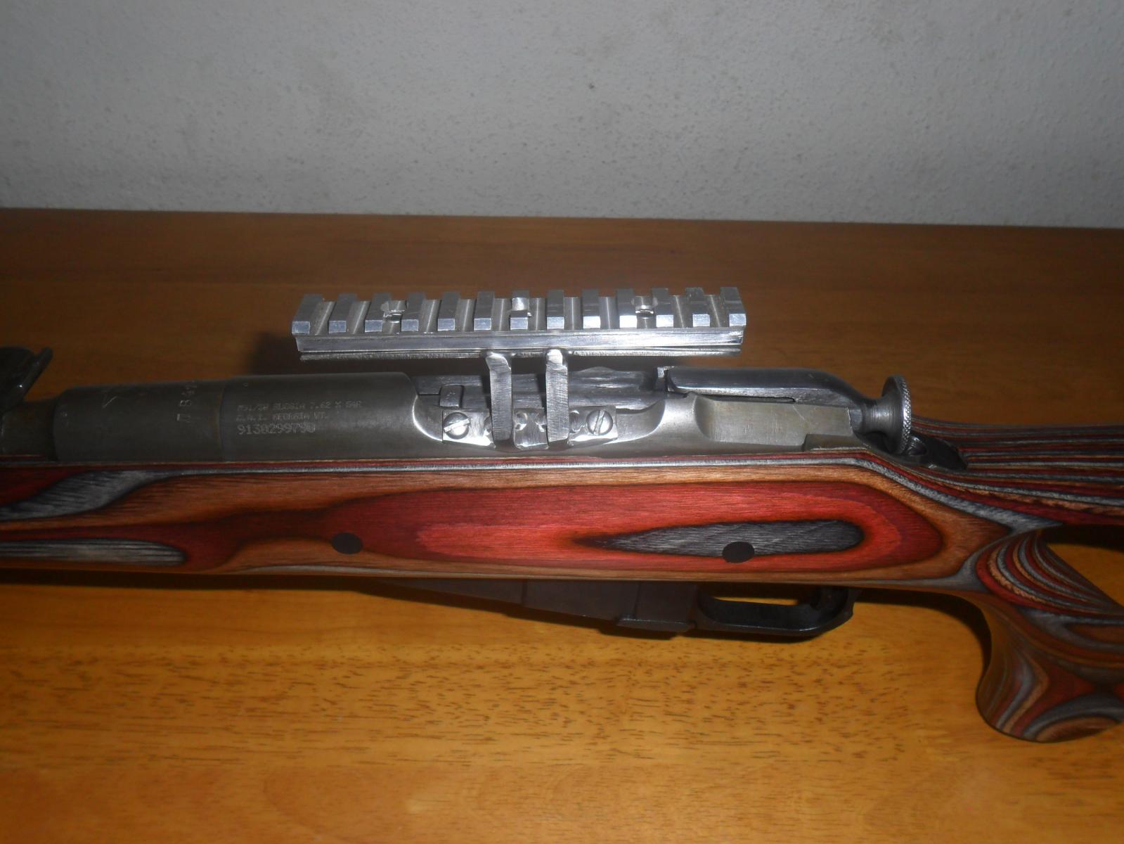

So I'd been wanting a laminate featherwieght thumbhole stock for my Mosin for some time. My ultimate goal is to add a scope and do some acurizing mods. Lighter trigger, float the barrel etc. So I ordered stock from Byods stocks, I really wanted something with the blue hues in in the wood, I think that looks really nice. Unfortunately they don't offer that for the mosin. So I ordered what I found to be the next most attractive which they refered to as the Jacaranda. They told me a 3-4 week back order, which was more than fair. But to my surprise I got a tracking number just 8 days later! If finally arrived it was much nicer than the one on the website.
Fitting it took a about 30 min of filling a few spots, maybe a 0.001". Now I can't wait to get out on the range with it. So without further ado, here's some gun porn. post-32655-0-27324100-1337049408_thumb.jpgpost-32655-0-49286800-1337049444_thumb.jpg

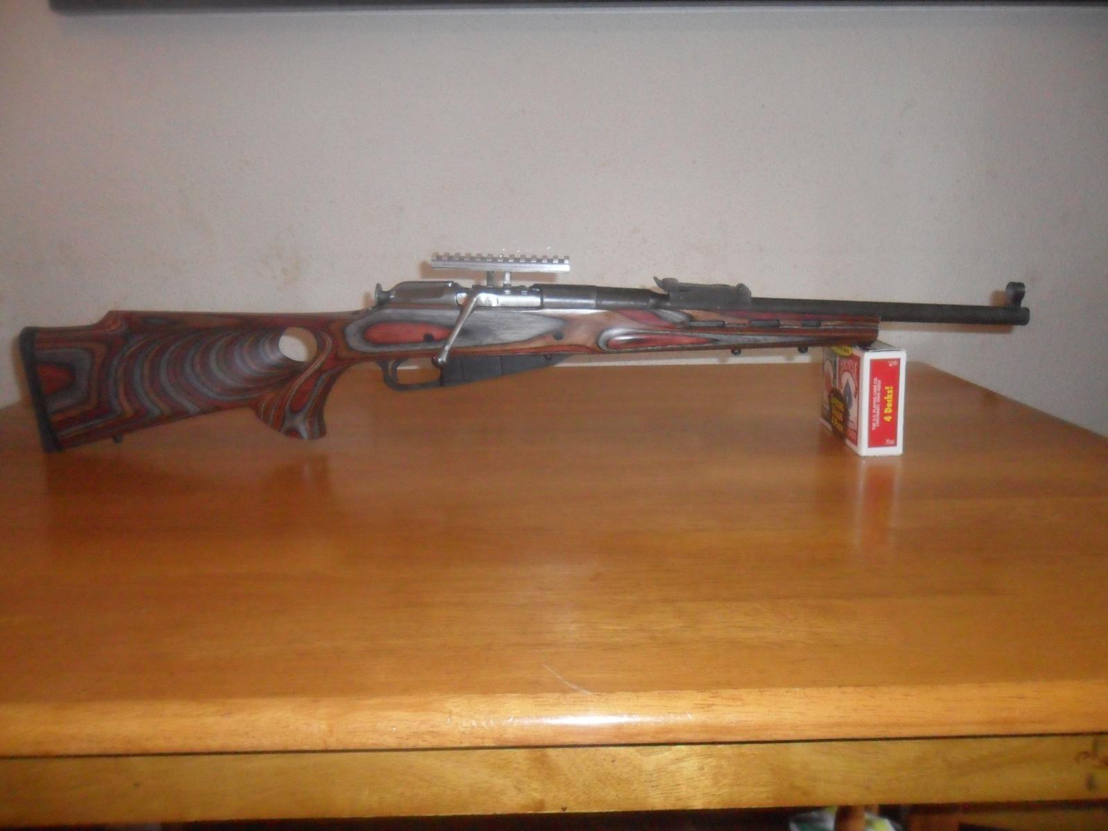

Okay so after much research I decied to chop and recrown with an 11degree target crown. Initally I was only going to cut 2 inches off the barrel where the counter bored ended. Unfortunately the steady rest on my lathe only closed to 1.5" and buying a $70 crowning tool for a $100 rifle seemed extreme. Solution? Eleminate the need for the steady rest. Cut the barrel short enough I could work closely to the chuck to elemenate chatter.
After a few careful mesurments using a TIG rod down the barrle to the bolt face I determined that my barrel was 28.75", where I needed to clamp was right infront of the sight block so that left me 13" to work with...Good thing the barrel extends another 3" behind that! So for safey's sake I cut it at 17 1/4" with a band saw. Chucked her up in the lathe, and ran at about 58 RPM with a No3 Carbide cutting from the bore out to prevent a bur from forming on the I.D of the barrel. Once square cut I repoistioned the cutting tool to 11 degress and again cut from the center out, till I had a nice fat target crown. Then I cranked it up too 300 RPM and did some sanding, then up to 500 rpm for some polishing with machinst scotch brite. (the medium corse red stuff).

Now I haven't done any refinish work on it yet, I just put it together for visual reference on barrel length.
Oh and heres a better look at the crown and sight job. ( I know the welds need blended still)
