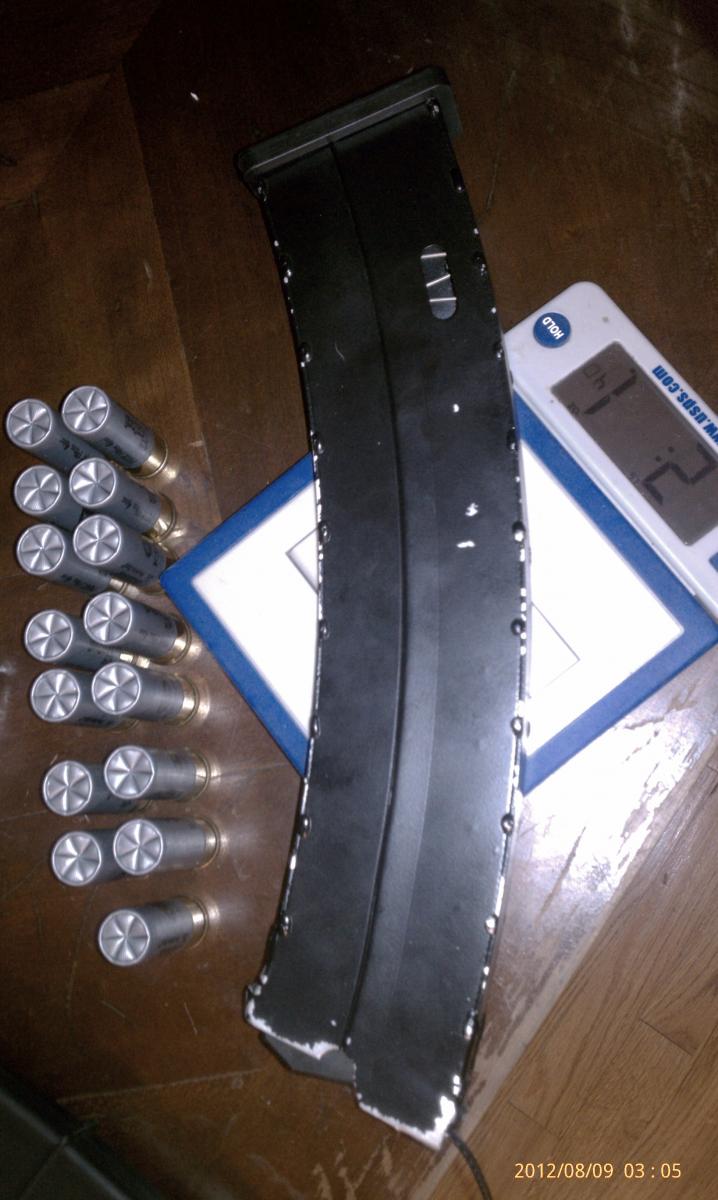

Cobra 76 two 2,677 Posted August 9, 2012 Report Share Posted August 9, 2012 All steel construction = too heavy. (Trust me I know... I have a steel S-12 stick mag. It holds 12-15 rds and weighs over 2 POUNDS EMPTY... & almost 4 lbs full ) A 20 Promag drum weighs just over 4 lbs full BTW. A thin sheet metal stamped body built exactly like an AK 30 rd ribbed mag would be ideal though, and not as heavy. Otherwise a corrugated aluminum = WIN. On 8 vs.10 rd..... Either just make a 10, or make an 8 with an easily added floor plate extension for adding more rounds. (Then offer optional extensions from 2 rds - 10 for the guys who just have to have a donkey dick mag....) Special care def needs to be taken designing the followers.... I'll send ya a PM on part of that..... Obviously need good solid lockup and reinforced lugs, feed lips, FP mounting flanges...etc A good strong spring is critical, and should be coated to prevent rust. Good luck with your venture and don't mind the naysayers. We've seen many threads like this. 2 Quote Link to post Share on other sites
