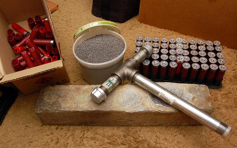

Squishy 1,149 Posted June 20, 2013 Author Report Share Posted June 20, 2013 Well I finally got around to putting my own Kineti-Dump®together today. I put the Bird Slugs on the back burner for a while but now that Saiga-12 #2 is finished I want to run it at the range where I work which only allows slugs. Going back to be beginning this was the reason in the first place for making cheap slugs. A lot has happened since this thread started and while slugs are still available the best pricing I've seen is still around $1 each. And I'd have a hard time spending that much for something to shoot at paper with even if I had the money. Went to Home Depot and picked out 1-10"x3/4", 2-3"x3/4" nipples, three 3/4" caps and a 3/4" tee. Screwed it all together and went to work. Also I found some thick 1" round felt pads for using under furnature to stuff in the cap that covers the nipple end where the shell goes. I stuffed two of them in the cap secured (hopefully) by Super Glue. Ended up evacuating 100 shells mostly Federal "Multi-Purpose Load" - 1 1/8oz - 7 1/2 - 3 Dram Eq. It took 2-3 good whacks to open the crimp up enough to have the shot fall out into the KD. I happened to have a 60lb bar of lead so I used it to beat on. I'd think a piece of thick wood would work too. Something like concrete not so much, would likely fragment. Now all I have to do is open the hulls up some more, slip in the 7/8oz Lee slug and close the crimp. Quote Link to post Share on other sites

Squishy 1,149 Posted June 21, 2013 Author Report Share Posted June 21, 2013 I was being liberal in my estimate of lead cost. The bar I used to beat on with the kinetic hammer weighs 60lbs and I still have wheel weights and ingots I got off eBay so I'll be set for a while. The hammer is so much better/quicker than any other method I've tried for getting the birdshot out of the shells and there is 0 deformation of the hull something I had before that caused FTFs. Quote Link to post Share on other sites
