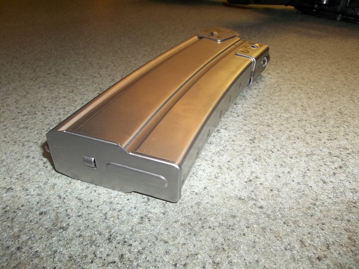

csspecs 1,987 Posted July 16, 2013 Report Share Posted July 16, 2013 Ok here it is. Its still untreated steel no finish or anything. PS until production starts these cost around $300+ each to make, so other than a handful of test models there will be no early sales. Open to questions. 4 Quote Link to post Share on other sites

gunfun 3,931 Posted July 16, 2013 Report Share Posted July 16, 2013 Would it compromise strength to angle the fin at the base so that it easily fares into pouches? Quote Link to post Share on other sites
