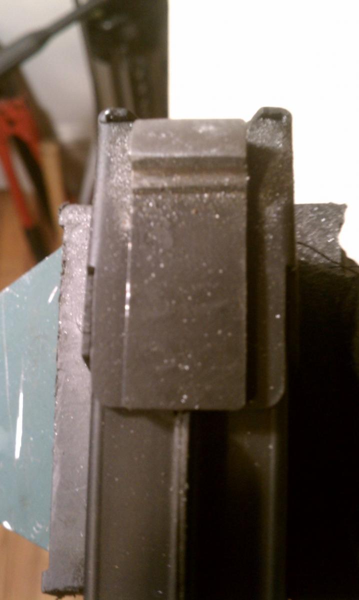

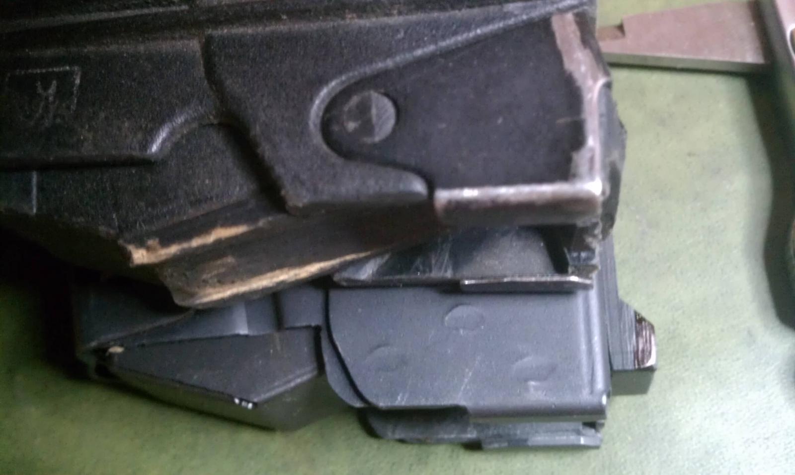

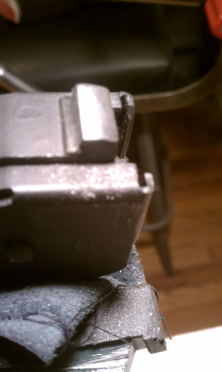

Cobra 76 two 2,678 Posted August 27, 2013 Report Share Posted August 27, 2013 I fixed the lug problem on mine today. Locks in tight and stays locked now. Had to put a separate step in the lug for my 2008 gun I was also using today. It either has a longer mag catch or the receiver opening is cut farther forward. Haven't measured. Was much more easier to test fire though for sure. Still had consistent FTF on #1 and #2, with some more here and there throughout the mag. Today I tested with Fed Multi Purp. . (the 100 packs finally back in stock for birds) and had no FTE's like plagued with on the BS Win loads. To get the mag to go in the 2008 I took just a little off the back edge of the rear lug and rounded / polished it. Seated mag and scribed the bottom of the catch contact point then filed a step there to retain the mag solidly. Worked well. My main gun the 2000 was a little loose fitting at that lockup point so I cut a second step just under the first and deeper. Will come back and edit or post pics of the mod. I still firmly believe this thing needs to be curved more csspecs. I don't know how these other guys are not getting FTF's on the top round or two. I'll test it again with some different guns tomorrow. I have a bunch. It's real obvious though seeing the top two rounds at least, squeezed down tight against the shell underneath at the front edge. I did have slightly better luck with the later model gun but that could be due to the placement of the magwell opening being a slight bit farther forward which would also explain the lockup without mods. In that gun like I shared in my PM, it would lock in on a closed bolt and stay put even if you tried to push it forward and out. Just wasn't enough to stay under recoil until I modded the lug. There are three more things that could be (are) also causing issues. 1. The added length of the feed lips does not allow the shell rims to clear the ends and pop up to feed into chamber, like they might do if the lips were shorter and the exact same length as the 8 rd mag (or 5 rd). Back a few years ago when Phil first sent me the proto 10 rd mags for the 410 to check out, they had the same problem and were not able to feed the 3" shells, but worked great with the shorter ones. After testing I found the 3" shells were getting bound against the feed ramp and could not make the 'bend' to clear it and make their way into the breech. I could see obvious dents and scars in the steel hulled 3" Russian ammo I was using. I shortened the lips to match my factory 10 rd .410 mags... shells were able to clear just in time to pop up and be shoved center chamber... problem solved. The 12 rd mags SGM then came out with had zero issues with the new shorter lips and feed everything. I want to try shortening the lips on this mag to see if that fixes my jamming prob but if I do that the further testing with other guns and high brass will not be an accurate representation of stock mags (as is). 2. Another thing that's missing from these mags vs. the factory 8rdrs (and the 5) is what I refer to as the 'push ramp'. If you look at the inside top of spine on all factory Saiga mags there is a sort of wedge shaped ramp there that pushes the top shell of the column forward about 1/8 - 1/4 inch and sets it there ready for the bolt foot to grab it and shove it home. This part is crucial to the Russian style LRBHO as it moves the shell rim out of the way so the claw or feeler on the forward lever can fit behind it and hit the back of the follower. It also plays a role in placing the shell rim where it's supposed to be when contacted by the bolt, and may even have enough to do with timing of release per the end of feed lips that it makes the split second difference needed to help counter the curvature problem. Which brings me to #3. I spent lots of hours, days, weeks and lots of different ammo experimenting with adjustments to the follower angle, length vs. curvature, and spring lengths & pressures and everything back in 2004-5 when I was working with a guy to make a +2-3 rd extension (or "pad" as they call em in Finland) to turn 5 rd mags into 7 or 8, and 8rdrs into 10's. Back then there were no other S-12 mags. I still have the prototype I managed to get working great after some work, and had the first working 10rd S-12 mag in the US. Still works. He decided to drop the project after all that because it sounded like too much expense to tool up for. The biggest challenge though was making it work with the added forward tilt angle it causes on the top couple or rounds once you stack em up past the point where the mag body isn't curved enough to keep up and present the shell right. Pretty obvious that every shell rim thickness adds up to the pie shape effect after awhile, and eventually becomes a binding problem. Look how curved the SGM 12 rd mags are. The AGP 10 rdrs.... The factory 8rd mags. What do they all have in common? It's a no brainer. The reason the Russians stopped where they did at 8 rds WAS because it gets less reliable after that without continuing the curve and the thing ends up looking like a big arced donkey dick whether people want that or not. Quote Link to post Share on other sites

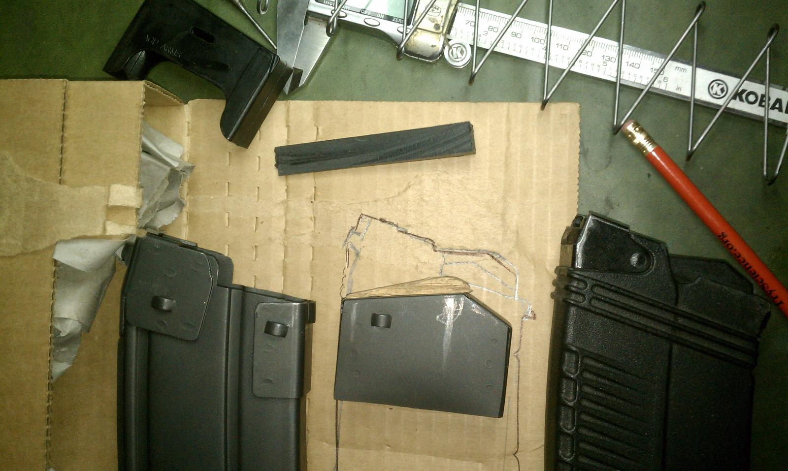

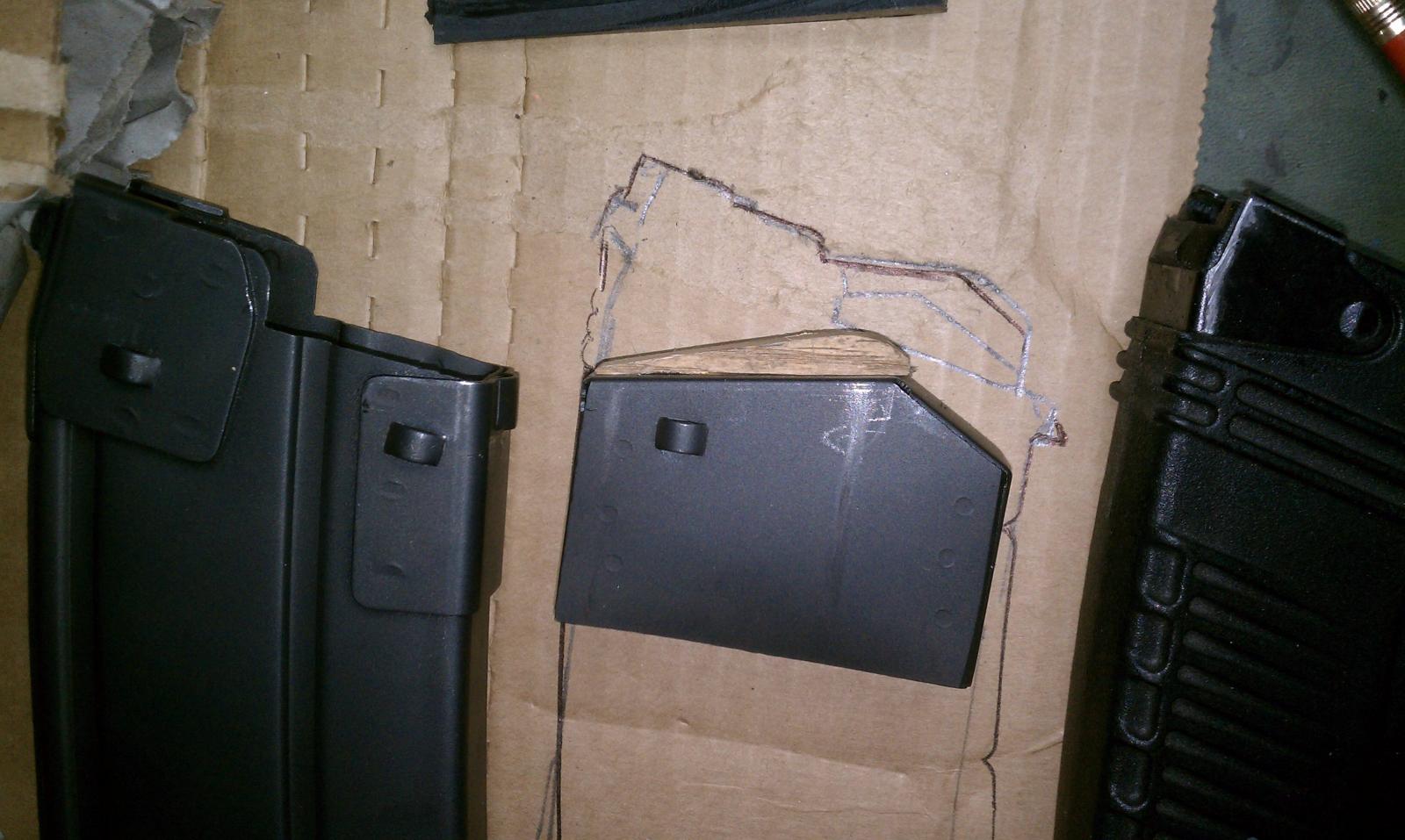

Cobra 76 two 2,678 Posted August 27, 2013 Report Share Posted August 27, 2013 Forgot to add... After trying to hand feed the Fed ammo today and having the same jams on the top rounds, even after fixing the mag latch problem, I decided to go ahead and address the feed angle problem some by adding a wedge to it (the same ones I still have from back when I got the 20 gauge mags to feed 2 3/4" ammo from the 3" only mags) to the top of the follower.... lifting the front of the column as high as possible without it binding in the rim channel. That did work to feed the top shells better but still wasn't 100% in both guns. My older gun was still having issues, and there were some failures to feed lower in the column, likely due to added friction slowing down the popup. Pics coming... Quote Link to post Share on other sites
Cobra 76 two 2,678 Posted August 27, 2013 Report Share Posted August 27, 2013 The rear lug mod I did (before polishing)... Still waiting for follower angle pics to upload. Will edit. Quote Link to post Share on other sites

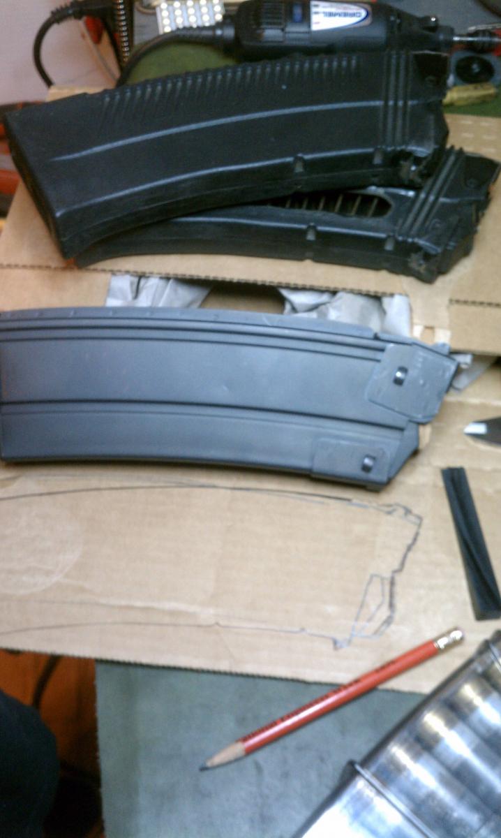

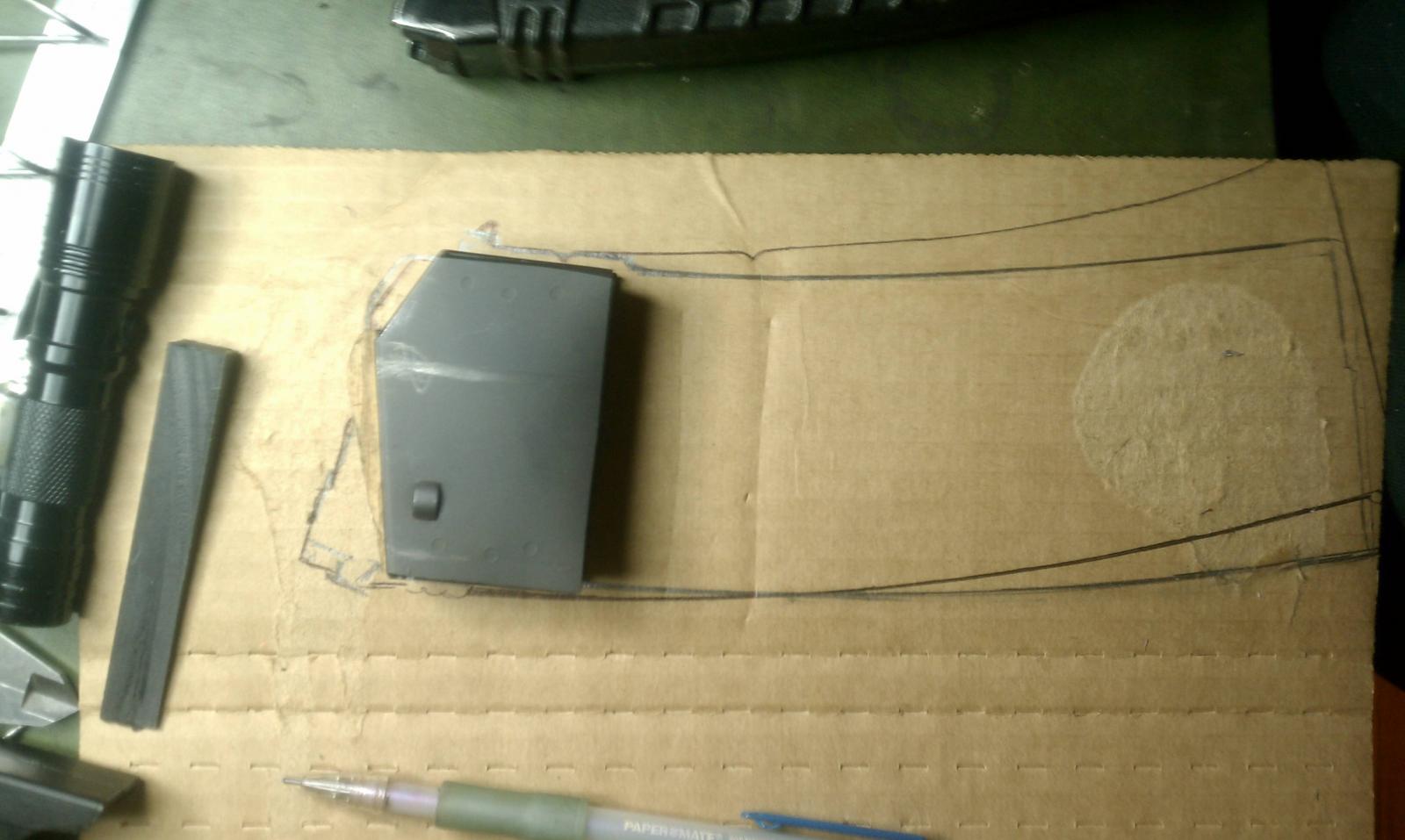

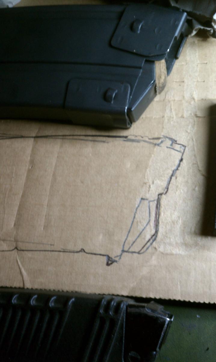

Cobra 76 two 2,678 Posted August 27, 2013 Report Share Posted August 27, 2013 Yes I noticed the same thing when first trying to lift to see how much I could put on it. It gets easier as you press down the follower. Here are the pics of the wedge I added that helped. Drawn on the box lid the mag came in are the outlines of the steel mag superimposed with a IZZY 8rdr, with follower angles topped out, and also with an AGP follower installed. They fit but don't have enough upward tilt at the top flat to work. The do come up higher though... something I forgot to mention will probably help. I know you said the steel followers have a little more drag but.... Something else I forgot to mention is the way the lack of having a push ramp in the back allows the feed lips to grab and hold back the shell rims. This is not necessarily a good thing Gunfun. Note the AGP follower outline is almost identical to the superimposed factory Izzy mag & follower. Having your follower be able to come as far up as possible (at the very rear) is crucial in getting this mag to work with the LRBHO. (Both the Russian and mine...) Quote Link to post Share on other sites

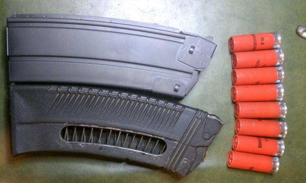

Cobra 76 two 2,678 Posted August 27, 2013 Report Share Posted August 27, 2013 If you still don't have a Russian 5 rd and 8 rd mag to get your figures from let me know. I can loan them to you. Quote Link to post Share on other sites
csspecs 1,987 Posted August 27, 2013 Report Share Posted August 27, 2013 I have a number of mags, just never did what I should have done from the start. Sawing the magazine open is the simplest way to measure every angle and size.. If we opt to make a new set of plates it would be wise to have more exacting information on hand. Edit: Cobra, I'm seeing the drawing showing my follower sitting lower (as designed) but at a steeper angle. Am I understanding that the follower should rise more to engage the LRBHO? I was under the impression that it felt for the absences of a shell not the presents of the follower. Changing the magazine curvature without understanding the totality of the issue could be an huge waste of money and time.. I've had a working sample that fired over 1000 rounds without a misfeed of any kind, so they can work perfectly. I want to chase this down to a root cause and then create another batch of corrected samples before pursing a new set of plates. The plates for these are cut from around 200 lbs of high end tool steel cut with high end cutters, and hand polished to an almost mirror finish. Not something I wanted to go through again for a while. Edit2: I'm seeing another reason wedging the follower is causing trouble, the transition from tracks to the feedlips is not spaced to allow the shells to be tipped anymore then they are. So adding anything to the follower will only make the rounds fail to rise. I'm thinking feed lips are overly tight and probably a little overly long, I'll pursue that in the morning. I had no small amount of shells through the first one without a hitch so logically something is wrong with at least a couple of the prototypes. Quote Link to post Share on other sites
Cobra 76 two 2,678 Posted August 27, 2013 Report Share Posted August 27, 2013 On the LRBHO it actually senses the follower itself, but only once there are no shells left to keep it from rising to the top. The factory LRBHO magwell mags come ALL the way to the feed lips. I sent Kevin the 8 round Izzy mag he cut in half to design the AGP mags. You can prolly get away with just taking an AGP apart to use or I can send you a half shell from what I have. I agree though you really need that as a starting point for a curved mag. Lots of things just aren't evident without a good look inside with measurements. On the drawing your follower is sitting exactly as it would in the mag. There are two mag bodies outlined and yours is more faint and straighter. Edit > I also forgot to mention earlier, when talking about that part I call the push ramp at the back, I was going to make one in there this afternoon to see if it would help but the way your rim channel is designed and stamped, it has a 90 degree turn at the top instead of a 45 like the factory mags, so it wouldn't work unless I modified that, so I didn't try it. Another pic of drawing. Quote Link to post Share on other sites

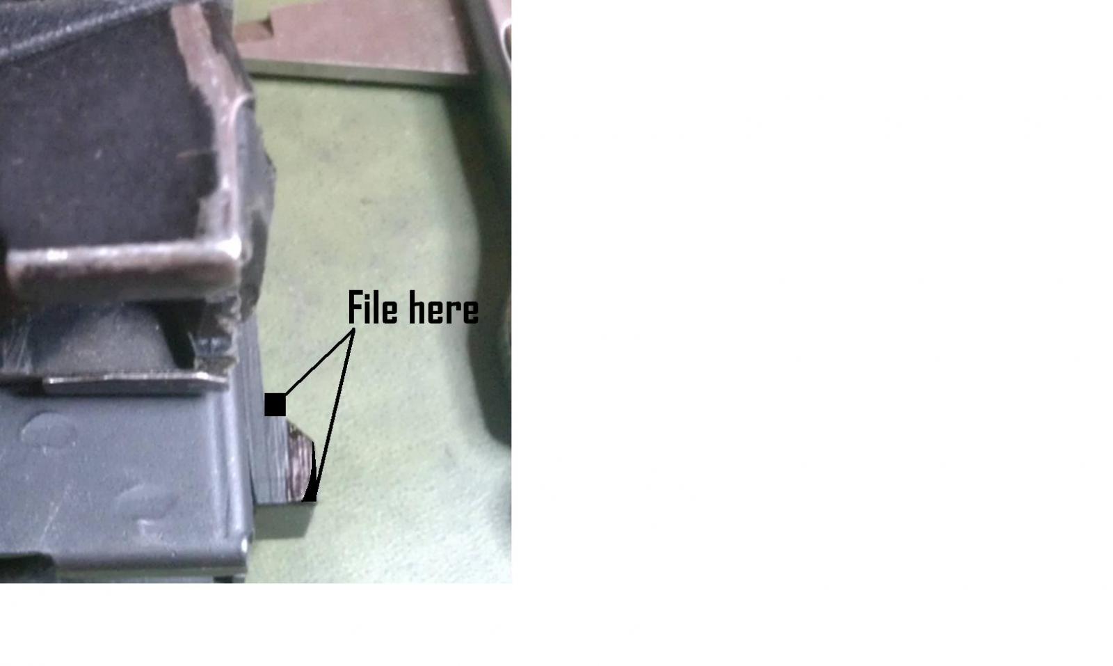

Cobra 76 two 2,678 Posted August 27, 2013 Report Share Posted August 27, 2013 Just put the shotgun in a support with magwell facing up. Set the front lug and rock the mag down into place (empty with bolt locked back) until the stops are against the receiver. You mag catch should at least be starting to move forward on the underside of the lug you can see at this point. Push it hard with you finger to lock it as much as it will go. Then use something hard and pointed like an exacto knife or a sharp scratch awl to cut a mark along the leading edge of the mag catch on the lug. Then remove mag, place in a padded vice (carefully of course not to squeeze it too tight) and use a small triangular file to cut a step into the lug along that scribe mark but not any past it. Cut in below it and test fit until it starts to lock in. If you remove too much the mag will get loose fitting so be careful. Look at the pics I posted above. 1 Quote Link to post Share on other sites
Cobra 76 two 2,678 Posted August 27, 2013 Report Share Posted August 27, 2013 If anyone could pm or post instructions on how to get a lock id love you forever. Im going back today and would really like to hold the hg I figured a little off the bottom would work but am not the best with a file. Here ya go beefcake. This is what I did and mine fits tight as can be now. Just take it slow and be careful not to do the final adjustment til most of the material is already removed. Leave some then slowly file & fit til it's right. The catch has a lot more room for movement inward so don't worry about going too far in toward the mag body. You can take it all the way to the base of the reinforcement. It's taking too much off toward the top of the lug that will make the mag fit loose. Other pics in post #136 Quote Link to post Share on other sites
csspecs 1,987 Posted August 27, 2013 Report Share Posted August 27, 2013 Did a lot of checking.. Seems I get to blame the heat treat shop a little more. Magazine body on several of the samples are spread in the middle allowing the fronts of the rounds to semi stagger and thus lowering the fronts by almost 1/8" by round 8. I'm seeing that several of the poly magazines spread by almost this amount when loaded which is why they are made with a steeper curve.. Our mags don't spread when loaded, but they are spread due to thermal shock (or whatever the correct term is). That should be correctable. Quote Link to post Share on other sites
gunfun 3,931 Posted August 27, 2013 Report Share Posted August 27, 2013 If anyone could pm or post instructions on how to get a lock id love you forever. Im going back today and would really like to hold the hg I figured a little off the bottom would work but am not the best with a file. Here ya go beefcake. This is what I did and mine fits tight as can be now. Just take it slow and be careful not to do the final adjustment til most of the material is already removed. Leave some then slowly file & fit til it's right. The catch has a lot more room for movement inward so don't worry about going too far in toward the mag body. You can take it all the way to the base of the reinforcement. It's taking too much off toward the top of the lug that will make the mag fit loose. Other pics in post #136 csspecs mag lug mod.JPG Step mods.jpg That would not have helped with mine. The lug just touched with the latch at full stroke. I wonder if your mag body is longer front to back or the lug is located differently on the vertical axis than mine or whether that is a gun variance. I'll put up pics this p.m. 1 Quote Link to post Share on other sites
beefcakeb99 572 Posted August 27, 2013 Report Share Posted August 27, 2013 I figured that was it but nervous about the angle looking at it the catch doesn't return any.. Prob need a few mm off the bottom of the lug Quote Link to post Share on other sites
