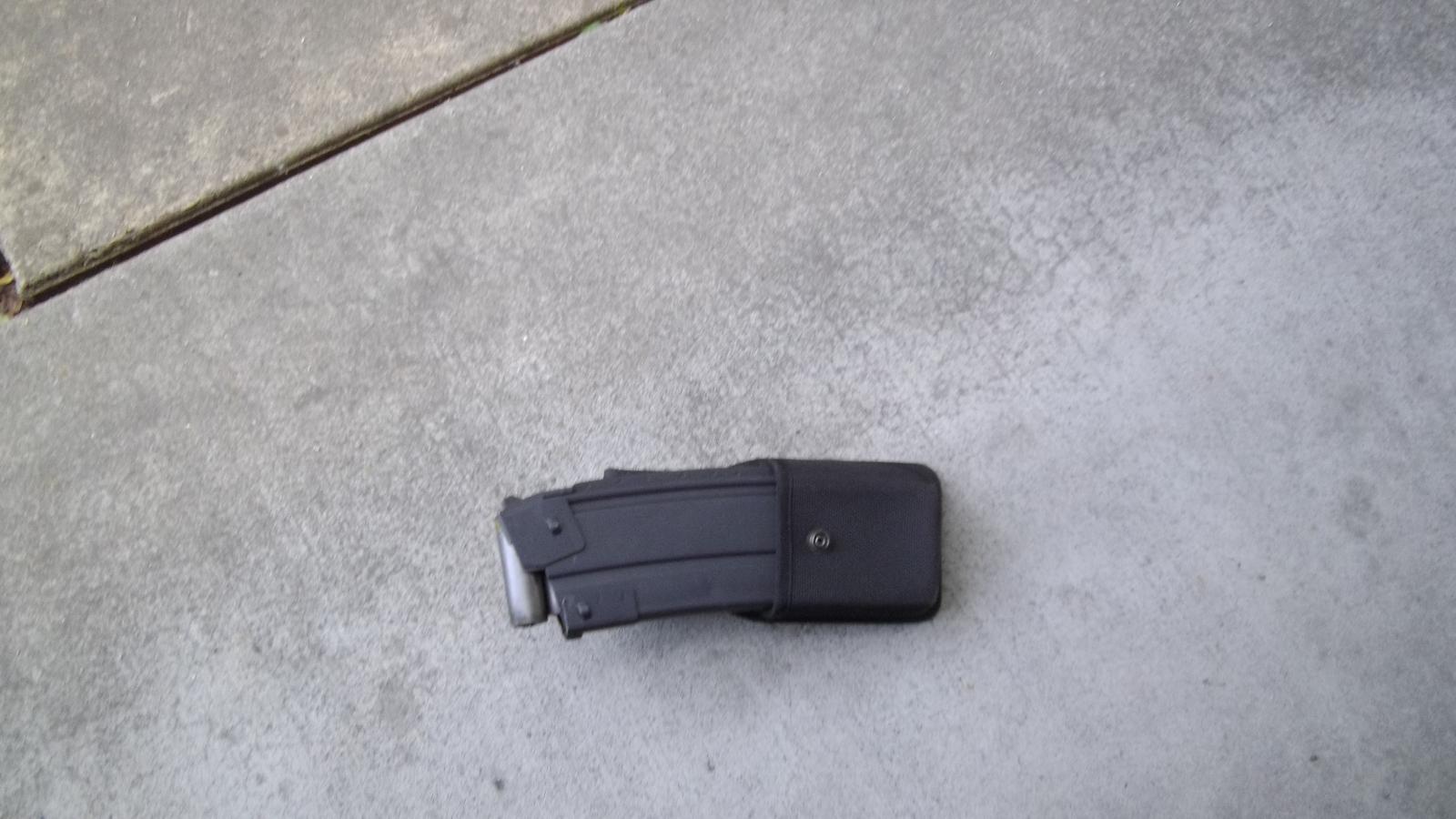

gunfun 3,931 Posted October 5, 2013 Report Share Posted October 5, 2013 (edited) All data shown after test 2 is with the mods to feedlips. Edit _corrected some data I misread off of my handwriting. _ A pic uploaded before camera stolen. Orange metal crayon melted off. wear shows where tab engaged. Shown fitting nicely into police radio hauler. Edited October 11, 2013 by GunFun Quote Link to post Share on other sites
