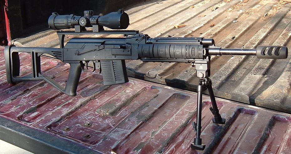

RED333 1,025 Posted November 3, 2012 Report Share Posted November 3, 2012 (edited) I made my own, works for me. I can get the cover and bolt off and not mess zero on the scope. Edited November 3, 2012 by RED333 Quote Link to post Share on other sites
timy 1,185 Posted November 3, 2012 Report Share Posted November 3, 2012 I made my own, works for me. I can get the cover and bolt off and not mess zero on the scope. Very innovative, Red. However, it sure looks like it could get bumped out of alignment easily. Do you wear kid gloves or is it not a problem? Quote Link to post Share on other sites
RED333 1,025 Posted November 3, 2012 Report Share Posted November 3, 2012 So far not an issue, put it in a soft case for back and forth to the range. Quote Link to post Share on other sites

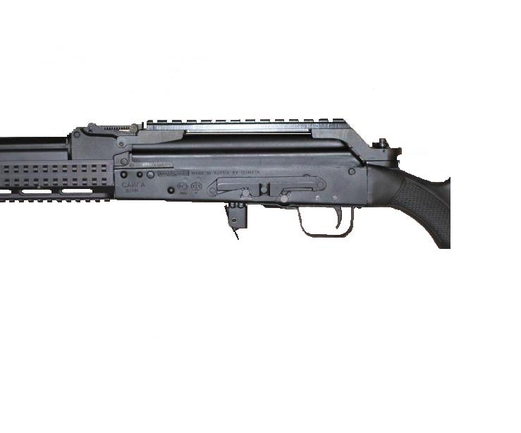

Rhodes1968 1,638 Posted December 8, 2012 Report Share Posted December 8, 2012 Besser... Quote Link to post Share on other sites
netpackrat 566 Posted December 8, 2012 Report Share Posted December 8, 2012 The Krebs rail is nice. It has some advantages and some disadvantages. The big disadvantage to my way of thinking, is it requires the stock tang for mounting, so you can't use it with one of the cut-tang receiver blocks like you can the TWS. That, and it isn't as low as the TWS gen 2 rail. That doesn't matter as much with a regular scope because you need tall rings with the TWS to clear the "dog leg" portion of the mount, but with a scope that has a straight tube for the objective, you should be able to mount it lower on the TWS than the Krebs. The TWS gives you the choice of a couple different rear sight options, although neither is adjustable, so you still have to make all your adjustments at the front. Advantages of the Krebs... People bitch about the cost, but you don't have to pay extra for a rear sight, which is adjustable, and it gives some gross elevation adjustment of the rail for rifles where the barrel is not necessarily aligned with the receiver (I have an AK like this that can't use the TWS rail or Tech Sights), and it leaves the factory recoil system and dust cover unaltered. This means you don't have to mess with aftermarket recoil buffers, or the TWS .308 specific takedown button that doesn't work. It can also be a big deal if you reload, because you can then install a Valmet recoil buffer on the dust cover and save some of the beating that your brass will take. The TWS cover is too thick to accept the Valmet buffer. 1 Quote Link to post Share on other sites
