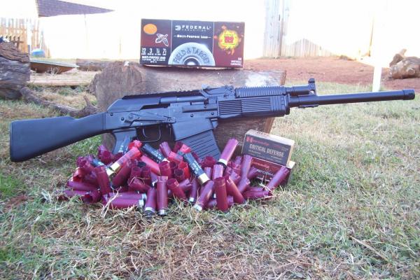

thebuns1 4,323 Posted November 10, 2012 Report Share Posted November 10, 2012 Finally got to go and stretch her legs a bit today with 120 shells. Picked up the bulk Federal pack from Walmart for 23 bucks, and it ate everything I fed it. The very first round I fired I had a FTE because I limp shouldered the Shotgun. After stiffening up a tad I didnt have anymore issues. I did notice that with this shitty walmart ammo, it did not sling the shells like it did with the full power Hornady loads I put through it. I ran a mix of the 100 rd pack and the Hornady shells and didnt have any cycling problems at all. There were 2 instances where the bolt failed to stay open on the last round, but I chock that up to the ammo, as it was just enough to cycle the action based on the ejection of the shells. Likely a difference in powder charge of the weaker rounds, and not allowing the carrier to move fully rearward. Dont know, but dont really care. It was fun as fuck. I had a blast and destroyed many tree limbs and other odd ball items I humped down into the holler. Recoil wasnt that bad at all, and was actually about as mild as my Mossy 500 with a knox recoil stock, and will be reduced further once I get a good muzzle brake on her. I didnt experience my dust cover poping up on its own like others have. Im going to try the winchester cheap shit next time and see how that goes. 8 Quote Link to post Share on other sites

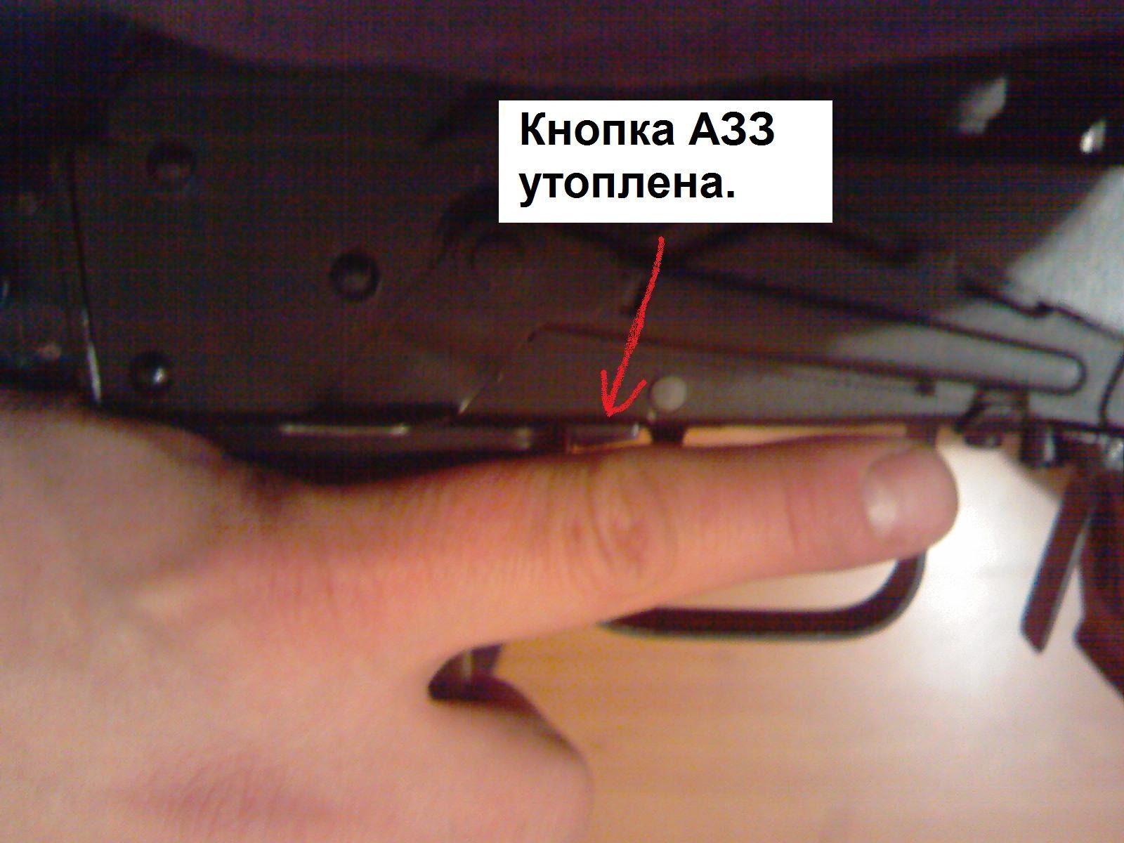

Sergii 142 Posted November 13, 2012 Report Share Posted November 13, 2012 There were 2 instances where the bolt failed to stay open on the last round, but I chock that up to the ammo, as it was just enough to cycle the action based on the ejection of the shells. Likely a difference in powder charge of the weaker rounds, and not allowing the carrier to move fully rearward. Check the position of your finger. Especially if you use gloves. 3 Quote Link to post Share on other sites
thebuns1 4,323 Posted November 13, 2012 Author Report Share Posted November 13, 2012 I didnt think about that. At the moment, mine is a little stiff to get it to release, but I still could have easily hit that under recoil and not even noticed it. Thanks for the tip Sergii. Quote Link to post Share on other sites
Sergii 142 Posted November 13, 2012 Report Share Posted November 13, 2012 I didnt think about that. At the moment, mine is a little stiff to get it to release, but I still could have easily hit that under recoil and not even noticed it. Thanks for the tip Sergii. When a finger is pressed, it does not give the button to get out. Because of this bolt carrier does not stop .. Quote Link to post Share on other sites
thebuns1 4,323 Posted November 13, 2012 Author Report Share Posted November 13, 2012 That makes sense. And my big foot hands dont help any either. lol. Quote Link to post Share on other sites
thebuns1 4,323 Posted November 16, 2012 Author Report Share Posted November 16, 2012 Well after taking an empty mag and putting your trigger finger in the way of the bolt hold open release, I pulled the charging handle back and the bolt did not stay open. I expected a bit more tension against my finger with the release, but its easy to see why the bolt didnt stay open on the last round now. Thanks Sergii. Im almost positive thats why this happend. Quote Link to post Share on other sites
