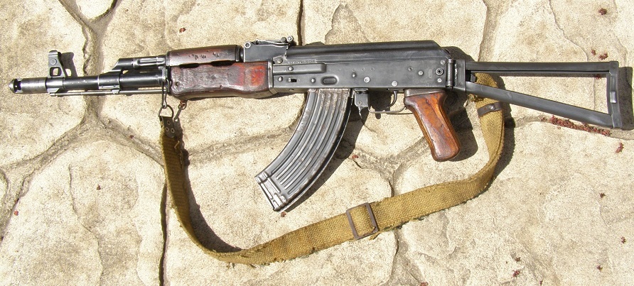

Hello and g'mornin yall. I am in the conversion process with my Saiga 7.62 rifle ( moving fcg forward today). My saiga has egyptian handguards and a triangle nonfolding stock and standard polymer akm pg. Im attempting to give it that egyptian third world khyber pass rough look. I was wondering if anyone has experience or know how when it comes to aging the stamped receiver to look as khyber pass as possible. Ya know the shiny steel peeking through with the park rubbed off look? Would a dremel and a brush swept accross the reciever work? Sandpaper? I have some ideas but would like some suggestions. Thanks
Heres and example of what id like:Attached File  p4120608.jpg   215.97K   9 downloads

Leave off the brush - you don't want wire brush marks on the metal. I left an AKM action in a safe place, outside, hidden in a bush and chained to a fixed object, over a winter - after I scrubbed the surface rust off, it looked like a true BFPU.

Strip off all the factory paint, clean the gun thoroughly with alcohol or a quality degreaser and repaint with a flat gray paint of your choice. Then use fine-grit sandpaper here and there for an added effect.

Blue it, then, bury it in old coffee ground for a week.

That said, one way of putting aged patina on old metal finishes is timed immersion in mild acids followed by cleaning and inspection. The coffee ground suggestion is one way. I suggest you use a different food instead. Cheap yellow mustard. It has acid from the vinegar, and can be spread where you want it while slowly drying. This makes it easy to control how much reaction you get. People have had really good results "aging" silver this way, or tarnishing swords. It looks just like age. coat it in mustard, wrap it in saran wrap, clean it off every hour or two to see progress, then put a sealer coat on there to stop further wear when you get it where you like it.

Step 1: Begin drinking beer. Any type of beer will do but remember its the quantity not the quality. This step is the most critical to begin and removes any hesitation or regret from beginning Step 2.
Step 2: Find old sand paper and aimlessly begin rubbing in a back to forth motion. Don't forget to restart Step 1 often.
In hardly any time your rifle will appear like it was found in a war-torn shithole and will look similar to this:
