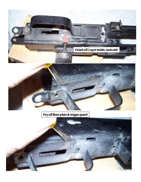

plagueis 0 Posted March 14, 2013 Report Share Posted March 14, 2013 i'm converting the exact 308 mine has the gripnut cutout already also, how did you remove two tack welds in the middle ? Quote Link to post Share on other sites
El Cabron 91 Posted March 14, 2013 Report Share Posted March 14, 2013 Maybe I can answer the weld and rivet removal question. I used a dremel with a tapered cone stone (for clearance) to remove the front trigger guard rivet, and for the spot welds on each side. Then used a flat bladed screwdriver to carefully pry bottom plate off. Touch up paint was DupliColor black engine paint, recommended by Dinzag; worked perfectly. See the attached slides to clarify. 2 Quote Link to post Share on other sites
plagueis 0 Posted March 15, 2013 Report Share Posted March 15, 2013 Maybe I can answer the weld and rivet removal question. I used a dremel with a tapered cone stone (for clearance) to remove the front trigger guard rivet, and for the spot welds on each side. Then used a flat bladed screwdriver to carefully pry bottom plate off. Touch up paint was DupliColor black engine paint, recommended by Dinzag; worked perfectly. See the attached slides to clarify. Slide2.JPGSlide3.JPGSlide4.JPG you sir are the man all i'm waiting on now are my parts from css I was gonna order from Dinzag but that 2-4 weeks processing is too long for me Quote Link to post Share on other sites
plagueis 0 Posted March 16, 2013 Report Share Posted March 16, 2013 These was the best instructions on the net for the s308 (believe me I searched for days) now I'm waiting for the duplicolor to dry and then it's home sweet home ! Quote Link to post Share on other sites
jojo200517 68 Posted March 17, 2013 Report Share Posted March 17, 2013 Yeah the 308's are a little different animal. No other 2 trigger pin things to drill out and therefore no holes there to plug up. Square nut hole already cut (so was my 223 conversion not sure which ones have this and which ones don't). 2 rivets and 2 spot welds on the bottom plate instead of 3 rivets. I drilled the rivets and then ground some when the drill wandered off center and cussed and fussed a lot doing my first conversion (the 308). Then once I had them out I discovered the spot welds. Hopped on here and the suggestion was a sharp straight screwdriver a hammer and patience. So pound and pry away I did until it pulled the nuggets of the welds out of the little plate under the trigger guard. Ground down the remaining weld on the bottom of the receiver with sanding drum on the dremel and went on to bore the holes for bolt on trigger guard from my conversion kit. After doing the 223 conversion and looking back on the 2 I will say that if you lack a drill press (heck maybe even then) i'd really suggest grinding the rivets flush and then punching out the remainder. Only thing I drilled on it was the additional trigger pins and just enough to punch them out. Just use a steady hand and go easy with the power tools so you don't slip grind stuff you don't want to. One more note about the 308, the bolt carrier and bolt seem to be a shit load harder to get back in it when you re-assemble. Some people go as far as to tie the trigger down with a twist tie, push the hammer back so its under the disconnector and a little lower. Quote Link to post Share on other sites
