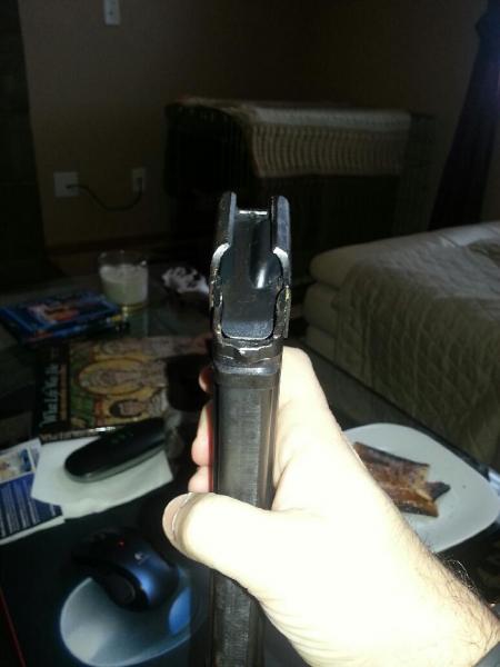

breid1970 327 Posted January 28, 2013 Report Share Posted January 28, 2013 (edited) Hey guys and gals. I just recently bought a saiga carbine 7.62. I had planned on converting it to the AK configuration, ie move trigger group forward, folding stock, and feed ramp so it would take standard AK mags. However, the box it came in said. Saiga rifle withe mod/magwell and plastic stock. So after close examination of the rifle it comes with a pistol grip, straight out of the box. The trigger appears to have already moved forward ie..its snug up against the magwell. And of course the the box says modified magwell.. So does that mean it will take all AK mags? It came from RWC, at least it says that on the rifle along with the saiga makings and made in russia logo. Any help would be really helpful. I have no clue if its a G2 trigger group and it also came with two big thirty round magazines with no saiga marking on the mags as well. If you guys know, I mean really know, please email me at breid1970@gmail.com and let me know. I emailed the company tech rep but have not gotten a response. I should also note that the barrel is the 16 in, but has no bayonet lug or flash suppressor of any kind. Thanks again. Here are some pictures. I dont know what was done in the magazine well, it does not appear to have that feed ramp and this is one of the magazines it came with. Edited January 28, 2013 by breid1970 Quote Link to post Share on other sites

cguiro 29 Posted January 28, 2013 Report Share Posted January 28, 2013 What kinda mag did it come with a standard saiga mag or a ak mag? Quote Link to post Share on other sites
semper299 284 Posted January 28, 2013 Report Share Posted January 28, 2013 Without seeing it, it sounds like you got one that has already been half way converted, meaning the trigger and magwell have been converted. If that is the case, nice find, depending of course what you paid. Quote Link to post Share on other sites

breid1970 327 Posted January 28, 2013 Author Report Share Posted January 28, 2013 What kinda mag did it come with a standard saiga mag or a ak mag? it appears to be a standard AK magazine, no saiga marking on it at all. I do however think the trigger group was moved foraward, i just noticed that looking at the chamber pic that there does appear to be a feed ramp attached I could be wrong though. Quote Link to post Share on other sites
dubya 198 Posted January 28, 2013 Report Share Posted January 28, 2013 If it has a feed ramp it'll most likely be a small piece of metal with a screw in the middle of it securing it. Does the mag have a cutout in the mag body where the bullet points when loaded or is it solid with no notch? Quote Link to post Share on other sites
breid1970 327 Posted January 28, 2013 Author Report Share Posted January 28, 2013 (edited) Ok i just got off the phone with RWC and they said that yes what I have is a fully converted saiga to the full ak configuration as in trigger group moved forward, and it does take all AK mags. This is awesome news. All I really will do now is telescoping stock, pic rail forward hand grip and at a later date a G2 trigger group. Ok i just got off the phone with RWC and they said that yes what I have is a fully converted saiga to the full ak configuration as in trigger group moved forward, and it does take all AK mags. This is awesome news. All I really will do now is telescoping stock, pic rail forward hand grip and at a later date a G2 trigger group. Evidently Century arms buys from them directly and does the quick modifications. Edited January 28, 2013 by breid1970 Quote Link to post Share on other sites

breid1970 327 Posted January 28, 2013 Author Report Share Posted January 28, 2013 That is a good deal now. Similar set ups were selling for around $450-500 a year ago, but right now that is a good price. Do you have plans for a front end conversion? I am trying to find a basic forward hand guard that has a rail that doesnt break the bank. As for the magazine well, I dont know, it came from RCW or RWC with that on the box. You guys have any suggestions. I am assuming that the magazine i showed was standard double stack Quote Link to post Share on other sites

breid1970 327 Posted January 29, 2013 Author Report Share Posted January 29, 2013 When I talked to the rep he said that Century arms does buy the receiver from them and then they do the upgrade. Speaking of upgrades, i would like to get an AK style forward handguard and i was at my local gun store and it had one from tapco but it looked really short. Im guessing there are only certain forward handguards you can put on. Do they even make replacement barrels for these? Though to be frank Im pretty sure its the same crome coated barrel the ak's use. My next projet for this will be the forward handguard and maybe a relex sight. If you guys have any ideas let me know. I bought an American made saiga double stack magazine and it did not fit at all, so at this point Im certain that my rifle will now only take standard AK magazines. Quote Link to post Share on other sites
Spetnaz Soldier 47 Posted January 29, 2013 Report Share Posted January 29, 2013 It will take saiga mags as well u just have to grind the nipple on the front of the mag down a tiny bit. Quote Link to post Share on other sites

mancat 2,366 Posted January 29, 2013 Report Share Posted January 29, 2013 (edited) You have one of the conversions that were farmed out by Century and Classic Arms. Just a normal Saiga 7.62x39 with the trigger group relocated to its normal position, and a typical 7.62x39 bullet guide installed - this is the small section of circular steel just beneath and before the chamber mouth, which you are referring to as a "feed ramp," and without it the rifle will not feed from military magazines. The bullet guide is tack-welded in place vs. bolt/screw/rivet. It should be solid, but I've heard of one or two guys having the guide fall off due to having a small weld with poor penetration. Some claimed that the guide looked to be held in place with a two-part epoxy, but others disagree. There is nothing special about the magazine well. When these were available about two (??) years ago, they were around $400-500, so anywhere near that and you have a great deal given current prices. Edited January 29, 2013 by mancat Quote Link to post Share on other sites
