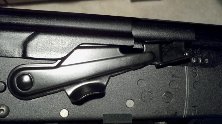

true.believer 10 Posted March 15, 2013 Report Share Posted March 15, 2013 Compared to the Saiga rifles, the primary dust cover on the shotgun receivers have a longer notch on side with the charging handle to allow for clearance of the ejected shells. The problem that I have seen with this is that the safety selector, when pushed upward to the "Safe" position, frequently travels well beyond the top of the receiver, only stopping after it begins to set underneath the dust cover. This can make it rather awkward and difficult to move the safety into the "Fire" position, even with a modified safety selector (like the Krebs Mark VI-S). I am thinking that possibly adding a safety selector-stop notch at the "Safe" position would help to prevent this over-travel and reduce the difficulty in transitioning back to the "Fire" position, approximately in the location shown here: I don't see any issue with the selector position at this notch location that would cause problems with keeping the fire control mechanism locked, and it appears that the selector position is still sufficiently in-line to prevent charging the bolt. Has anyone tried this before, and/or are there any potential problems that I am overlooking with this seemingly innocuous modification? Quote Link to post Share on other sites
Cobra 76 two 2,677 Posted March 15, 2013 Report Share Posted March 15, 2013 You can do it and it will work but your ejection port won't be sealed against dust and dirt. A better and easier option is to put a beveled spot in the top edge of receiver where the bump on the selector pops over the edge. Then Take a little bit of the spring action out of the selector by putting a very slight outward bend on it. You have to do this carefully though so it stays straight, or it will start scratching the receiver in the middle part if it bellies out there. Quote Link to post Share on other sites
Nephilim7 107 Posted March 15, 2013 Report Share Posted March 15, 2013 You can do it and it will work but your ejection port won't be sealed against dust and dirt. A better and easier option is to put a beveled spot in the top edge of receiver where the bump on the selector pops over the edge. Then Take a little bit of the spring action out of the selector by putting a very slight outward bend on it. You have to do this carefully though so it stays straight, or it will start scratching the receiver in the middle part if it bellies out there. +1 I have done this as well. Takes some tuning, but works great! BTW, isn't there some part of the factory disconnect that takes care of this over-travel? Can it be emulated without welding? Quote Link to post Share on other sites

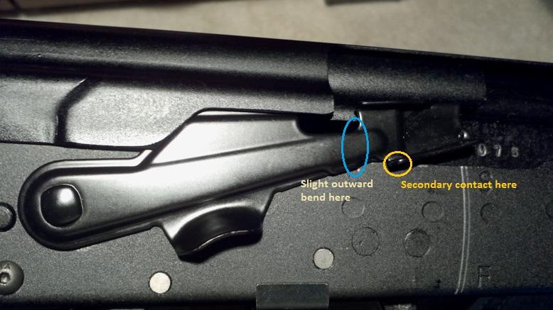

true.believer 10 Posted March 16, 2013 Author Report Share Posted March 16, 2013 That sounds like a good idea; I think the small bevel alone will make a pretty significant reduction in that "spring action" out of the selector travel once it reaches the top of the receiver. On back end of the "head" of the selector there is a slight protrusion that makes secondary contact with the receiver that provide the tension contact against the receiver once the primary dimple passes the edge of the receiver. This secondary contact has a pretty pronounced edge on it, that catches above the upper edge of the receiver once the selector begins to over-travels; this looks like it adds another "spring action" to the selector movement, causing it to over-travel further, and is also the culprit in the difficulty of returning the selector to the "Fire" position. So I think by giving a very slight outward bend to the "head" of the selector, and maybe even very slightly grinding and polishing the edge of the protrusion at the secondary contact (to give it a smoother sloped edge rather than the "hard" edge) would significantly relieve the transition headaches that I am currently having. Nephilim7, I don't recall off-hand there being anything on the factory disconnect that acted as an over-travel stop for the selector; but I'll take a look at it and see if I can find something on that front. Quote Link to post Share on other sites
Bigchris 31 Posted March 16, 2013 Report Share Posted March 16, 2013 couldnt you just drill some dimples next to the S and F where the safety travels to catch it from going to far upward? Thats what i was planning on doing.... Quote Link to post Share on other sites
true.believer 10 Posted March 16, 2013 Author Report Share Posted March 16, 2013 BigChris, that was my original question (with respect to the "Safe" position, specifically). Quote Link to post Share on other sites
Bigchris 31 Posted March 16, 2013 Report Share Posted March 16, 2013 Can you edit the pic to show where this bevel will go that ya'll are talking about putting... I am not following this. Quote Link to post Share on other sites
true.believer 10 Posted March 16, 2013 Author Report Share Posted March 16, 2013 Tromix makes this bezel spot on the top edge of the receiver. Here is an example that I was able to find: Quote Link to post Share on other sites
