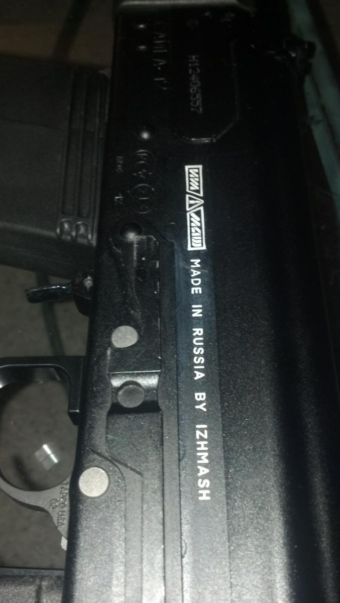

Capt Nemo 883 Posted March 24, 2013 Report Share Posted March 24, 2013 Still have some clean up and touch up to do, but here it is. It does look better in real life than in the photos. It's a real bear trying to paint with a fine wire and a magnifying glass! Quote Link to post Share on other sites

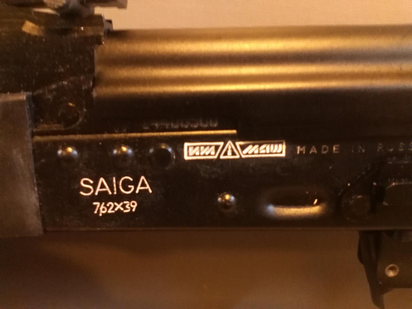

Capt Nemo 883 Posted March 25, 2013 Author Report Share Posted March 25, 2013 Spent another half hour cleaning up the lines and it looks a lot nicer! Just wish the stampings were a little deeper on mine. I'm using Testor's enamel. I've used it before on my Mini-14 front sight/flash hider combo, and it seems to take Hoppe's #9 and heat well. Lacquer probably wouldn't like the alcohol in #9 too well. Quote Link to post Share on other sites

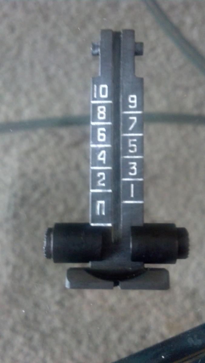

Capt Nemo 883 Posted March 27, 2013 Author Report Share Posted March 27, 2013 Here's after the cleaning. The gas plug went real easy with it's deep stampings. 2 Quote Link to post Share on other sites
dubya 198 Posted March 27, 2013 Report Share Posted March 27, 2013 Thanks for the idea Nemo, painting the gas plug numbers really helps you see what setting you're on much easier. Here's after the cleaning. The gas plug went real easy with it's deep stampings.[img=http://i1336.photobucket.com/albums/o660/Dewit2it/Saiga/paint2_zps2c5106ea.jpg] Did you use the lacquer stick to do the red "F" as well? That looks good, I used the whiteout then a red sharpie but mine isn't as vibrant. Quote Link to post Share on other sites

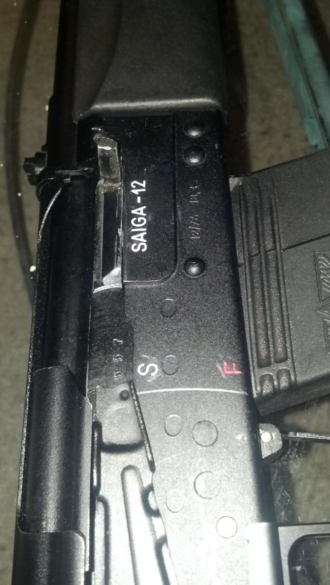

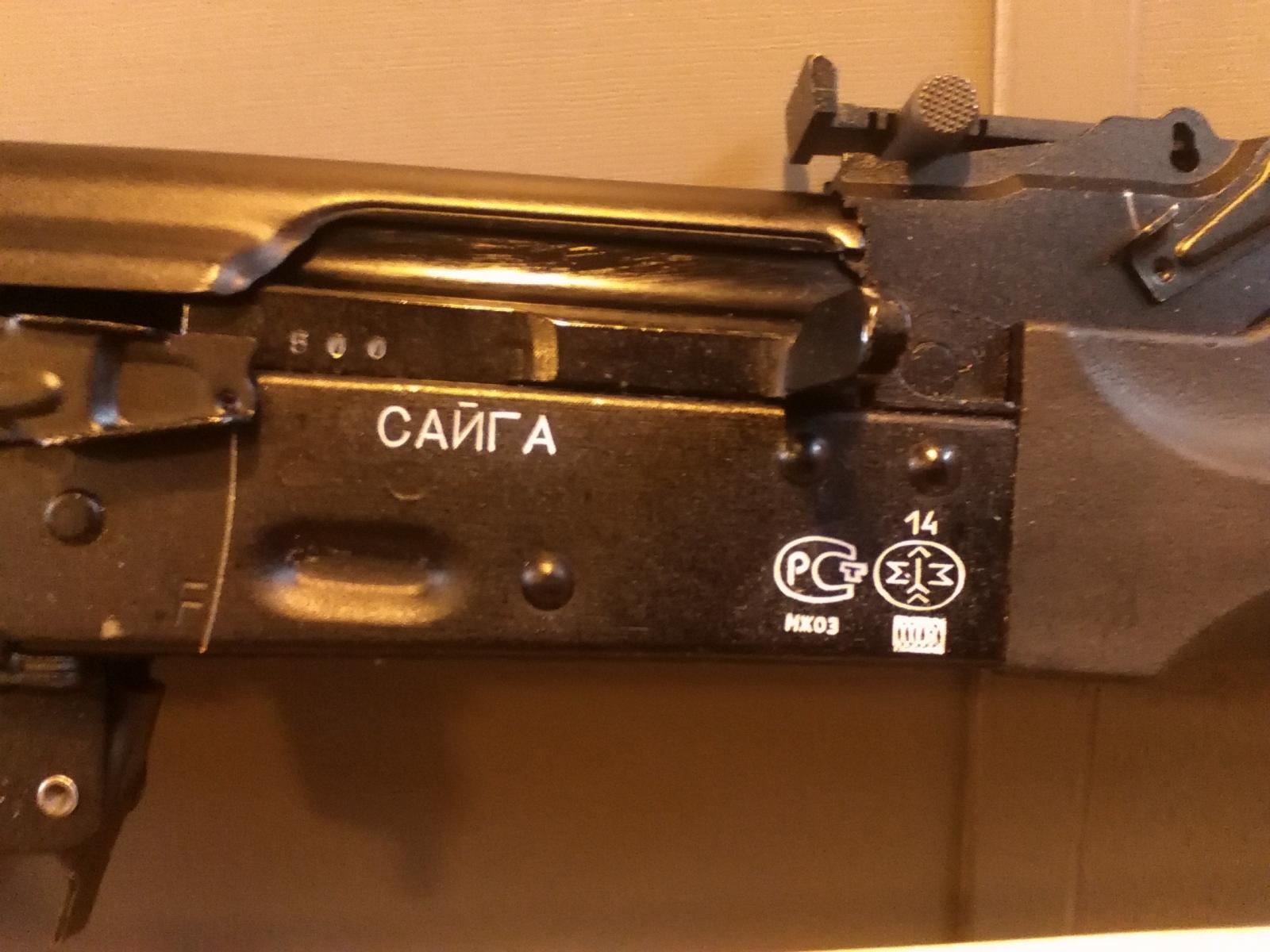

mi90cle 4 Posted April 1, 2013 Report Share Posted April 1, 2013 Well, my Lacquer Stiks came in the mail today and I don't mean to thread-jack but I figured I would put up a couple shots of how it turned out. I intend to let this dry over night and do another coat tomorrow but it already looks very nice: 2 Quote Link to post Share on other sites
Capt Nemo 883 Posted April 2, 2013 Author Report Share Posted April 2, 2013 That looks really nice! Looks like you got blessed with deep stampings. Bad news for mine, as the formula for the Testor's gold paint is different from their other colors. Hoppes #9 made some of the gold run. Their white and red had no problem. Quote Link to post Share on other sites

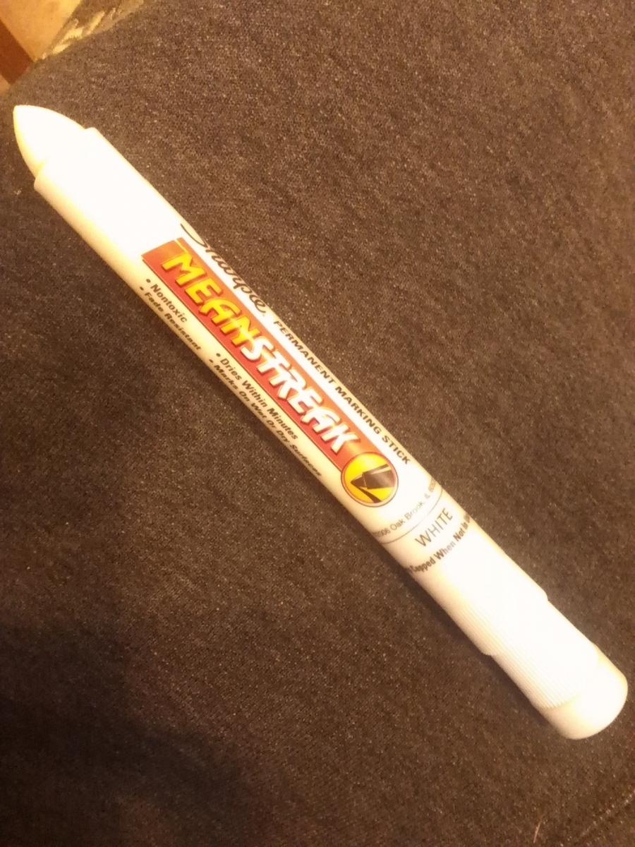

RedRhino 75 Posted April 22, 2015 Report Share Posted April 22, 2015 Thought I'd beat a long dead horse here because I found something else that might work. I haven't used it because I'm not sure if I like the look or not. But I grabbed this from work and thought I'd throw it out there. Quote Link to post Share on other sites
RedRhino 75 Posted April 22, 2015 Report Share Posted April 22, 2015 Tried it out just now. Some little bit of clouding, and in my experience, non acetone nail polish remover is not safe for use on factory finish. 1 Quote Link to post Share on other sites
JDeko 792 Posted April 23, 2015 Report Share Posted April 23, 2015 So the Mean Stick worked out, more or less? Quote Link to post Share on other sites
RedRhino 75 Posted April 23, 2015 Report Share Posted April 23, 2015 Yes, sorry, should have specified. Seems to have hardened up well. Application was easy. It has a grease-like property until it dries I guess you would say. The clouding was the only problem but that was more my fault than the product. I stuck my finger nail in it an hour or so after and didn't make a dent or anything. Overall I think it worked very well, I hadn't tried other things so I can't say it was better than other options. Quote Link to post Share on other sites
