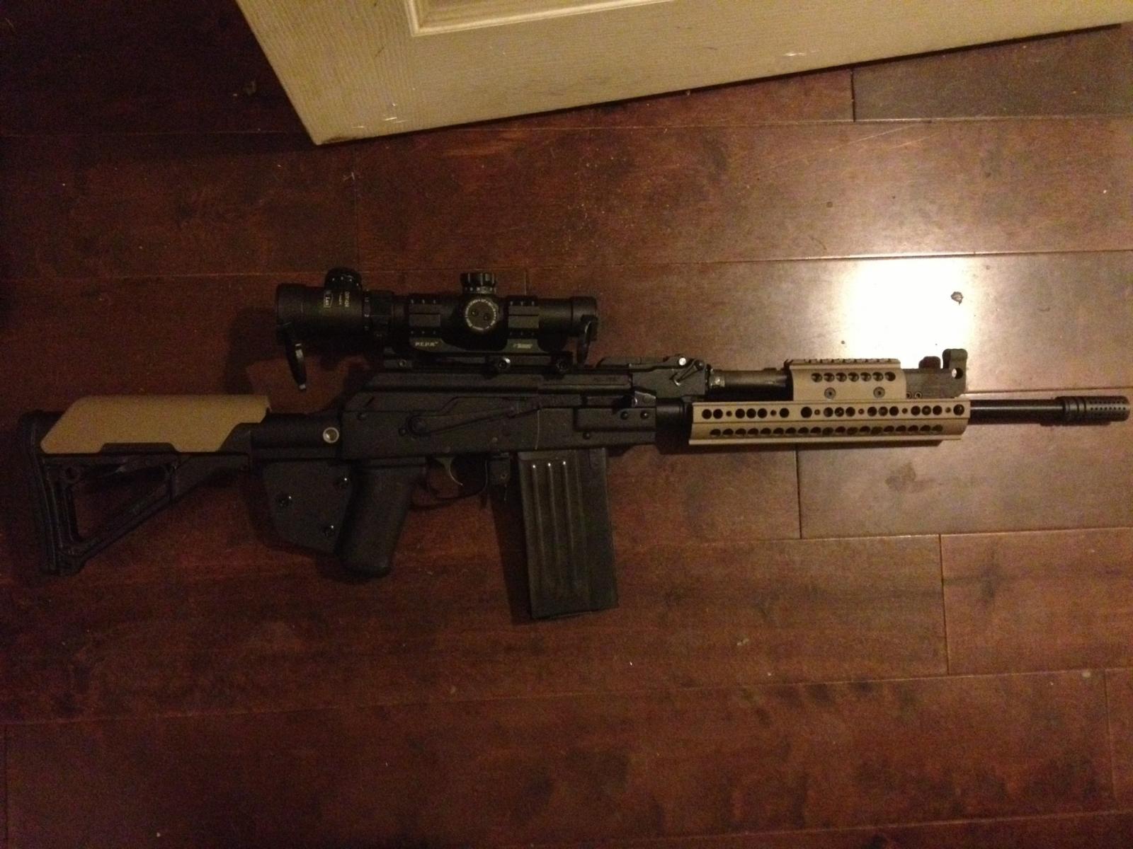

sapper1371usmc 107 Posted March 26, 2013 Report Share Posted March 26, 2013 Figured Id start a build thread for my S308. Started with a stock, unconverted, 21.8" gun purchased at KVAR. Gun was built in 2009. First phase consisted of removing the existing trigger and linkage setup along with the plate on the bottom, and replaced with a Texas AK double hook trigger, a surplus safety lever, MD Arms grip, and a CSS handguard. For magazines, so far I've attained a few CsSpec 20rnd magazines. For aesthetics, I removed the sheet metal cover spot welded to the gas tube. I touched up the bare spots with a gloss Rustoleum paint (All I had on hand, but it shouldnt stay for long). Heres a few pics of it's current state. 1 Quote Link to post Share on other sites

sapper1371usmc 107 Posted March 26, 2013 Author Report Share Posted March 26, 2013 (edited) Next stage, I will be removing the barrel from the receiver, chop to 18", recrown and thread 5/8x24. Also, I will be replacing the rear sight base with the Kalashnikov Optics Platform (K.O.P.) designed for the PSL/RPK. I'll be running the long picatinny rail along with a Burris PEPR mount and a Burris Fullfield E1 4.5-14x42 scope (already aquired). A Griffin Armament 7.62 Flash Comp, CSS AR stock adapter, and either a MOE or CTR stock with cheek riser will be added. The third stage will be to weld shape, cut, and weld the factory trigger guard to the mag release tower and rivet it in place. I will probably remove the left side scope rail and weld up any remaining holes. Once all the metal work has been done, I will throw the gun in my media blaster and prep for parkerizing. Thinking of going with a moly resin top coat or just leave it parkerized. Nice rifle. I'd love to have a 308. Thanks, but its far from done. It should end up a pretty capable battle rifle when its all said and done. Edited March 26, 2013 by sapper1371usmc Quote Link to post Share on other sites

sapper1371usmc 107 Posted March 28, 2013 Author Report Share Posted March 28, 2013 CSS supplies a front mount that clamps to the barrel via 4 bolts which is installed just behind the gas block. The handguard then screws into it. Very solid and does not utilize the gas block pins in any way. Norotor, What front sight are you running? Is it a clamp on ACE? Quote Link to post Share on other sites

sapper1371usmc 107 Posted October 7, 2013 Author Report Share Posted October 7, 2013 It's been awhile since I've made any updates. I've since pressed the barrel out, and is on it's way to ADCO to be shortened to 18", crowned, and threaded 5/8x24. They are also going to contour the barrel directly behind the threads for me to reattach my front sight. Using them, they guarantee the threading will be concentric to the bore. And they're reasonably priced. For everything mentioned plus reparkerizing, I'm out $130. I could have found someone local, but I have all the tools, and I don't know any smiths who are knowledgeable about the ak platform. Quote Link to post Share on other sites
sapper1371usmc 107 Posted October 7, 2013 Author Report Share Posted October 7, 2013 I will say this, the Russians idea of a press fit is .02", even up to .025". That included, not only the barrel journal, but also the front sight and gas block. It took quite a bit of force on my 20 ton press to bust them loose. Even the barrel pin. I bent 1/4" plate I milled out to support the trunnion when pressing the barrel pin out. Quote Link to post Share on other sites
sapper1371usmc 107 Posted October 26, 2013 Author Report Share Posted October 26, 2013 Well I got a little more work done. Got the barrel back from ADCO, which turned out great. While I had the barrel out, I went ahead and removed the side scope mount, tig'd up all the extra holes including the bho slot, and welded the original trigger guard to the mag release tower. It was riveted in place, along with re-riveting the forward most hole of the rear trunion which was removed when I took off the scope mount Quote Link to post Share on other sites
sapper1371usmc 107 Posted October 26, 2013 Author Report Share Posted October 26, 2013 Picked up a rdak stock adapter with all the AR parts to include a magpul ctr. Added a magpul Moe grip and a YHM 30LT suppressor mount. Quote Link to post Share on other sites
