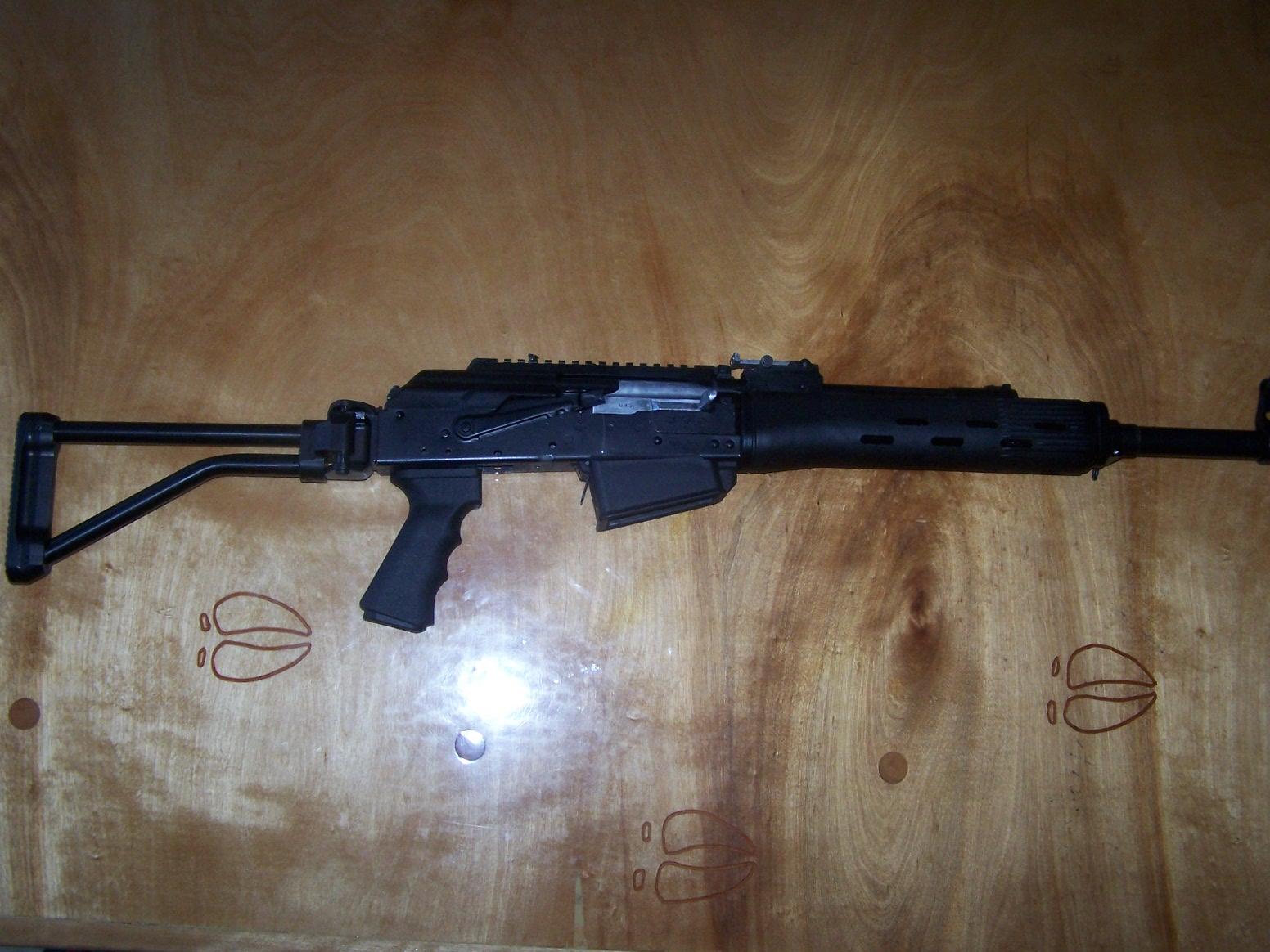

fbg_firebug 1 Posted April 18, 2013 Report Share Posted April 18, 2013 Any one have a few pictures of the bonesteel installed on their gun? Quote Link to post Share on other sites
HighPlainsDrifter 466 Posted April 18, 2013 Report Share Posted April 18, 2013 (edited) Posting photos of an incomplete build is sacrilegious on this forum but here goes. As you can see the grip hasn't been attached but the pictures should give you a good idea of what to expect. This is what she looks like in the morning without all her make-up on... Edited April 18, 2013 by HighPlainsDrifter Quote Link to post Share on other sites
bigd1979 23 Posted April 18, 2013 Report Share Posted April 18, 2013 Left side modular folder let me know if you want some closer pics Quote Link to post Share on other sites
fbg_firebug 1 Posted April 18, 2013 Report Share Posted April 18, 2013 Thanks! Was wondering how far the folder stuck out from the receiver. Some look like there a mile from it. I'm trying to find one with clean lines Quote Link to post Share on other sites

Terminator03 18 Posted April 23, 2013 Report Share Posted April 23, 2013 Posting photos of an incomplete build is sacrilegious on this forum but here goes. As you can see the grip hasn't been attached but the pictures should give you a good idea of what to expect. 100_6435.JPG 100_6437.JPG This is what she looks like in the morning without all her make-up on... 100_6438.JPG What brand is that handguard, and where did you buy it? I am looking for a better looking alternative to the stock one without adding a bunch of weight and rails that I don't need, and yours looks good, and light. I'm sure I could add a section or 2 of rail if I needed to on that anyway for a AFG, or light. I wish I could have a Bonesteel folder, but that is an "evil feature" under the MA AWB unfortunately. Just out of curiousity, though, I notice there is a left/right hinge option. Is there a reason why you would choose one over the other? My instinct would be to order the left side version so that I could still actuate the trigger with my right hand while it's folded, but with the sight rail, that might make the stock not fold flat, or something. Thoughts? Quote Link to post Share on other sites

HighPlainsDrifter 466 Posted April 23, 2013 Report Share Posted April 23, 2013 (edited) Terminator03 said: What brand is that handguard, and where did you buy it? I am looking for a better looking alternative to the stock one without adding a bunch of weight and rails that I don't need, and yours looks good, and light. I'm sure I could add a section or 2 of rail if I needed to on that anyway for a AFG, or light. I wish I could have a Bonesteel folder, but that is an "evil feature" under the MA AWB unfortunately. Just out of curiousity, though, I notice there is a left/right hinge option. Is there a reason why you would choose one over the other? My instinct would be to order the left side version so that I could still actuate the trigger with my right hand while it's folded, but with the sight rail, that might make the stock not fold flat, or something. Thoughts? The S-12 Dragunov hand guard is OEM which is only available on builds imported by Legion USA. It is not available as an aftermarket part. You are right, it is light. Once I finish the conversion I plan on weighing it against my !z-109 with a CSS tri-rail. I wouldn't mind adding a rail for a light but I am unsure how to go about it and I question if the hand guard would be stable enough to do so. I chose the right side folder for two reasons. Having all the controls on the right side is nice when I'm using a sling. It's comfortable against my body. Also my other build has a right side folder with an ACE folding mechanism. I like keeping a standard between both platforms. You can still actuate the trigger when the stock is folded, but I don't know why you'd want to shoot an S-12 unshouldered. Have you done this? How'd your wrist feel? Did the shotgun cycle? I initially got into the platform for bear protection. If I'm walking around with a folded stock in bear country feel free to call me a dumbass. Left or right is a personal preference. I don't believe one is better than the other. Edited: I certainly screwed up on the quoting above... Edited April 23, 2013 by HighPlainsDrifter Quote Link to post Share on other sites
