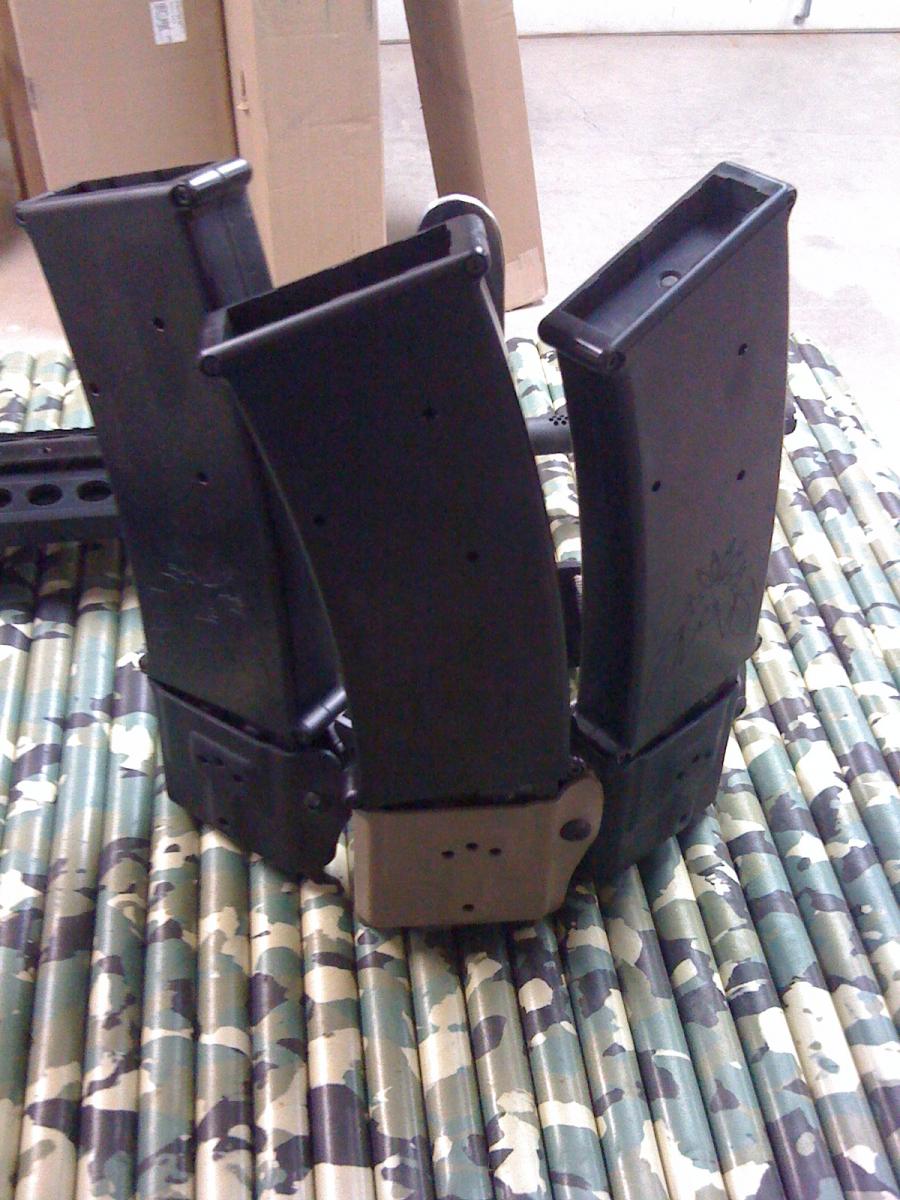

Anubis 38 Posted April 19, 2013 Report Share Posted April 19, 2013 Finally started on prepping for multi-gun nationals and decided we needed mag holders for the MKA. Built a few of these today. Quote Link to post Share on other sites

gunfun 3,930 Posted April 21, 2013 Report Share Posted April 21, 2013 Anubis-- those seem to have a lot of long weight held by a small portion at the bottom. Do they want to flop around when you run? Is there something else supporting the magazine higher up that I am not seeing? Quote Link to post Share on other sites

Jasper 19 Posted April 26, 2013 Report Share Posted April 26, 2013 (edited) Finally started on prepping for multi-gun nationals and decided we needed mag holders for the MKA.Built a few of these today. IMG_0462.JPG IMG_0463.JPG Last year I tried the 3GunGear holders for M1A which was a leg rig simlar to that in the way the body of the OEM mag was the only part being held. First time I tried them the top heavy weight slung them out when I started running from box to box. I hope you have better luck. I am using a cheap vestman vest leg rig and no issues. BUT it only holds 2. Im curious if this works out for you. For the matches I shoot thats plenty. Are those 18 round mags? Is the LRBHO functional? Edited April 26, 2013 by Jasper Quote Link to post Share on other sites
