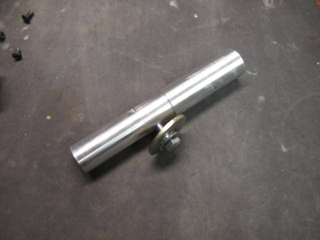

gunfun 3,930 Posted October 11, 2013 Report Share Posted October 11, 2013 No problem at all. Tromix actually sells or used to sell a long choke wrench just for the purpose. It would be a fairly easy tool to make too. Just split a dowel in half and put a sheet of steel in between to engage the notches in the end of the chokes. Quote Link to post Share on other sites

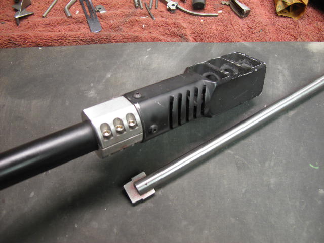

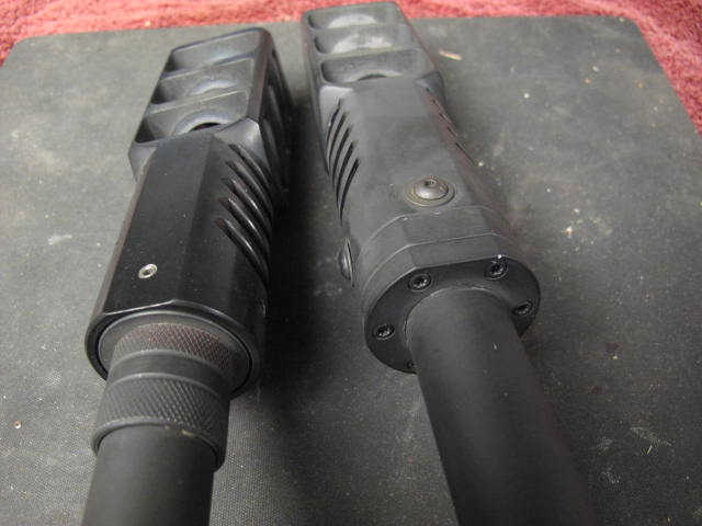

MLM0358 107 Posted October 11, 2013 Report Share Posted October 11, 2013 Here is what Gun Fun is referring to -- the OD threads were cut off this barrel. The barrel was then internally threaded for chokes and a comp slips on the OD of the barrel. If you have a short barrel, you permanently attach. In this case the barrel is still over 16" so the comp does not need to be permanently attached, hence the clamp -- You can see here a Molot GK-01 brake is attached with a custom clamp. You will see on the bench is a long choke removal tool as mentioned so the comp does not need to be removed to change chokes. For boring comps I made a mandrel (shown below) that just lightly press fits inside the comp. Another photo shows the comp attached to the mandrel in the lathe ready for boring. If you perm the comp, you would bore the comp to the OD of the barrel and weld. For the super observant, you may notice that I'm left handed since the right side lateral ports of the GK-01 brake are welded up. Also shown are two more ways I've attached comps to S12s with chokes, on the right is a compression fitting for a gun with a barrel internally threaded for chokes, on the left is a choke adapter that fits on the stock external threads and the comp was bored to slip over the adapter and attaches to that with set screws. 2 Quote Link to post Share on other sites
gunfun 3,930 Posted October 11, 2013 Report Share Posted October 11, 2013 Interresting. I don't remember if I've seen that before. Is the clamp mechanism as heavy as it looks? The one on the left looks cleaner to me. I talked a while back with someone who had chopped and permed a gk 01 with internal chokes. As I recall, it required tack welding on the steel liner, putting in a stainless blind pin between the aluminum and steel portions of the comp, and welding aluminum over the pin to ensure ATF would consider it permanent. Was that you too? Is only the compression fit one threaded for chokes? to the OP- Tony Rumore did at least two chopped down with the monster brake slip fitted and permed on with the pass through choke similar to the above. He used to take custom orders and build race guns, and those looked pretty B.A. Obviously the GK-01 is pretty cool looking too in a different way. Quote Link to post Share on other sites
MLM0358 107 Posted October 11, 2013 Report Share Posted October 11, 2013 Clamp on is aluminum and weighs 2.8 oz. I could maybe make it smaller and have just two cap screws on each side, or do more weight reduction, but I decided to play it extra solid-- don't want the choke blowing down range in a match. As you noted, the one on the left is a clean set up, though it's the longest of the three. The gun is a stock S12 barrel with stock threads. A steel choke adapter (from Cobra on this forum) was turned down slightly on a lathe then threaded on to the stock threads. I bored the GK-01 to match the OD of the steel choke adapter. There is enough steel on the insert inside the GK-01 to do this -- basically I just cut off the threads inside the GK-01. Four set screws in the GK-01 fit into dimples machined into the steel choke adapter to keep the GK-01 from blowing off the end of the gun. Anyway, don't want to hijack this thread. Bottom line: there are a bunch of ways to get chokes and comps on an S12. 1 Quote Link to post Share on other sites

gunfun 3,930 Posted October 14, 2013 Report Share Posted October 14, 2013 Clamp on is aluminum and weighs 2.8 oz. I could maybe make it smaller and have just two cap screws on each side, or do more weight reduction, but I decided to play it extra solid-- don't want the choke blowing down range in a match. As you noted, the one on the left is a clean set up, though it's the longest of the three. The gun is a stock S12 barrel with stock threads. A steel choke adapter (from Cobra on this forum) was turned down slightly on a lathe then threaded on to the stock threads. I bored the GK-01 to match the OD of the steel choke adapter. There is enough steel on the insert inside the GK-01 to do this -- basically I just cut off the threads inside the GK-01. Four set screws in the GK-01 fit into dimples machined into the steel choke adapter to keep the GK-01 from blowing off the end of the gun. Anyway, don't want to hijack this thread. Bottom line: there are a bunch of ways to get chokes and comps on an S12. That's pretty slick. it gives me an idea too. Quote Link to post Share on other sites
