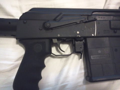

Road Warrior 8 Posted October 11, 2013 Report Share Posted October 11, 2013 I just finished my first Saiga conversion on my 16" Saiga .308 and it went off with out a hitch. The only thing that's bugging me is the tab for the BHO is partially obscuring the trigger and is effecting the way I squeeze the trigger. I was wondering if it would adversely effect anything if I were to grind the tab down a little bit. I wouldn't grind it flush w/ the receiver, I'd just take enough off to allow for more clearance. Or can I get rid of my BHO all together? Any info is appreciated, thanks. Quote Link to post Share on other sites
Sdustin 579 Posted October 11, 2013 Report Share Posted October 11, 2013 I did just that. I losked the bolt back and then took off nearly all that was sticking out so it was only long enough to work with no extra length. When I clicked this I figured you couldnt get it back in. That was so frustrating. Quote Link to post Share on other sites
Road Warrior 8 Posted October 11, 2013 Author Report Share Posted October 11, 2013 Cool that's good to know, I didn't have a problem getting the BHO back in but that's only because of CSS's youtube video. Quote Link to post Share on other sites
haugpatr 972 Posted October 11, 2013 Report Share Posted October 11, 2013 Grind it or remove it, it is a cheap part. Many feel it is just a part that could hinder the legendary AK reliability, if Mr. Kalashnakov thought it was needed, he would have originally designed it that way. Quote Link to post Share on other sites
Road Warrior 8 Posted October 11, 2013 Author Report Share Posted October 11, 2013 So if I remove it do I also remove the spring that is resting on the back notch of the BHO (Common sense says yes, as it could serve no other purpose, I just want to be sure)? I would rather get rid of the BHO all together, seeing as it doesn't stay open once the mag is removed anyway. Quote Link to post Share on other sites
Sdustin 579 Posted October 11, 2013 Report Share Posted October 11, 2013 If I removed it I would destroy it and make it into a washer. In other words I would cut the part that the pin goes through into a washer, and leave the "new" washer in place. If you just remove it and dont account for the space its taking up in the trigger group you could run into issues. Also yes remove the spring. Quote Link to post Share on other sites
Road Warrior 8 Posted October 11, 2013 Author Report Share Posted October 11, 2013 What is the purpose of the external tab? Would it effect anything if I did end up cutting it flush w/ the receiver? Quote Link to post Share on other sites
poolingmyignorance 2,191 Posted October 12, 2013 Report Share Posted October 12, 2013 What is the purpose of the external tab? Would it effect anything if I did end up cutting it flush w/ the receiver? As opposed to just buying a G2 and NOT grinding the side so there is no need for a spacer, and omitting the BHO (which is pretty useless on the 308 as it doesn't even hold the bolt back far enough to chamber another round)? Grinding it flush would be fine most all the time, except that one time it might get bumped up and lock the bolt back and get caught on the inside edge of the receiver forcing you to remove the dust cover and bolt and use a tool to get it to drop free. Nothing. Quote Link to post Share on other sites
Sdustin 579 Posted October 12, 2013 Report Share Posted October 12, 2013 If I were you I would lock the bolt back and mark the tab cut all that protrudes while the bolt is back. This is allow the BHO to work but only be as long as required. Quote Link to post Share on other sites
Cobra 76 two 2,677 Posted October 12, 2013 Report Share Posted October 12, 2013 Al of mine are shortened, rounded, and polished, so they don't bother me at all. They can be used to lock the action partially open if you ever want or need to do so. They are also part of what identifies the weapon as a Saiga. It's not an AKM. Quote Link to post Share on other sites
jojo200517 68 Posted October 12, 2013 Report Share Posted October 12, 2013 I took mine out, replaced it with a flat washer of similar thickness and hole size. Had already bought the modified G2 trigger so it was already shortened up to fit with the BHO lever as well as the hammer re shaped to clear the cross rivet in the 308. I thought about grinding it down and putting it back in but it's a pain in the neck to get in and out and to me about as useless as tits on a bull since it doesn't hold the bolt back far enough on the 308. If you grind yours down to far Road Warrior just shoot me a PM on here and i'll dig my old one out of the junk box and send it to ya. Quote Link to post Share on other sites
Road Warrior 8 Posted October 14, 2013 Author Report Share Posted October 14, 2013 Awesome, thanks for all the info, I'm still deciding which route I'm going to take...If I screw it up or don't like the end result I'll take you up on your offer Jojo, thanks again. Quote Link to post Share on other sites
Road Warrior 8 Posted October 15, 2013 Author Report Share Posted October 15, 2013 So I went ahead and removed the BHO and inserted a washer of similar thickness and hole diameter in the front pin on the right hand side of the receiver. Thanks for all the help. Quote Link to post Share on other sites
