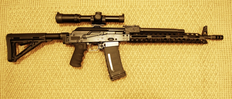

Update to my earlier post in the pics thread... Almost done with full AK-74/AK-101 conversion. Got the HG retainer and both blocks installed. Now they just need to be aligned and pinned. Then, to paint the rifle, and see if I can fill in that retarded scrubbed importer mark while I'm at it.

Nice job. Are those bulgarian FSB and Gas block? Were you able to use the original "extended" pin hole to align the gas block? Was your barrel notched for the locking lever on the HG retainer?

Yes they're Bulgarian parts. The gas block matched the factory pin channel but is drilled slightly crooked (off by less than 1mm!) so I'll need to either drill it out or use a 3mm round file to get a pin in there, then drill the other.
I somehow got the FSB on perfectly straight on the first try, but it still moves so I'm going to test it on paper first.
Barrel was not notched for HG retainer, but did have the positioning cuts on both sides. I did the measurements to position the notch using a plum HG (plum HG is shorter than wood, but wood can be fitted), scored the barrel, and used a round file that matched the profile of the latching cut on my WASR. Eventually I was able to get the retainer in place and the lever rotating tightly. Both wood and plum HG pieces fit very snug.
Man... Having a huge set of small files is key to doing this stuff by hand. If I didn't have them I'd be screwed. It's amazing how well these 30 year old Bulgarian parts fit on a brand-new Russian rifle. It is a tight rifle.

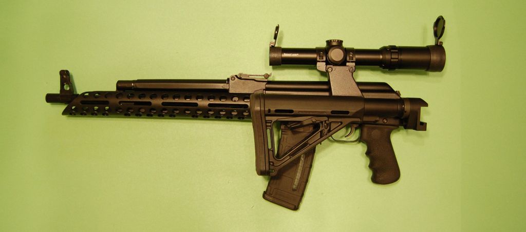

Another update to earlier post (due to inability of editing an original post).
Primary Arms 1-4x red dot on modified VOMZ side mount.

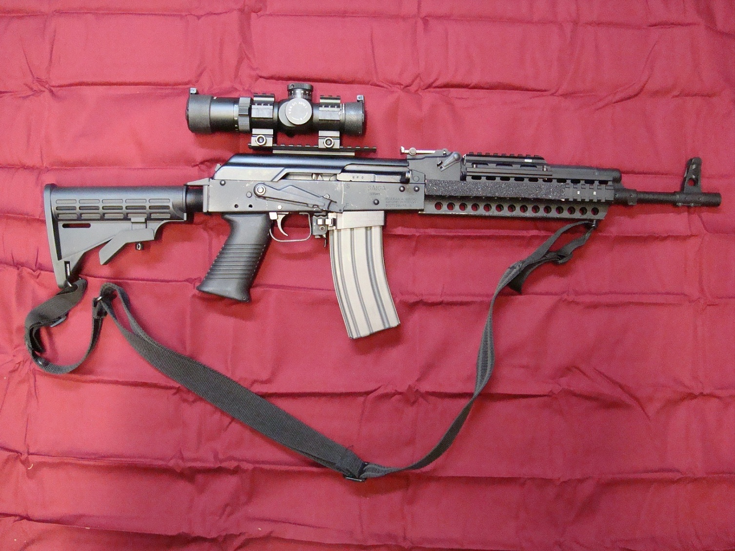

I'm just about finished. Fun project, I need to get a .308 next. :) Below is what I've done to it.
MSA ar mag adapter, modified UTG handguard, Tapco double hook trigger, Vector 1-6x28mm F.F.P. scope
windage and elevation adjustable scope mount,Saw grip , and a typical M4 stock. The rifle feels
great and I'm looking forward to getting out to shoot it.

Rivet holes filled & entire rifle painted. Obliterated import mark also filled.

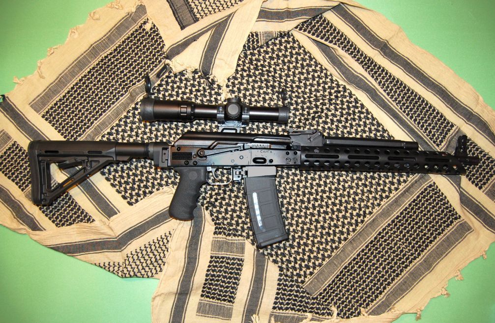

Just to keep the momentum going (my AKAR: more mods ahead, but nothing "fundamental").

Pyzik, you caused me to buy a Beryl folder. It's really comfortable. Only PITA was finding/modding the metric screws.
<snip>
Glad I cold help ;). Yes, the screws were a pain for me too. I couldn't find a 6mm so I had to file down an 8mm.

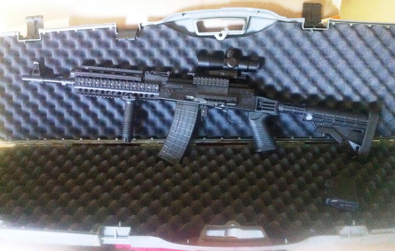

I know I have posted this rifle in the thread somewhere but I have done a few things since then (still no where close to being done though)...
I hate you both. Those are sexy as hell!!! As soon as I can afford one im getting one for my sbr. Very nice guys
