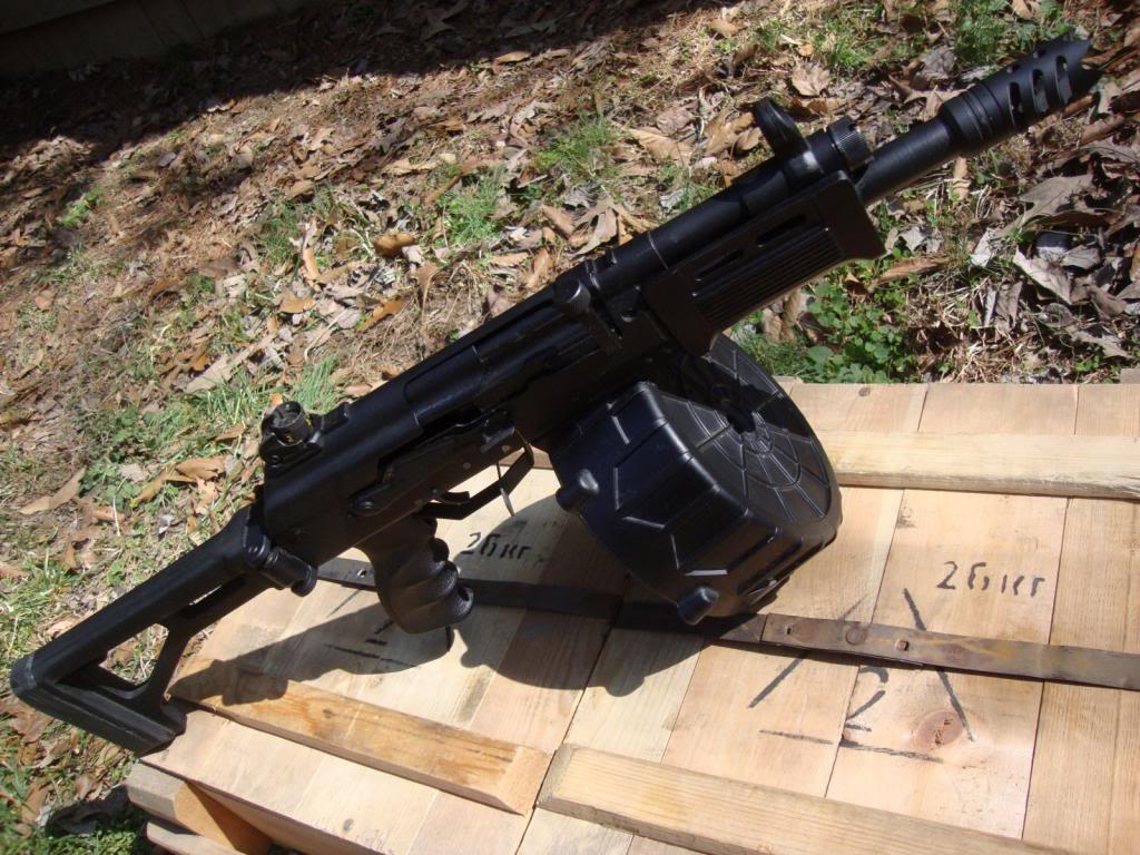

Eric Pate 478 Posted July 15, 2016 Report Share Posted July 15, 2016 Hey guys. Took a much needed break from the Forum for a little while. Been almost two years since I logged in. I see that its pretty much the same guys hanging out, some with a few thousand more posts, lol. And sure enough, a thread on double stack mags first thing. Anyways, I just stopped by to show you guys the makeover I had done to my S17. I know yall appreciate this sort of thing and what with the flood of aftermarket bolt-on upgrades in recent years, I know I like seeing something original and well executed. This is what it looked like before. Pretty much a standard Tromix S-17. The funky triggerguard and inability to use standard AK grips has gradually become... distracting to me. Nothing against Tony, he does amazing work and this has been one of the most reliable weapons I've owned; not a common trait in mag-fed gas-operated 8" shotguns! I had some inspiration for a much sleeker minimalist build from parts I collected at Knob Creek, so I collaborated with Leland at Sierra Ordnance Co. to adapt a VZ-58 folding stock and AMD-65 handguards. He also replaced the triggerguard with the standard AK-type and removed the Tromix-style PG post and nut with the standard AK T-nut. Didn't really require too much fitting work actually. Refinished with cerakote over park. It gained just a little bit of weight over the plastic stock and handguards.feelsgoodmang.gif LOP is 13.5" and folded OAL is 18.5". I could almost holster this thing. 12 Quote Link to post Share on other sites

Eric Pate 478 Posted July 15, 2016 Author Report Share Posted July 15, 2016 Doing well thanks. Went through a lot of life changes in the past couple of years. Took me a bit to get back on my feet. Now I'm playing with guns again and having a great time. Thanks for the kind words guys. And yes... shooting it is not for the faint of heart. 2 Quote Link to post Share on other sites

saltydecimator 482 Posted July 18, 2016 Report Share Posted July 18, 2016 Looks good! Any note specifics on how the stock and handguard mount up? Quote Link to post Share on other sites
Eric Pate 478 Posted July 19, 2016 Author Report Share Posted July 19, 2016 Stock was modded by welding up the huge VZ-58 stock screw hole and drilling it to ACE hole pattern. Handguard just needed the edges trimmed to fit around the gas block then a hole drilled for the HG screw. He may have relieved the inside a bit, haven't checked. He did clean up the front for aesthetics, though not strictly necessary. Quote Link to post Share on other sites

Eric Pate 478 Posted July 23, 2016 Author Report Share Posted July 23, 2016 Birdshot and target loads are still as tame as ever. Buckshot and slugs are a bit of a wild ride though. Not too bad as long as you don't go for a tight cheekweld. The steel buttplate doesn't particularly bother me. I made it through a box of shells before the handguard started to warm up. I will be metering this combo today so it should be interesting to see some actual dB reduction numbers on the old CGW Mitigator. Believe it or not, I actually got this thing to run the Federal Subsonic shotshells by turning the gas up to 3 and dropping in a reduced power recoil spring. Weak ejection but functions 100% from the shoulder. I was able to induce some ejection failures by firing one handed and limpwristed. Still runs the bulk pack target loads in this configuration without excessive recoil. winninngg.jpg 2 Quote Link to post Share on other sites
