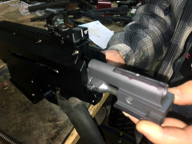

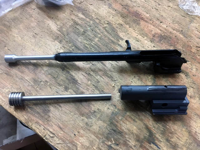

Doug Hartley 526 Posted November 14, 2016 Report Share Posted November 14, 2016 I've shown some pictures here before but I got a chance to handle the gun on Veteran's Day and pick up some specific info. Attached are some photos of the new gun. It operates similar to a Saiga 12, a gas piston driven gun, but the piston and bolt carrier are seperate. The short stroke piston pushes against the upper part of the bolt carrier. The bolt slides into the rear of the receiver and the buttstock adapter locks the rear of the receiver. This prototype gun is heavier than the production gun will be, with the receiver wall thickness being reduced in some areas and the rail being lower. I should have video of the gun shooting in a week or 2. Feel free to ask questions. Doug 7 Quote Link to post Share on other sites
DLT 1,647 Posted November 14, 2016 Report Share Posted November 14, 2016 Very interesting design. I see a bit of S12, Sig, and AR design all wrapped up in one package. Very well done. 2 Quote Link to post Share on other sites
evlblkwpnz 3,419 Posted November 14, 2016 Report Share Posted November 14, 2016 The machining looks great. Can't wait to see this in action. I can't help but wonder how many hours you guys have in developing that. 3 Quote Link to post Share on other sites

Doug Hartley 526 Posted December 9, 2016 Author Report Share Posted December 9, 2016 Prototype runs like a champ, here is an image of some minor changes made to save weight. Hoping to be able to have finished guns available by February. Doug 2 Quote Link to post Share on other sites
