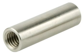

Heartbreaker 1,085 Posted May 22, 2017 Report Share Posted May 22, 2017 Here is a suggestion. If you know the thread pattern, you could get what's known as a threaded sleeve or bushing. Then cut a piece about 1/4" long and use a Dremel to cut a slot across one end for a screwdriver. You could also make it longer than the factory nut so it completely covers the bolt therefore letting you use a standard flat head screwdriver to tighten it. 1 Quote Link to post Share on other sites
JDeko 792 Posted May 22, 2017 Author Report Share Posted May 22, 2017 (edited) I don't know the thread pattern for sure. Your idea sounds easier than the nut one. From the Vepr 12 magwell installation thread I get the impression that it might be a weird threading since the person there said they couldn't find a bolt that fit their nut. I'm on my phone so I can't copy-paste the quote from that thread. Edited May 22, 2017 by JDeko Quote Link to post Share on other sites
JDeko 792 Posted May 22, 2017 Author Report Share Posted May 22, 2017 On the bright side I do know the size of the LRBHO bolt so I could do that for that bolt and make it look pretty close to factory just with a silver tube instead of black Quote Link to post Share on other sites
