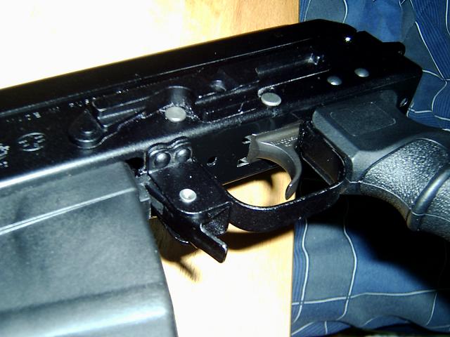

Here is my Christmas present:
Tapco G2 FCG - $26.00
Tapco T6 Stock - $37.00
CAA Ergo PG - $20.00
All from On Point Firearms.

I thought I would add this one too... Its not a Saiga... its my WASR10... but its been dressed up a little bit... I just swapped out lower handguards a few minutes ago... I didnt think that the lower would match up with the upper, but I took some of my wood refinishing oil out, and some steel wool, and buffed it up a little bit... I think it matches the upper handguard pretty well after all, and if I bothered to take the time to strip the thumbhole, and rework that, I think I could get the whole set to look pretty sweet!
I also like the tantal style brake... Its sort of a hodgepodge rifle, but then again... all my rifles tend to be... but hey... they are CUSTOM... and mine... and I like em that way!! :up:

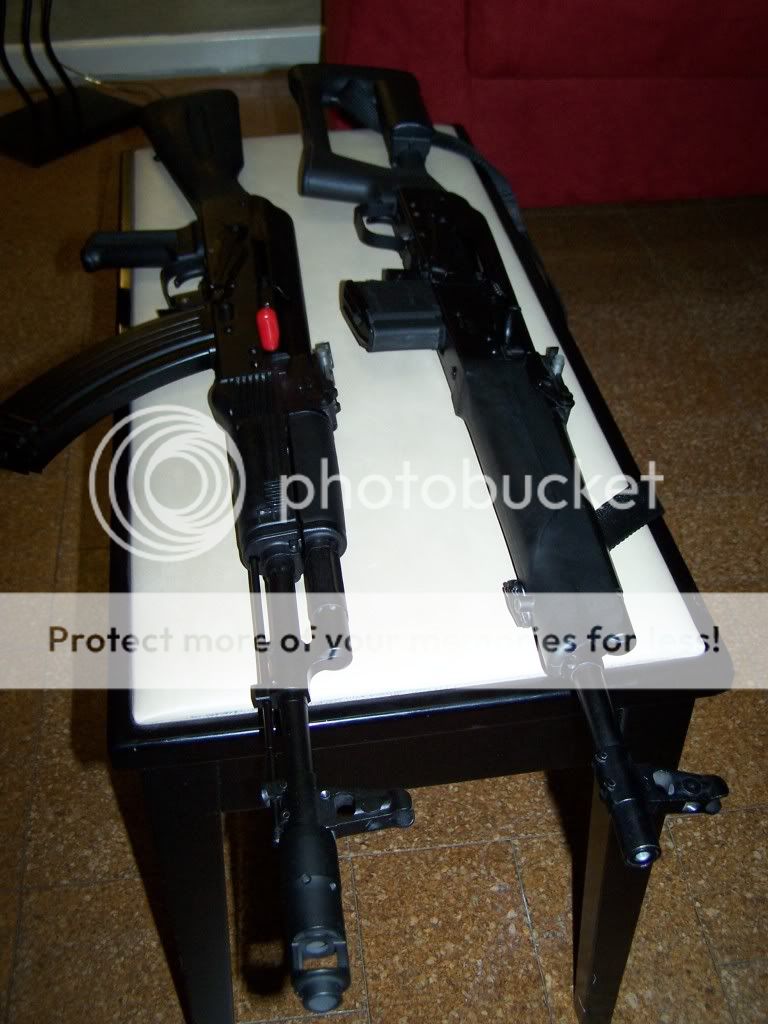

Here mine, got it used for $175 off a friend who only fired 20 rounds through it. Today I got all these accessories, I hadn't realized how many things were available for these. I know the 30 round mags weren't around last year.

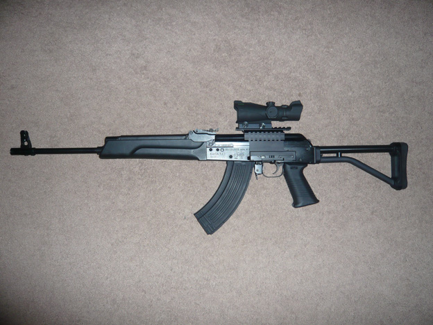

Just finished. That sidefolder is a bi-yatch!

Jeez, you went all out on that! You even got a receiver with dimples!
That looks like one the modern AK-1xx series. Nice job!

Thanks guys. The dimples and X-Y stamps on the Saiga were my inspiration. I knew this one had to be special so I decided to go all out and build it up as an AK-103.
-Global Trades 24mm Muzzle Brake
-Bulgarian AK-74 FSB, GB, Lower HG Retainer and Gas Tube. The Saiga 7.62x39 barrel has the same dimensions as a Bulgy AK-74 apparently.
-Used a "keyhole cutter" to mill out grooves in the side of the barrel for the lower handguard retainer.
-US black handguards and pistol grip.
-Russian late model 1000m rear sight leaf.
-Arsenal USA Match Gas Piston
-Bulgarian riveted bullet guide. The one from K-VAR is for milled guns so some cutting was required. Had to mill out a groove in the floor of the rear trunnion to make this fit.
-When I pulled the barrel to fit the bullet guide I had to replace the "3rd rivet".
-Installed a Bulgarian AK-74 trigger guard but used the original Saiga release tab so it would look factory. Also filed side of base to match profile of the factory selector stop.
-Arsenal USA trigger and disconnector, saved the Saiga hammer because of the peculiar fit of the bolt locking device.
-Spot welded a pistol grip reinforcing plate on.
-Russian AK-100 series sidefolder. It's really silly that these Russian ones can be had for less than the US-made ones K-VAR is selling.
My only regret is not having the welding skills to cover the old holes in the receiver. Maybe I'll take a class. :)

Great work man. Just get some of those nylon hole plugs from Lowes or the hardware store. They pop right in and look just like rivets. Damn I wonder how many timers I've said that...

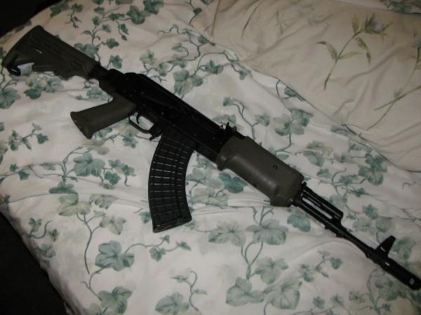

Tapco G2 FCG, Arsenal USA Gas piston, Promag 30 round polymer mag, US nato length stock, Tapco PG, Bulgarian handguards, retainer and mag latch, Bushnell trophy red dot. Desperately needs a flash hider and folding stock to complete the AK-103 look.
And this is my buddies, 50 round US mag, Arsenal USA Piston, Tapco galil grip.

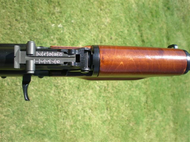

Ugh, this motherfu**er is finally done. Never again will I try another handguard conversion.
G2 FCG
US AK-74 Brake perm. attached
Pro-Mag 30rnd Magazine
Vented Gas Block with Bayo Lug
SA-85 Blonde Wood
Special thanks to Vjor for some great tips/advice, Dinzag and K-var.com for parts, WJM for the barrel threading kit, and Cobra for the offer to help which I so naively declined.

My Post Deployment Present to myself!
Blackhawk! Combat Medical Bag
Century Arms Romarm GP WASR 10
TDI Arms Forend
Ultimak Gas tube
Tapco T6 Stock
now im going to Tromix out my Saiga!

FINALLY GOT MY NEW SAIGA VERY HAPPY WITH IT
Pretty gun. I love the skeleton stock! Looks great!!!
Is it 922r compliant?

ya i bought it from a dealer in md brand new like this
AWESOME!!! So the rumored Saiga 30rnd magazines are officially in the US?

ya know i bought my saiga from a dealer too, welded mags with no US parts at all......completely in 922r violation
